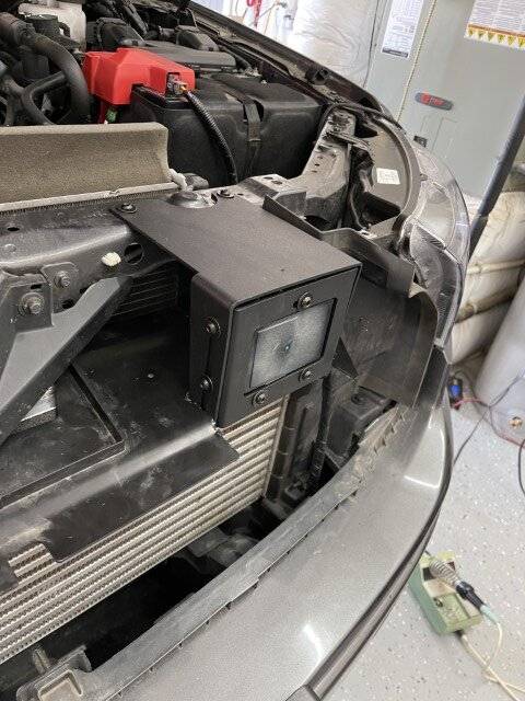

Here is what the mount looked like before the grill was installed.
The aftermarket radar mount was $40, compared to $280 for the factory Ford mount. Also it allows you to use a light bar in that space. The only downside is you have to extend the 4 wires to the radar unit.
Dave, double check that you don't have the ACC sensor mounted upside down.
I think mine is 2 holes on top - one hole on the bottom.
(I have the same bracket)
Service documentation for aiming the sensor shows 2 holes on top - I'm not sure if this is even an issue but it's worth pointing out in case you have difficulties with it once everything is wired and programmed.

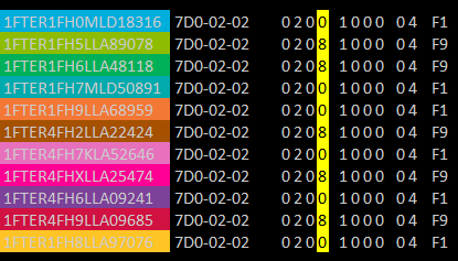

Your exact numbers might be a little different but the numbers/letters in bold are the ones to change. As stated above, I made NO changes to the the APIM.
I have attached my spreadsheet.
I'll push my Ford Performance tune back in tomorrow and see if everything still plays nicely together.
I volunteer at the local ambulance corp so I'm on duty tonight and can't mess with the truck since I need to respond :)
Yes my APIM settings were wrong... All NAV.
Thanks for that, I haven't road tested it yet but it passed the diag test and has no errors. and yes now I see it is indeed upside down. Quick fix.

Some comments - both the BCM and the SCCM can be set via easy mode.
Interesting, my APIM 7D0-02-02 already has xxx8 xxxx xxxx (TC and TM related?). But I will follow your lead and leave the other 2 unchanged.

All of the 7D0-02-02 in my research have both NAV and ACC with a value of 8, so pretty sure it's NAV.

Does anyone have a guess as to what the suggested APIM coding is for? I don't have anything changed right now in the APIM so not sure if it needed it or not.
We should start a new thread for that, I have the start of a spreadsheet and more than happy to share my list of vehicle VINS, complete with window sticker so you can see what options they have. I use 'as-built hacker' as a comparison tool.
The odd thing is I don't have Nav.
All of these with 8 have NAV (but also have ACC), I turned a few of these on as 5G Dan-O did and it turns on the NAV button on the screen. So I quit messing with the APIM. So very Weird!
