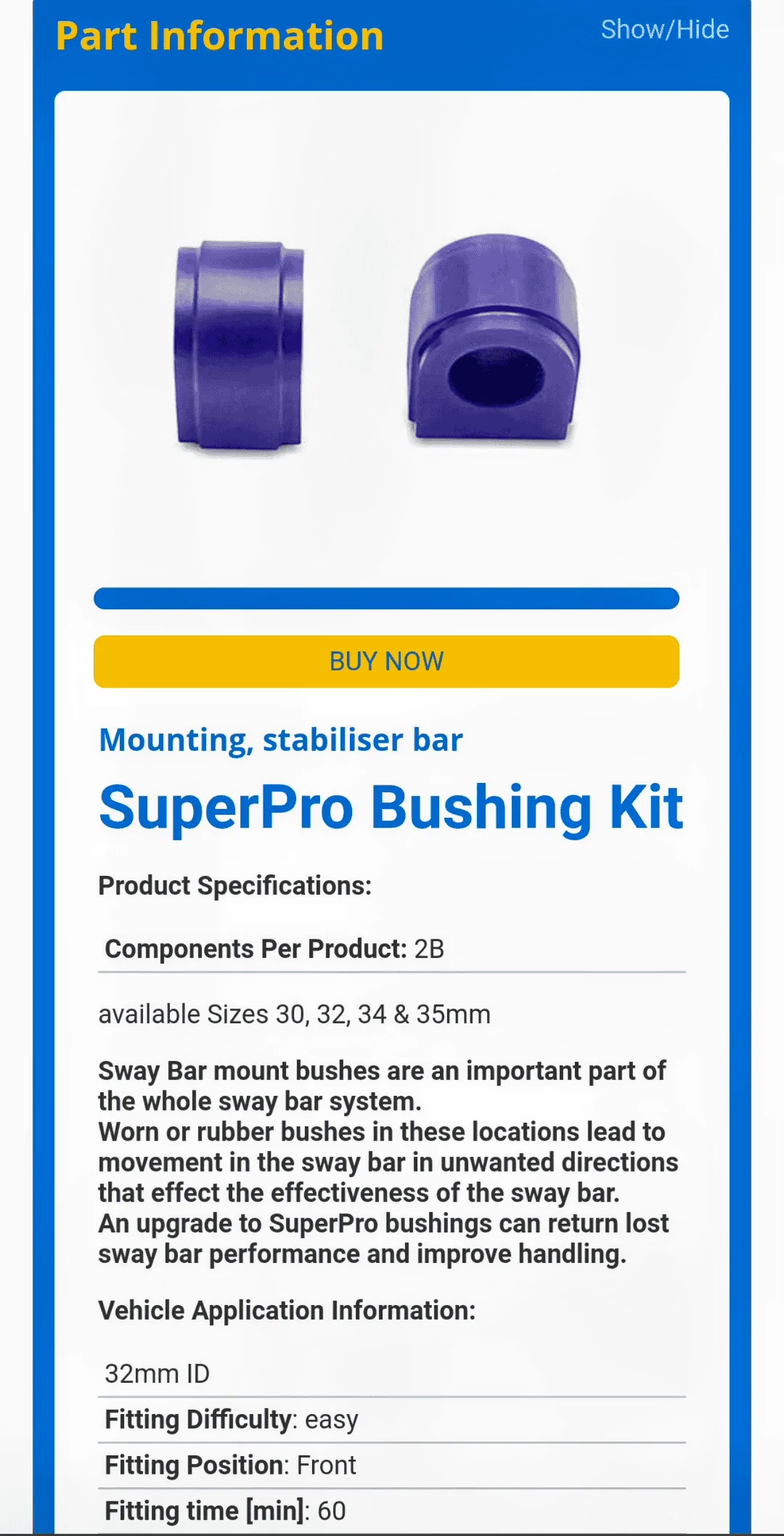

Resurrecting this because I still want to find a poly swaybar-to-chassis replacement. Phil had measured his and it was something like 27mm (Edit: ADDCO says 27.5mm) but universal replacement bushings with their clamps were still smaller than stock and the bolt holes not even close.
I was on the SuperPro Australia site looking at 2WD Ranger 2018-2022 replacement bushings and they look like they'll fit in the factory clamp but they start at 30mm. I notice rear bars are also down under. I'm guessing the rear bar mandates a front one but I wanted something subtle in performance.
