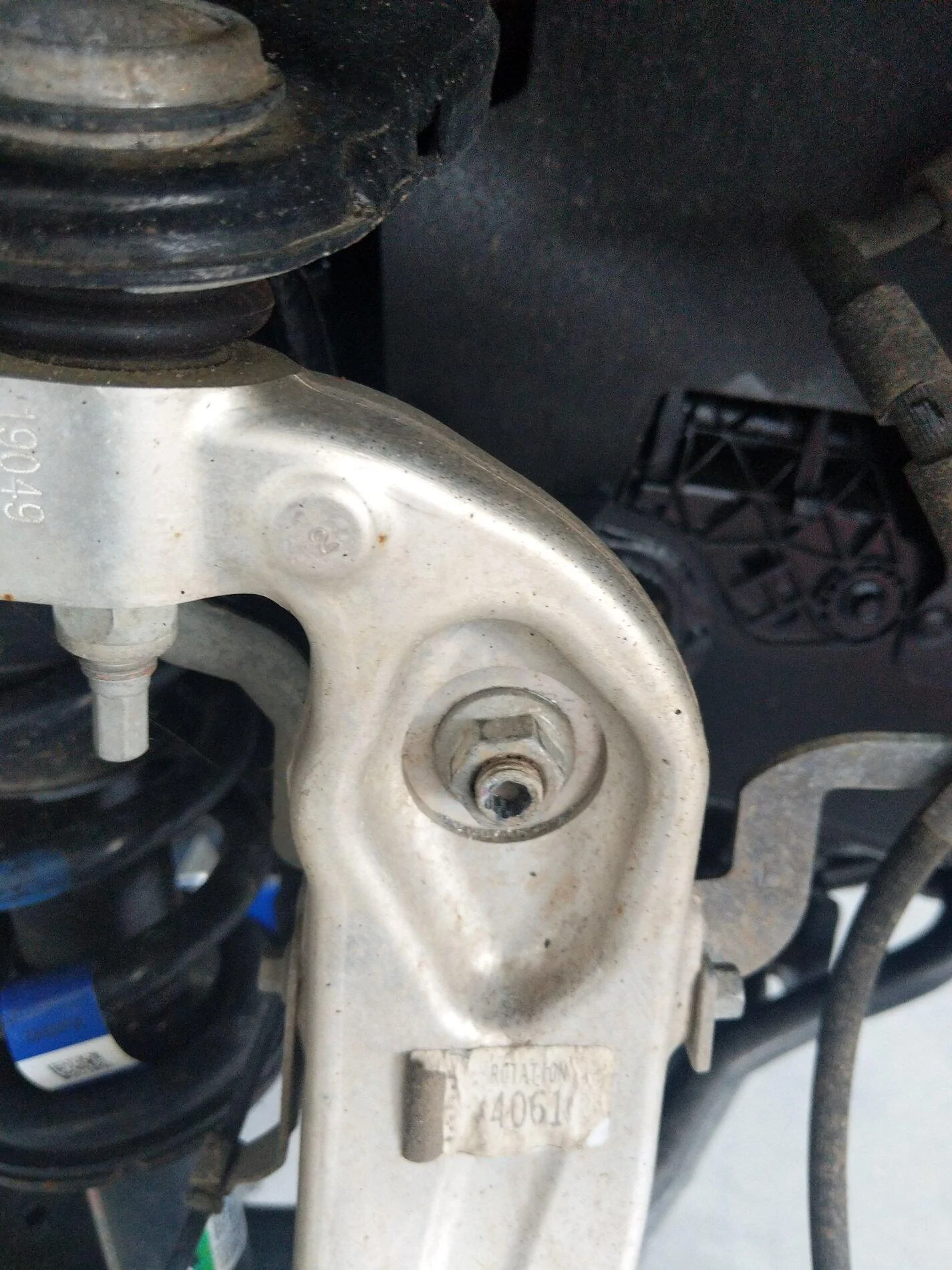

Hey all, I'm working on installing a levelling kit and I'm stuck at step 1. How do I get this nut off? This is the linkage to the swaybar. I got a breaker bar on it and it just spins the whole nut with the set screw in the middle... then I tried to get either pull out or send through the hex headed thread in the middle... but that started to strip, so I decided to call it quits before I got any further. Surely I'm doing something wrong here. Edit - Impact also just spins and spins.

Hold the hex unscrew the nut.

Hi Av8or
Look at the center if the stud...It is a hex or a Torx. You need to engage the center before attempting the loosen the nut.

Any tool recommendations? Not exactly much room for a combination wrench to get in there since it's in a recess.

You should be using a proper boxend wrench.

Offset boxend.

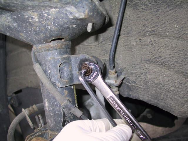

NOT a ranger but the same idea applies
Box end wrench on the nut, allen key on the inner bolt. I've swapped my front suspension 2x now, and am finally getting pretty good at the process. ?
