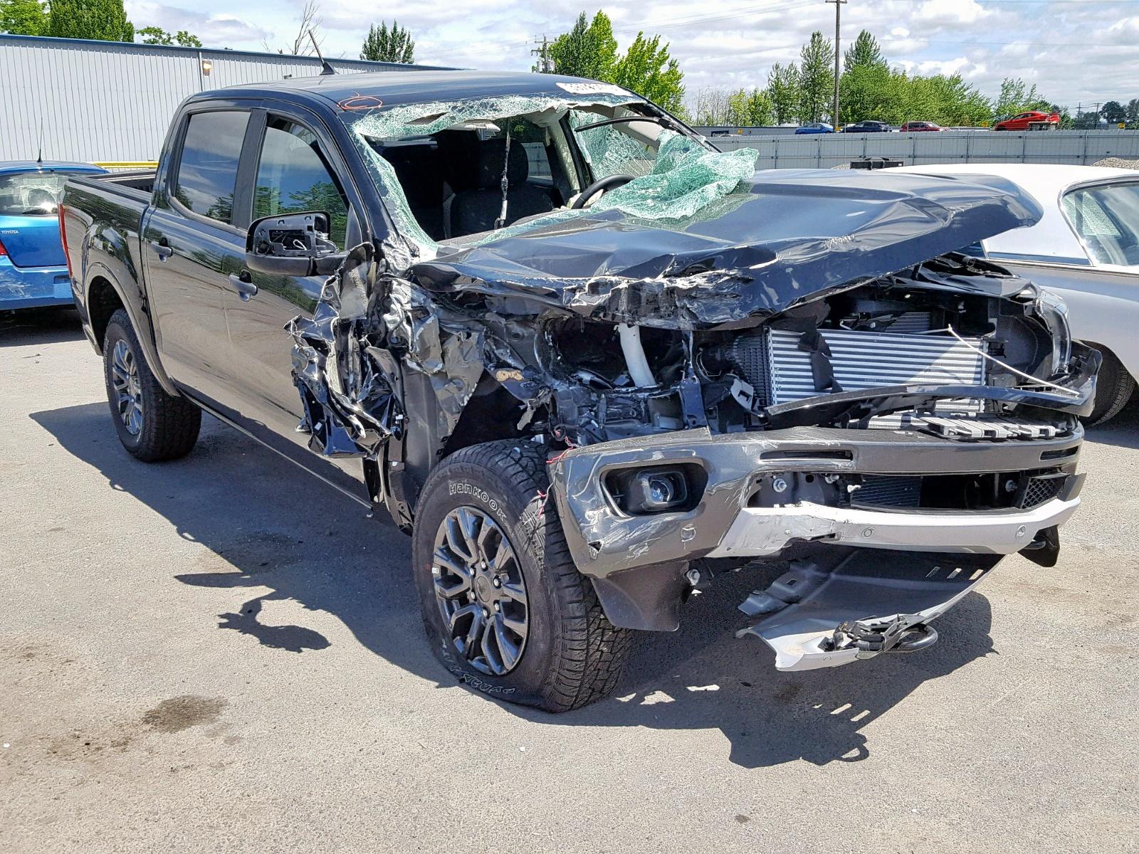

you gotta have bigger balls
wait until the AEB takes over....and hope you stop.
Ford throws the caveat in there
