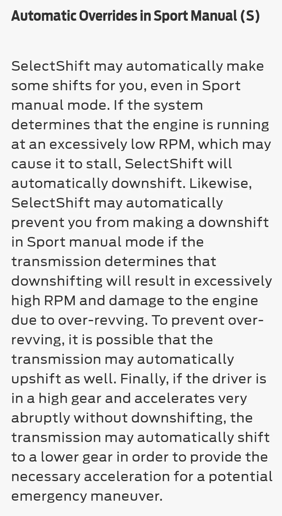

I just read the ford literature. Very interesting. It reads like it will "maybe" shift it if thinks it needs to.

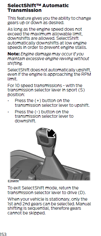

Looks like you can bounce off the rev limiter all day and it wont shift when in the selectshift mode.
The way I read it is: sport mode acts like sport mode, bump either the + or - and the truck enters manual mode and it will no longer shift. Then return to drive to leave manual mode (selectshift).

Others here can confirm as well (it has been reported a number of times) - if you put it into "Select Shift", it absolutely WON'T shift unless you shift it with the buttons.

Switch it to D then back to S ....

This is what I read. "To prevent over-revving, it is possible that the transmission may automatically upshift as well."
I like the ranger, and even considered getting one, but with my friends little rental experience I'd be hesitant to buy one. Yes he had no history of the previous 13k miles, but bouncing off the rev limiter in first gear for all of 2 seconds and then having a rod shoot through the block just doesn't sound very durable. The raptor sounds more enticing to me if it did go with the 2.7 ecoboost. I'm just cautious of the 2.3 unless someone can prove otherwise.
