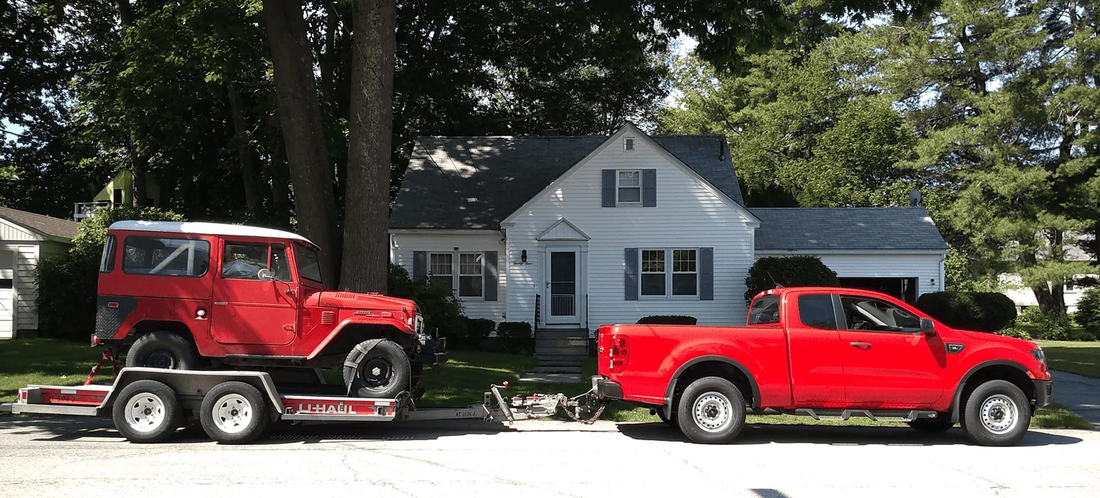

I said it before and it bares repeating, I was impressed by the ability of the Ranger to tow my 5,600 pound load. The U-Haul trailer doesn't really allow for the vehicle to be placed well, just right to the front. And this caused a tremendous amount of tongue weight. So much so that backing down a decent slope on a driveway, the Ranger's front wheels slid!
Despite that, the Ranger had tons of power, even at 55 mph (I sunk my foot in to see the response, but let up right away). And from a standing stop, no issues either.
You can see that I should have placed the ball mount two inches, or so, higher, but at this point it was too much tongue weight to get the trailer off the ball (I tried, but the built in jack couldn't do it).
Of course, the U-Haul has surge brakes and I'd never want to tow more than a tiny utility without brakes, but I also wouldn't panic regarding the Ranger's stopping power in an emergency (sure, the trailer might pass you, but the Ranger feels solid).
Safety first, even if I didn't exemplify that with tongue weight.
Edit: Decent amount of squat on this 2-wheel drive. It ain't leveled otherwise ...
