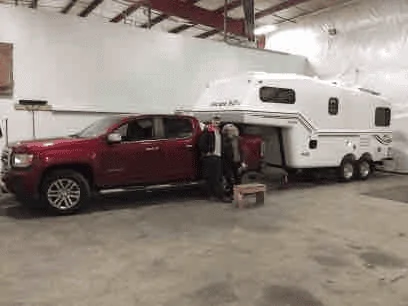

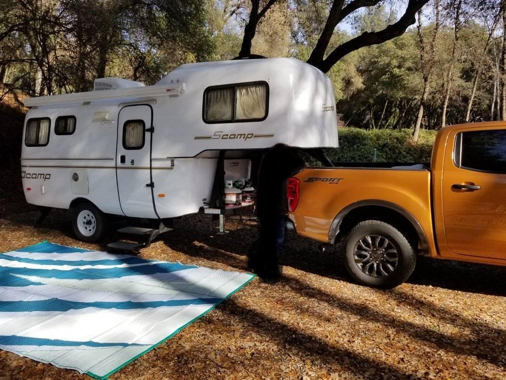

Here is a pic of the goose neck installed in a Ranger:
And another GM:

There are already people towing the Scamp with short box Rangers, Canyons, Tacomas.(see pics posted previously)

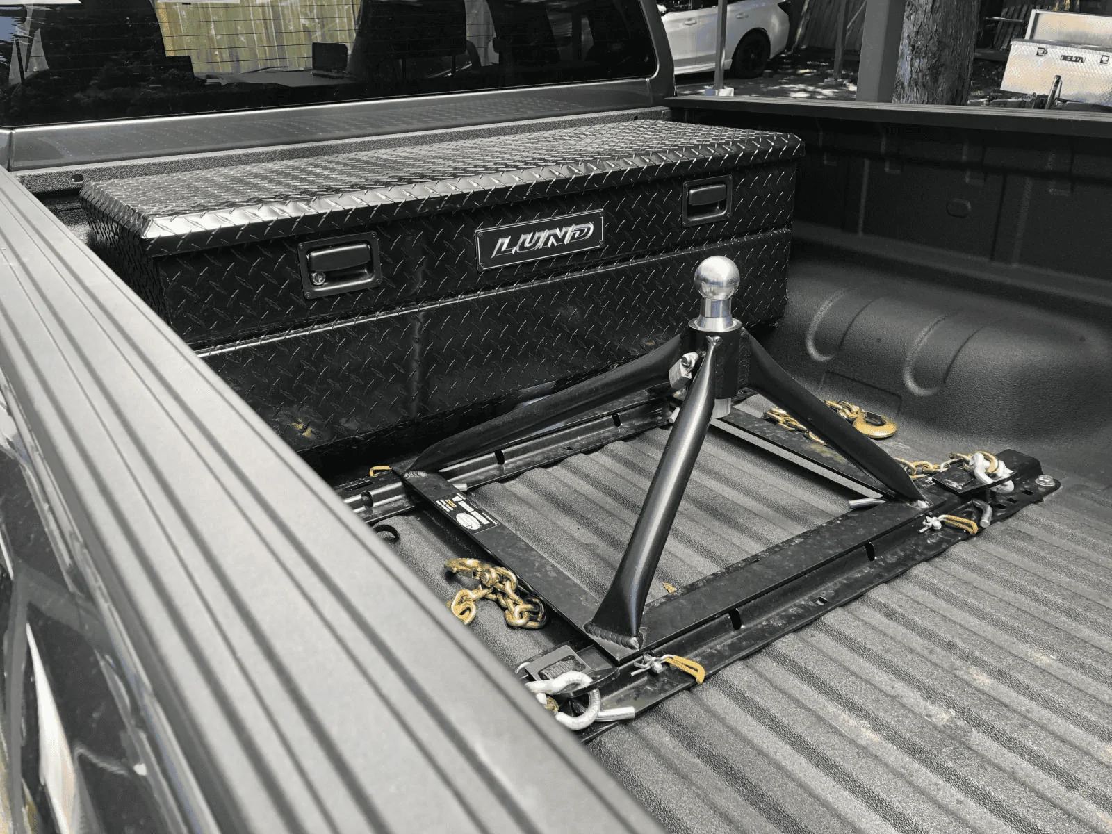

I want my rails to be frame mounted, not bed mounted. That seems to be the issue. No one makes a bolt on solution for the Ranger.
I’d rather not have to Frankenstein a solution.
Scamp provides and installs a hitch, but only bolted to the bed.
