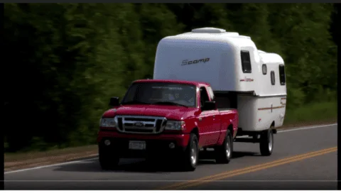

This is what we are planning to tow, looking for a similar set up.

The trailer is 3000lbs dry. Tongue is 300lbs.
The 2020 Ranger is more than capable. The trailer was designed to be pulled by an old school ranger.
here is the manufactures brochure pic:

I can't think of a reason why it wouldn't technically work for a small trailer, but everyone involved is probably terrified that some dipshit would be encouraged to tow a 15000 pound fifth wheel.

In Australia, there are no F-150 type trucks. They use the Ranger for everything.

I do agree with @VAMike a little bit on this. I do understand that the ranger may be able to pull a 5th wheel but when the truck isnt designed to do so from the factory it still becomes a question on a total capacity. With that being said I do understand that the scamp trailers are pretty light in general.
Also the ranger in Australia has a higher towing capacity for some reason.

@WpgLariat I don't know what everyone is goin on about. 2019 ranger is by far capable of what you mentioned. If it can handle 7500 lbs off a trailer hitch then it can handle 7500 lbs of a properly mounted gooseneck.
The real issue is I don't think anyone makes a kit, at least from what ive found. You may have to go full custom

Agreed!
the Ranger is more capable than the Tacoma or Colorado (gas) and there are bolt on kits for them.
As far as capacity, it is no different than someone installing a 5th wheel in an F150 (which is perfectly fine) and trying to pull 30,000lbs. People can be dumb regardless of vehicle.
I would just prefer a professional solution.
They do make generic 5th wheel rails, I would prefer a bolt on solution like Reese makes in Australia. They have quotes me $1800 to ship one to CA.

"5th wheel in an F150 (which is perfectly fine) and trying to pull 30,000lbs" .... Oh come on now, that might be a little bit a stretch. ?
I don't know the similarities in the AU frame and the US one. You may be floating in uncharted waters.
Make sure to post about it if you get it done! With pics!

Toyota doesn't recommend 5th wheel, GM is vague. The issue is that most 5th wheel trailers are well over the capacity of a mid size so the guidlines are written expecting that the 5th wheel trailer is 8k or 10k or more. (Manufacturers don't typically want to limit their market by moving off the bumper until they really have to--if you're selling a 3k pound trailer why ignore the SUV market?) Even if you're just approaching the weight limit, the weight of the 5th wheel hardware itself eats badly into the payload capacity of a midsize. Yes, there are some lightweight 5th wheel trailers, but they're an extremely niche product so there aren't many options or experience with them. You can probably find something that will work, but it won't be easy to find off the shelf solutions or people who have used them. As someone suggested above, talking to the scamp people themselves might be the best option because they probably have more experience with light 5th wheels than anyone else.

Hi Chris,
Since all the trailer tow testing was done off the receiver hitch or the rear bumper, the 5th wheel towing is in uncharted territory. That does not mean it won't work as it may be okay if the trailer GVW, Truck and Trailer GCW are with in limits of the owners manual Who ever starts to make a 5th wheel hitch for the North American Ranger will have to ensure it meets the robustness necessary to haul these 5th wheel trailers. If the 5th wheel device is attached to the frame, I would say it would be robust enough but if attached to the box floorpan...not sure I would want to tow this way. I am not all that familiar with the mid size 5th wheel trailers.
Not much help here...
