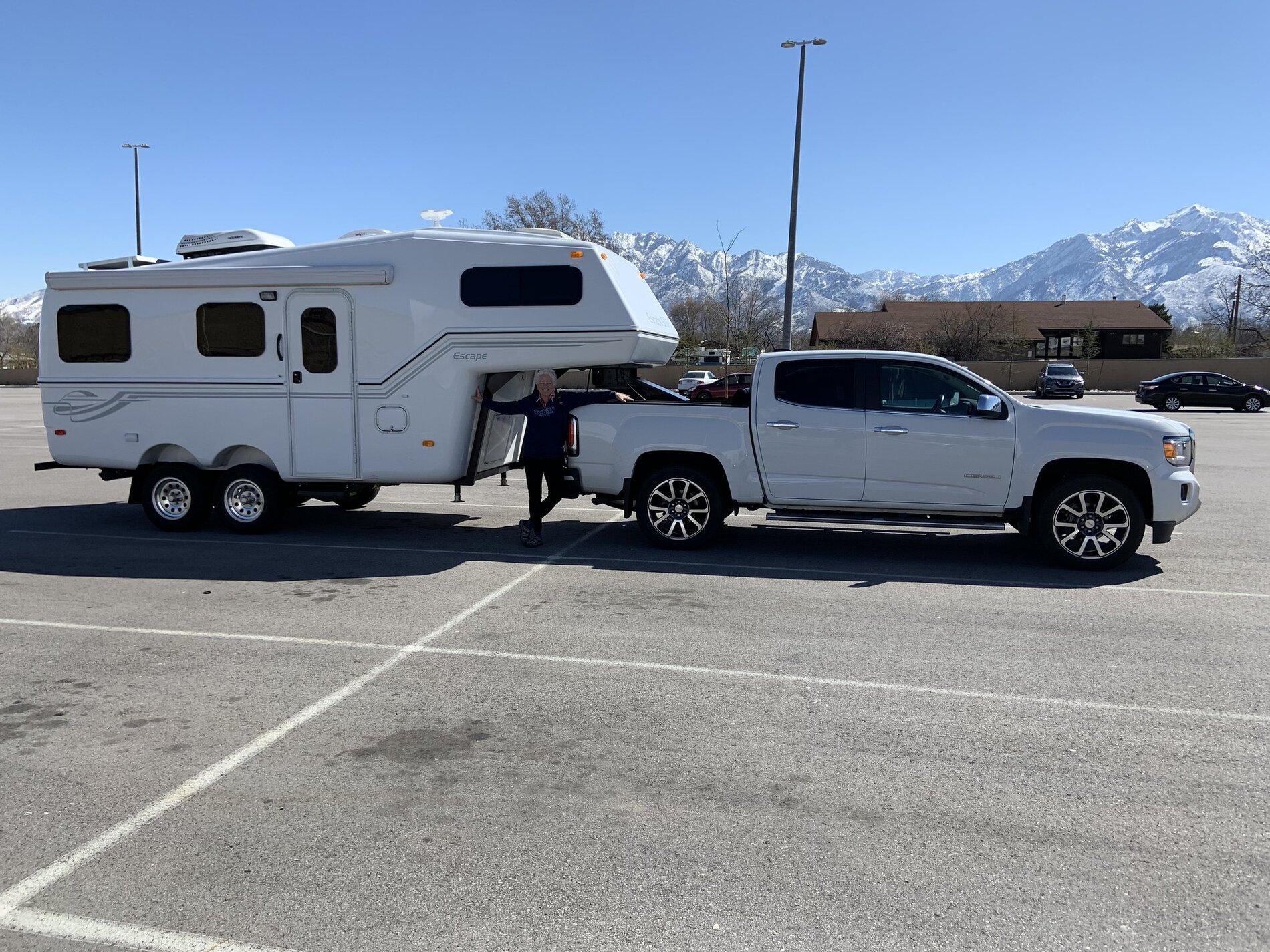

I currently have a 2020 Ranger Lariat Supercrew w/ 5’1” bed and tow package.
I want to tow a small travel trailer that used a gooseneck style hitch.
(scamp 19 deluxe or escape 5.0 trailers, 3000-4000 lbs)
I have scoured the net but cannot find any bed rail solutions, OEM specific parts or instructions.
What do you guys recommend?

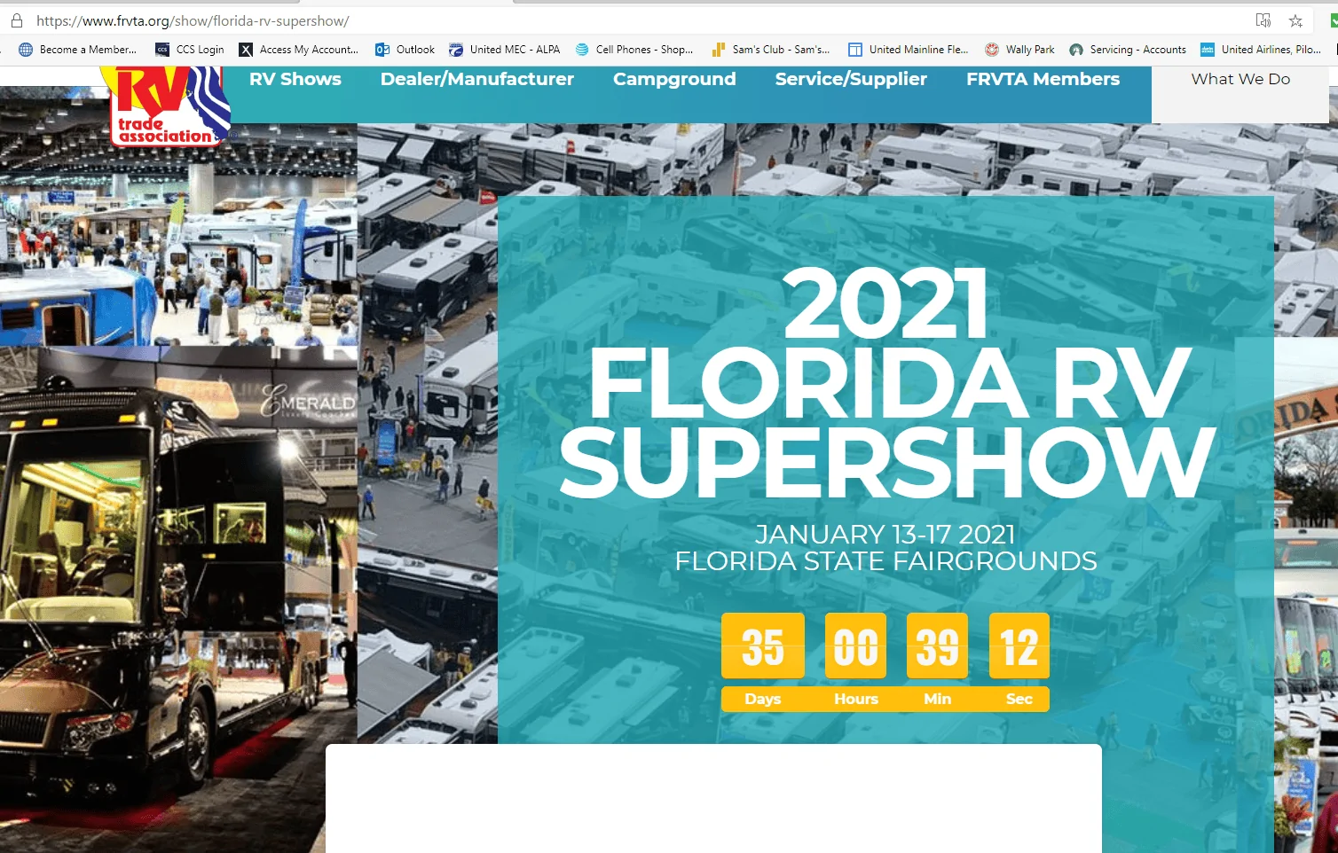

I see you're in Central Canada. Do what a bunch of your countrymen do and come to Florida this winter, and in addition to the beach and hockey games, hit up a couple of rv shows. Walk around and talk to all the small- size rv builders and see what's new. You might be surprised at your options and find some new ideas, plus you'll see a lot of the manufacturers of various hitches and aftermarket stuff. The boat shows and rv shows are fun and informative, but you got to go with some common sense. We also have gun shows and flea markets... something for everyone. sample below. That one is in Tampa.

I wouldn't call it "well within"...the glossy said that it's aimed a truck with at least 5.5 foot bed (ranger supercrew is 5, supercab is 6). On my supercab the axle is about 30 inches from the cab. Normal kingpin placement is 2 inches ahead of the axle, and the spec sheet says that would let you turn 51.2 degrees before you hit the cab (and that's the shortest kingpin distance listed). A supercrew would presumably be a foot tighter and basically force you to push the kingpin well behind the axle.
Payload on a 4x4 supercrew is about 1500. Subtract 900 pound pin weight at max for the escape, 100-150 pounds for the fifth wheel mount, and you're looking at as little as 450 pounds for passengers, stuff, mods, etc.
It could probably be done, but it's a lot tighter than the scamp, and probably much more comfortable on a full size truck.

The 5’1” box isn’t ideal but the Andersen ultimate hitch moves the pin back 6 inches. (Hitch recommended by Escape). The pin weight is 600lbs, not 900.
People pull the Escape with the Colorado as well.
