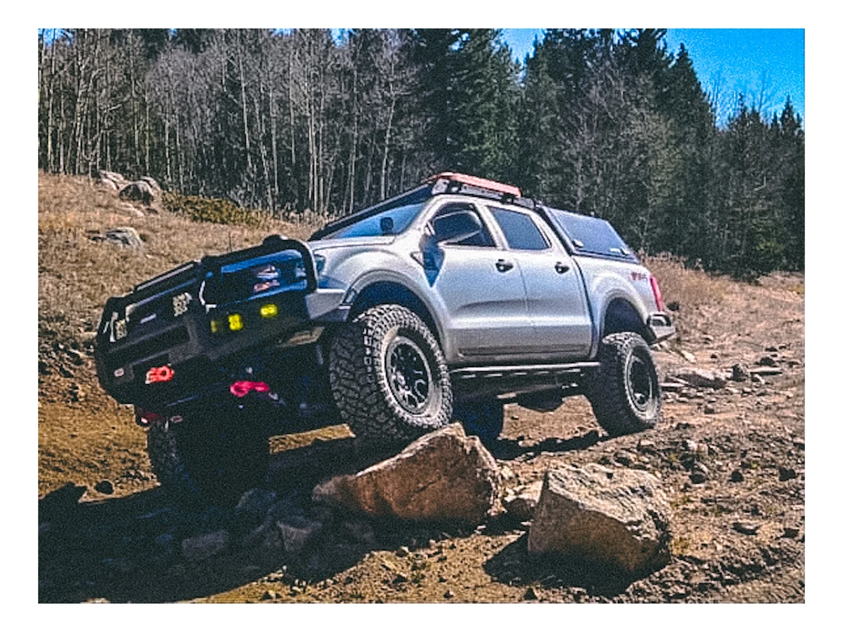

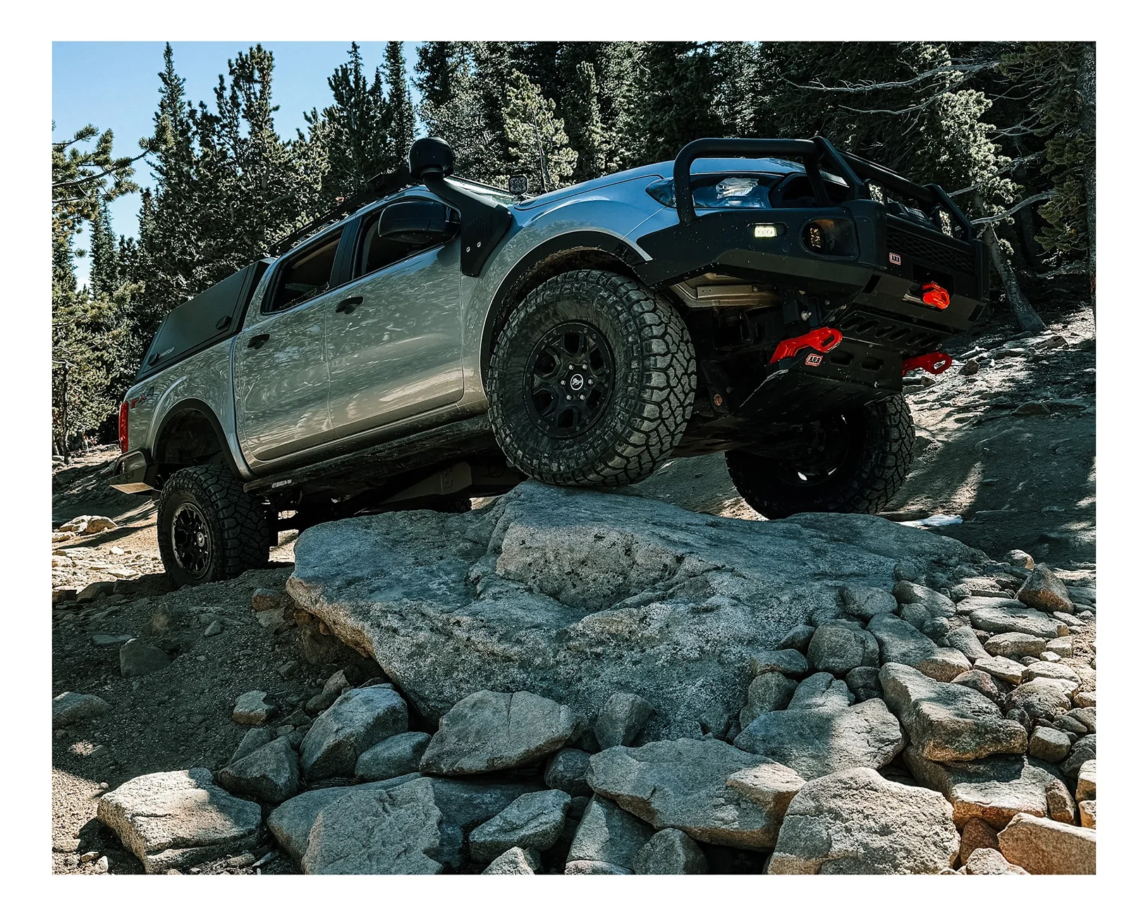

Finally upgraded to 35x12.5x17 Kenda Klever RTs. They're a fantastic tire, so far. 35s look so good on this truck.
What lift did you go with to fit 35s? I’m currently sitting on 33s with a 3.5” lift, 1.5” blocks in the rear. Also assuming the bumpers add some extra clearance.
I've got the ARB/OME BP-51 front with 1" strut spacers. I had to cut the bottom back corner of the fenders to clear. The trick is +30 wheels with 1" wheel spacers too (or 0 offset wheels). My crash bars have been modified extensively too (cut way back).

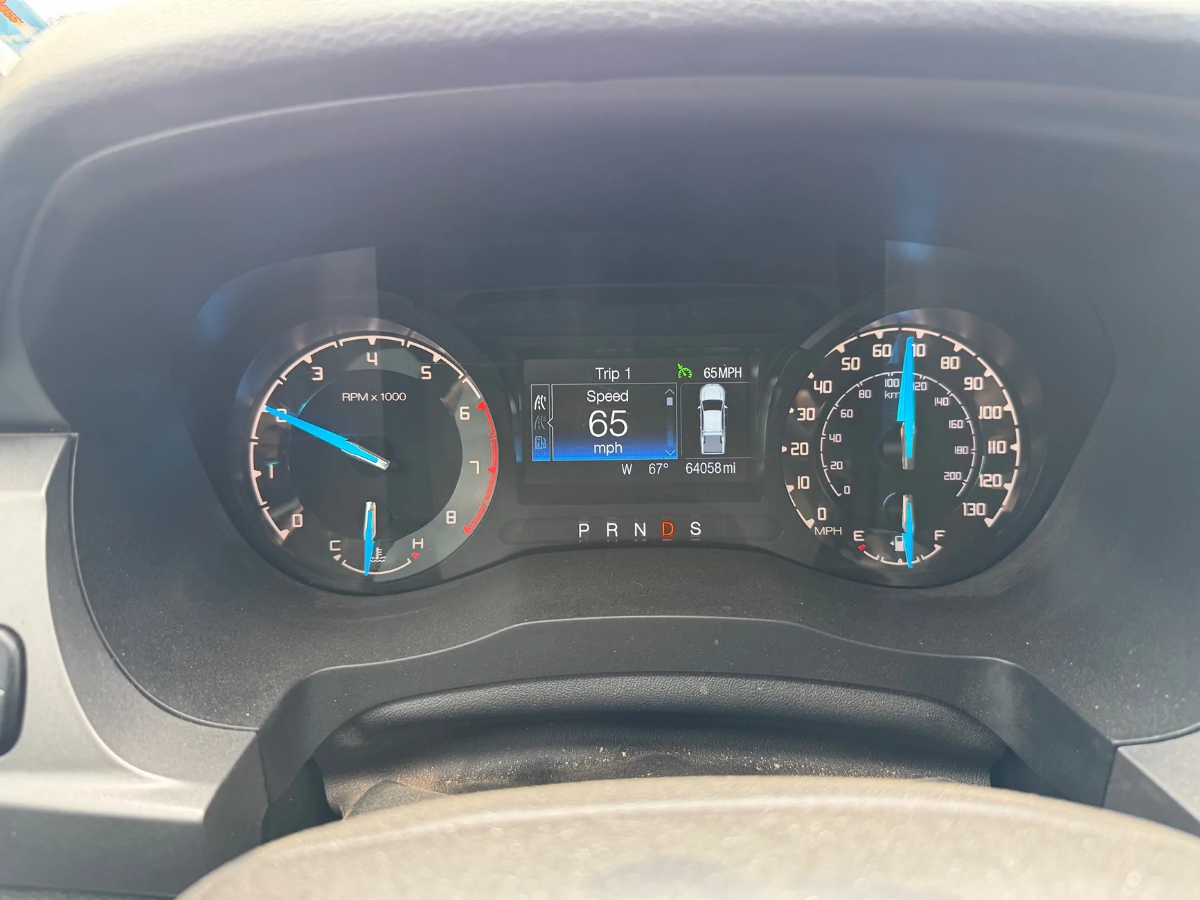

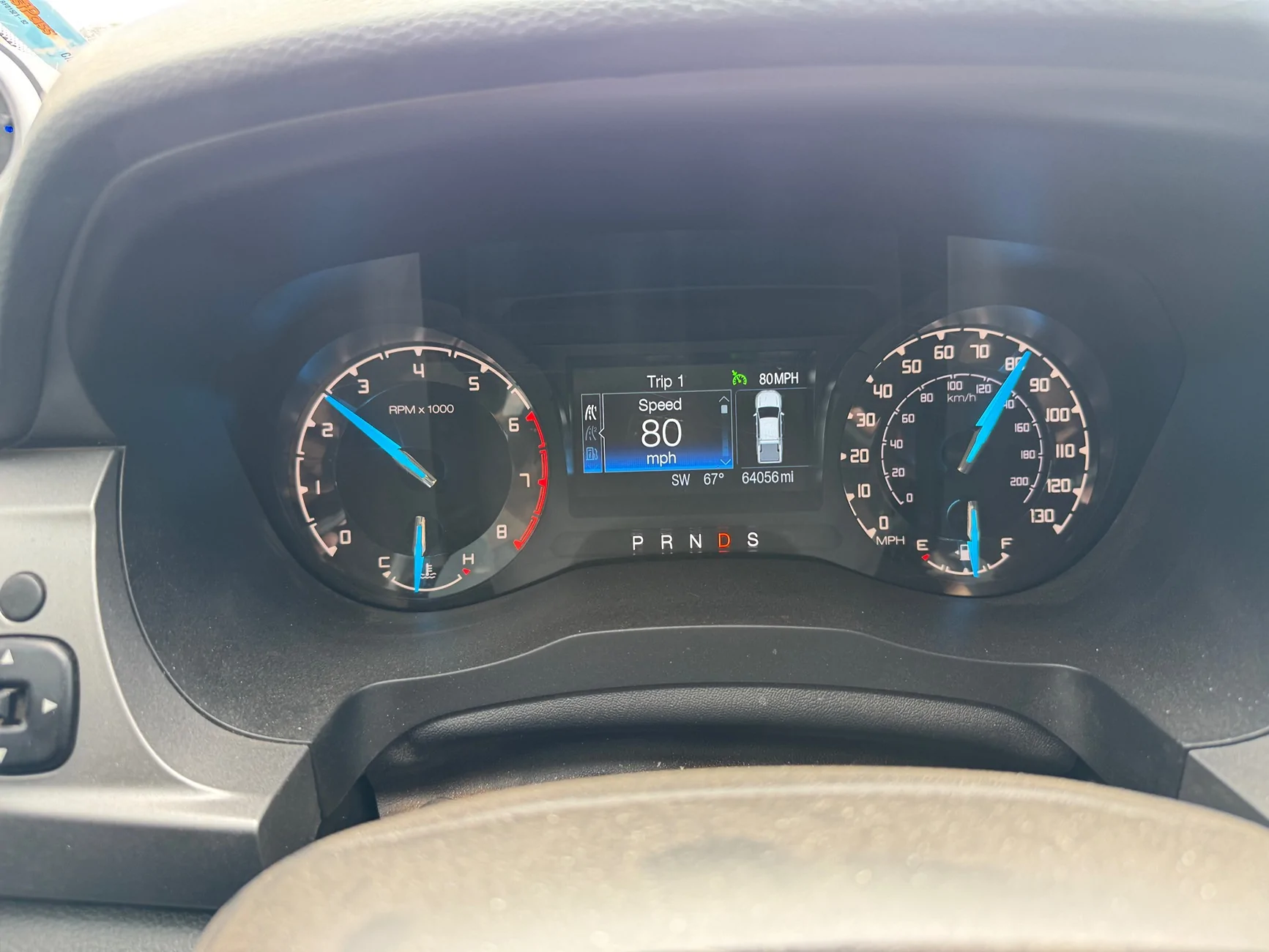

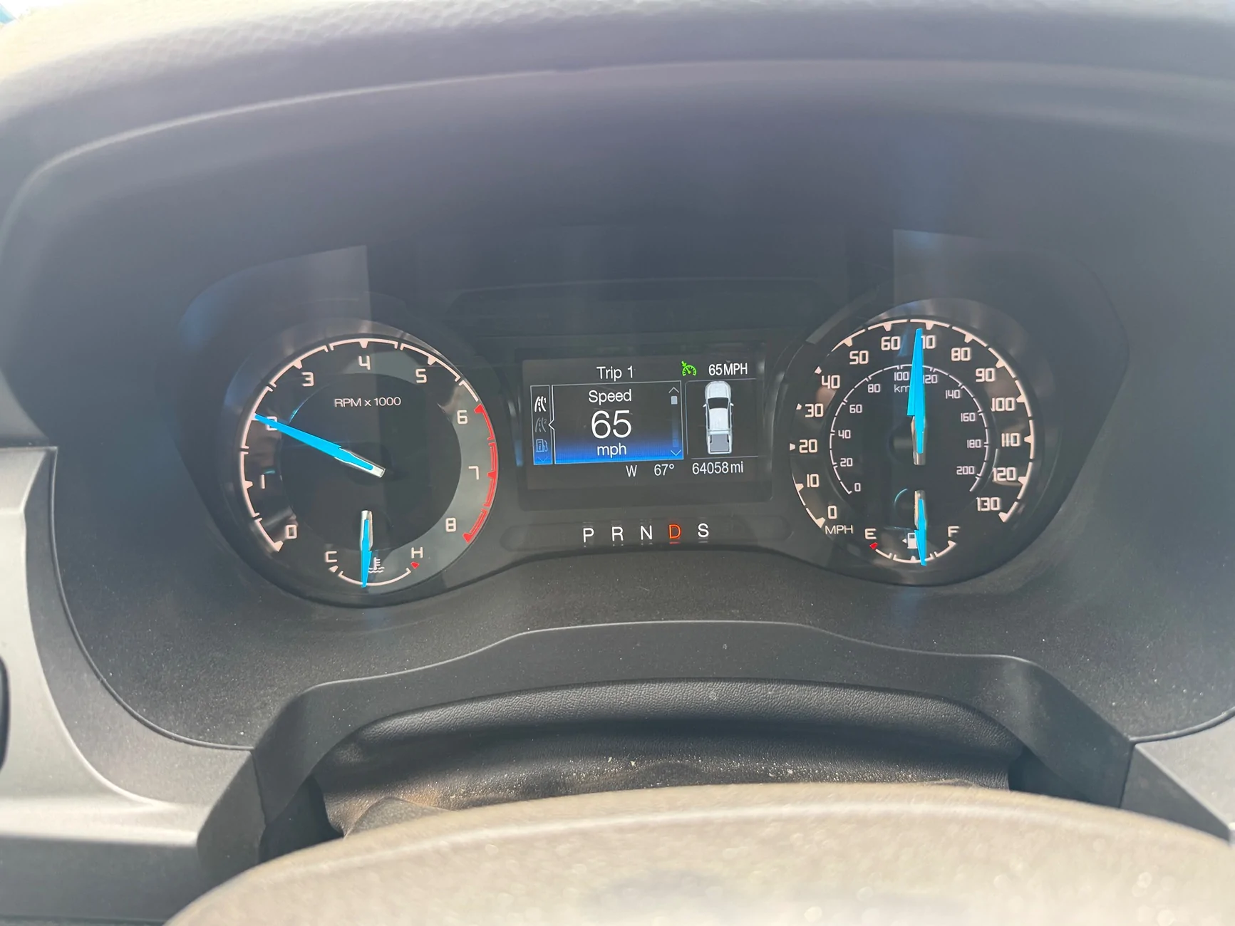

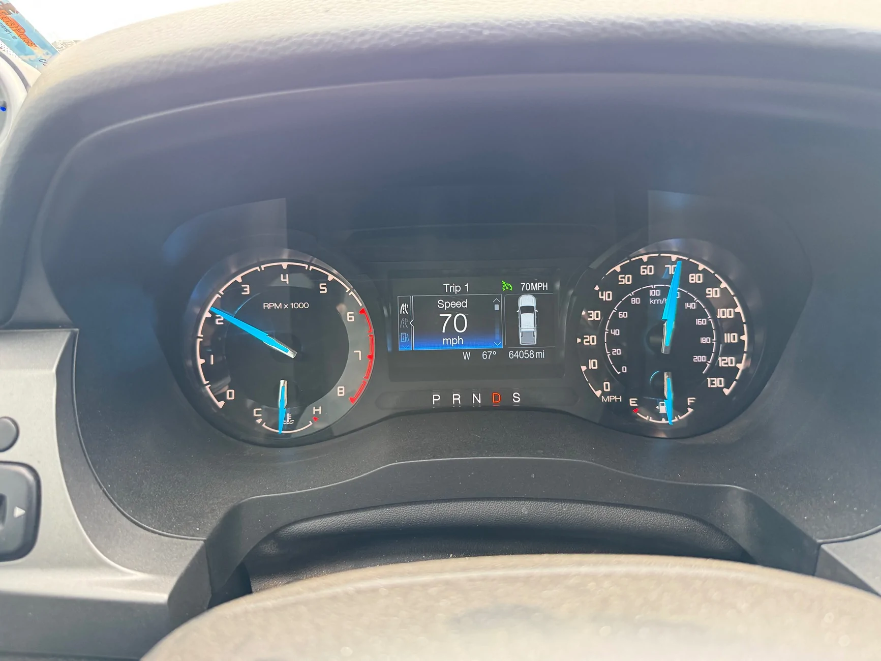

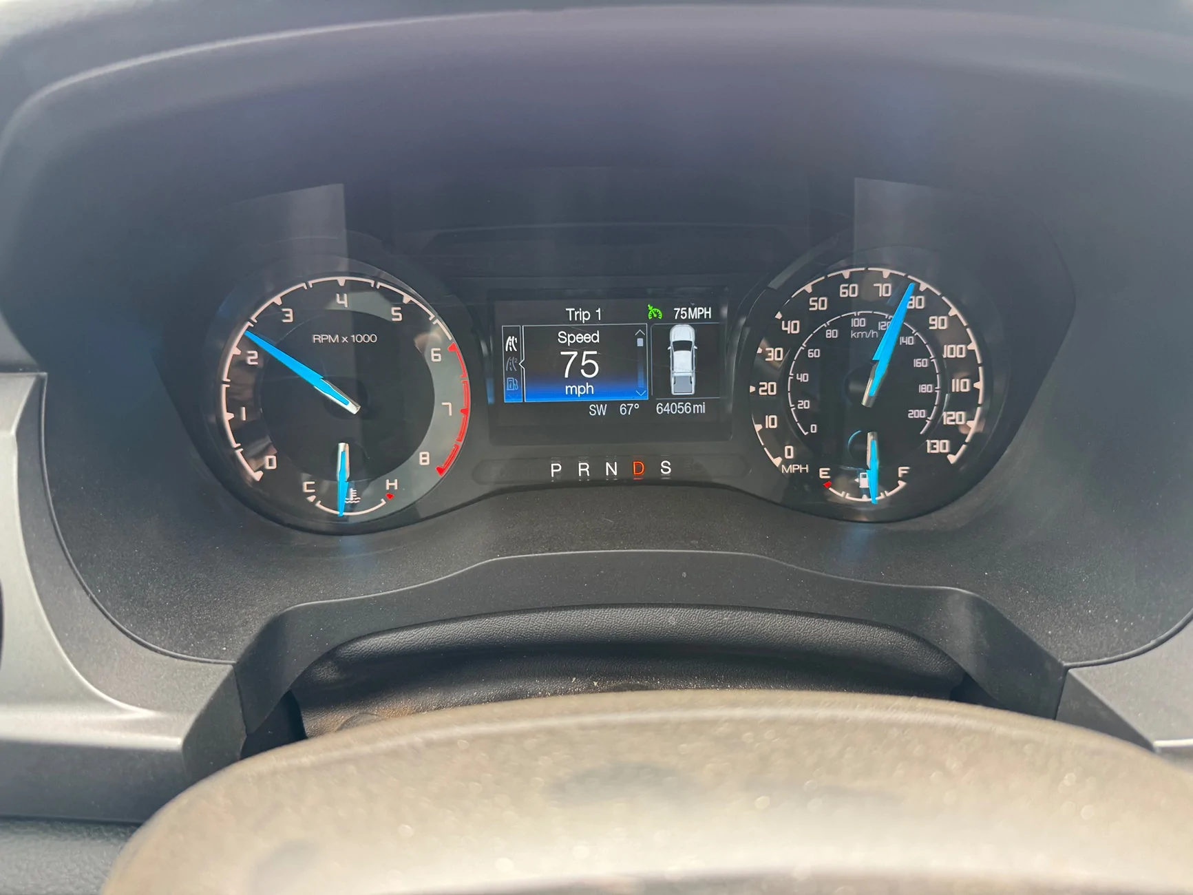

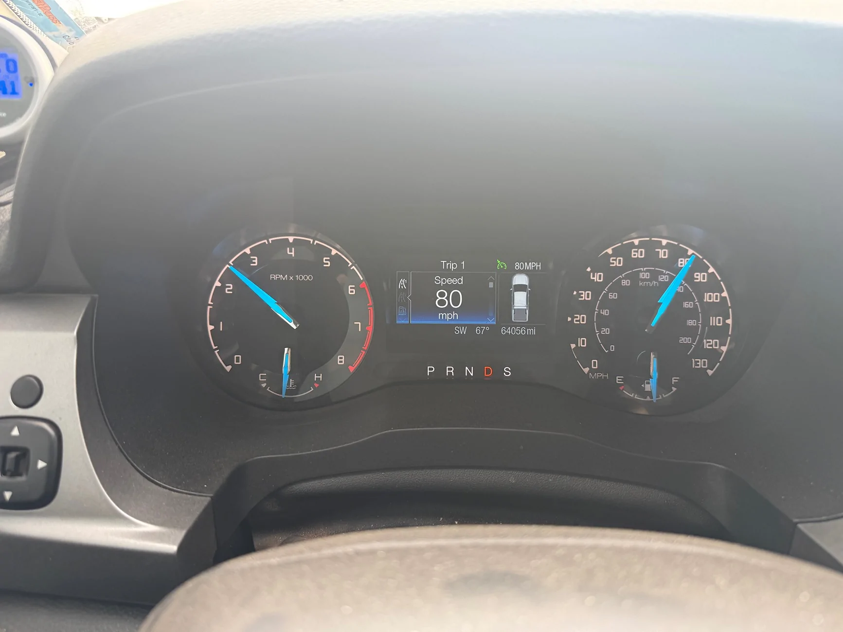

what is your rpm at while highway driving? This is the only thing holding me back from biting the bullet. I’m on 315/70/r17 tires so pretty close to a 35.
Colo_Ranger
Colo_Ranger
Apr 19, 2021
3,817
13,031
2021 Ford Ranger XLT FX4
Depends on the speed... We have 55, 65, and 75 out here. The truck cruises comfortably at 65-70. 75 is a little high and 85 is screaming. The truck will hold 85 but the RPM is high. I will get numbers for you next time I drive.

The OME BP51 is enough for 35s? I thought they only provide roughly a 2” lift? I was under the impression you need at least 3” to 3.5” for 35s
