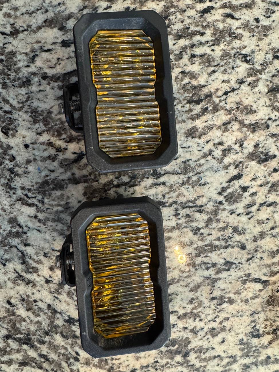

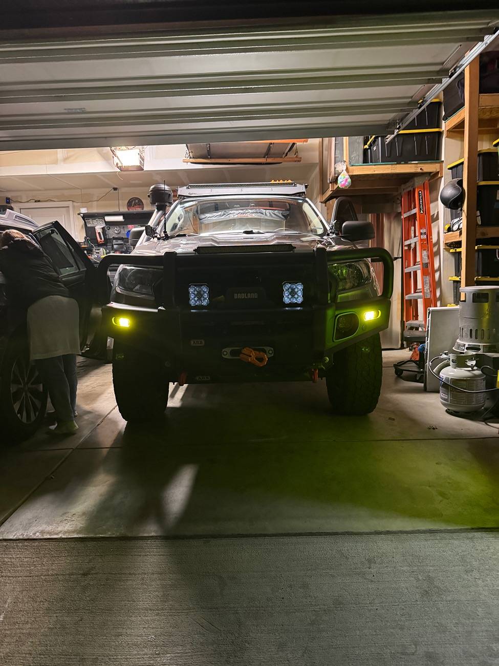

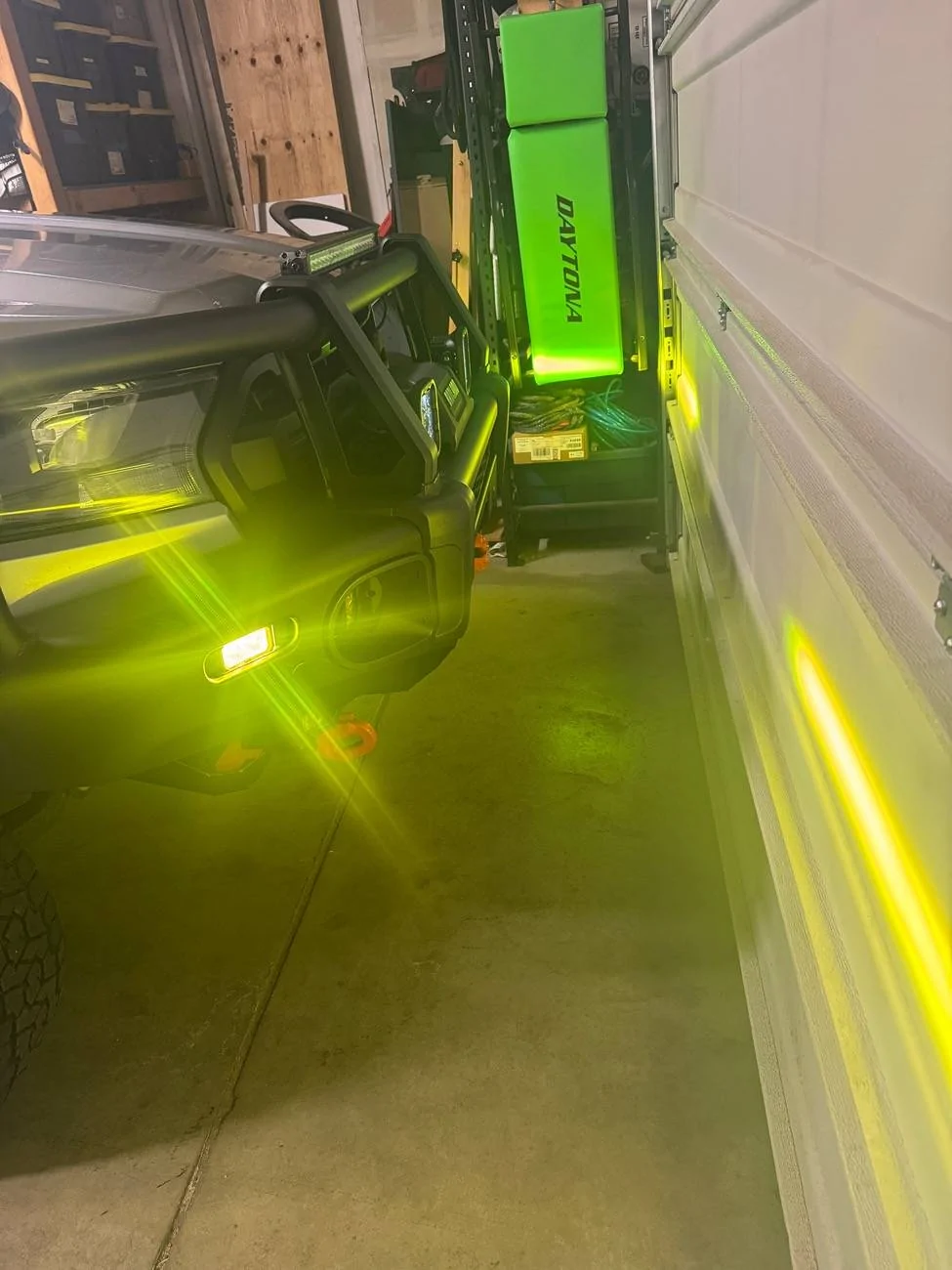

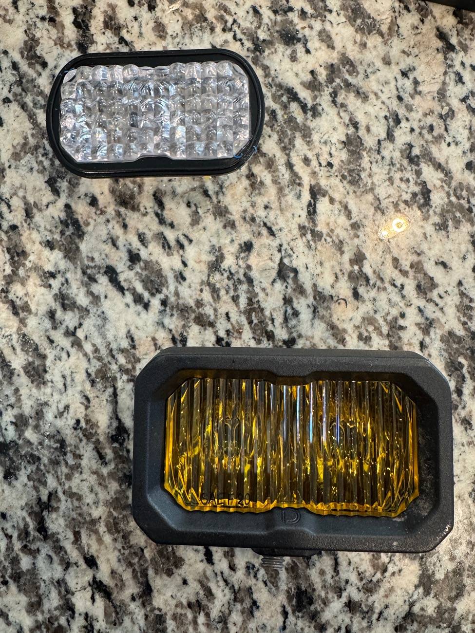

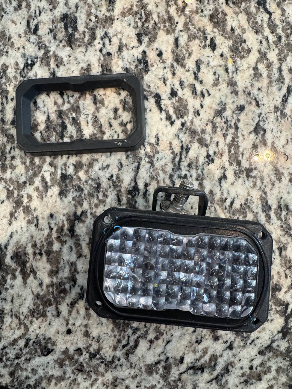

The running lights in my bumper have been white, and I really wanted yellow to match my fogs. I swapped the covers over to SAE fog yellows and I am really happy with them. I will get a picture of the fogs and running lights at the same time, but the fogs are my DRLs and it needs to be in drive (which makes it hard to do alone).

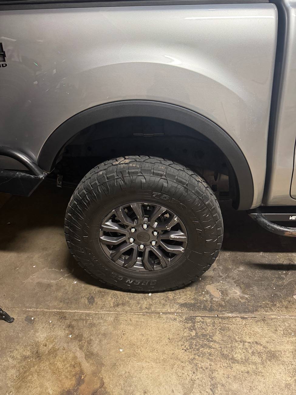

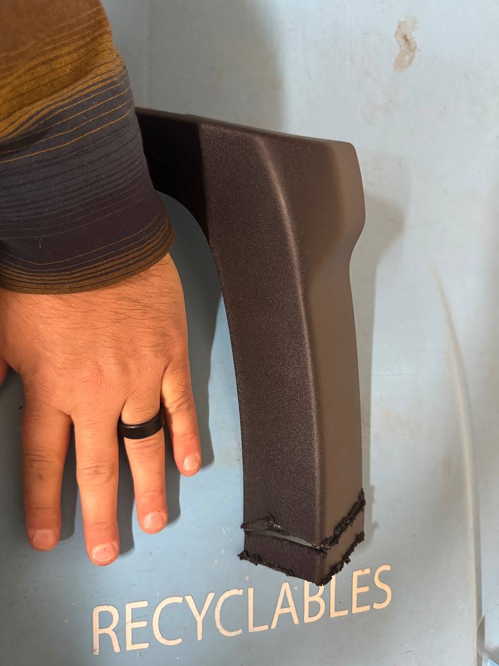

A little over a year and a half ago, I ripped the flare off this fender. I finally got it replaced. Its really nerve wracking to cut up a $153 part before its even installed.

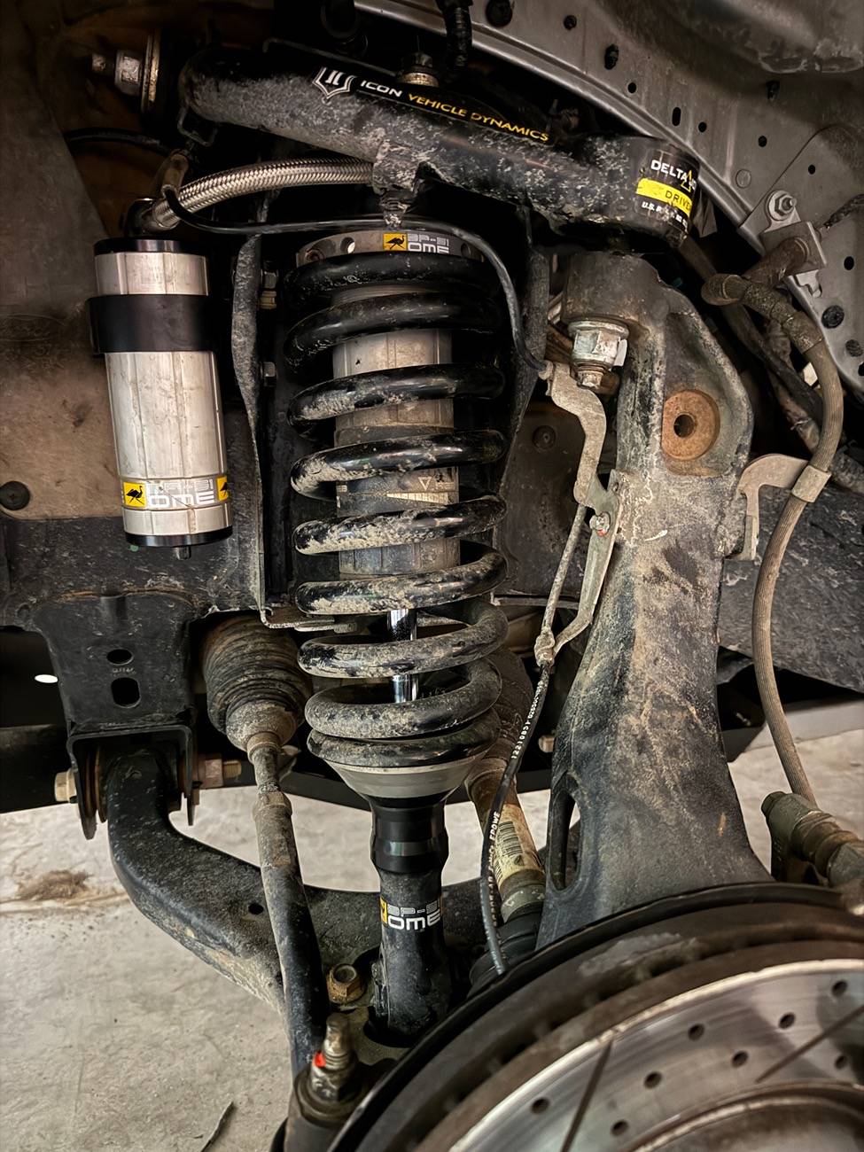

Time to upgrade my suspension. BP-51s will give me that ability to make adjustments. Given my build, these were made just for me. ARB bumper, skids, winch, and now suspension.

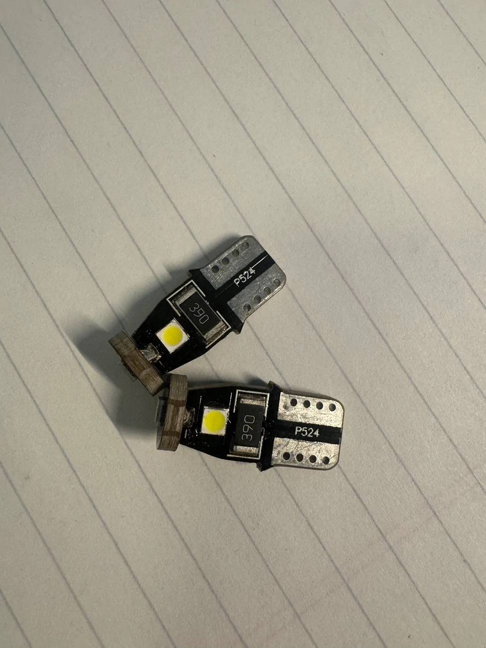

license plate LEDs because they're the only non-LED on my truck and it was making Andy mad. :LOL:

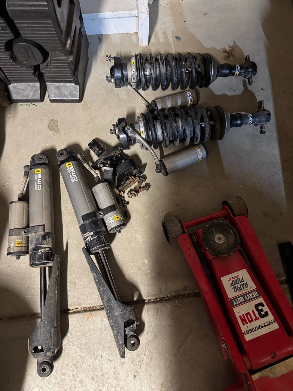

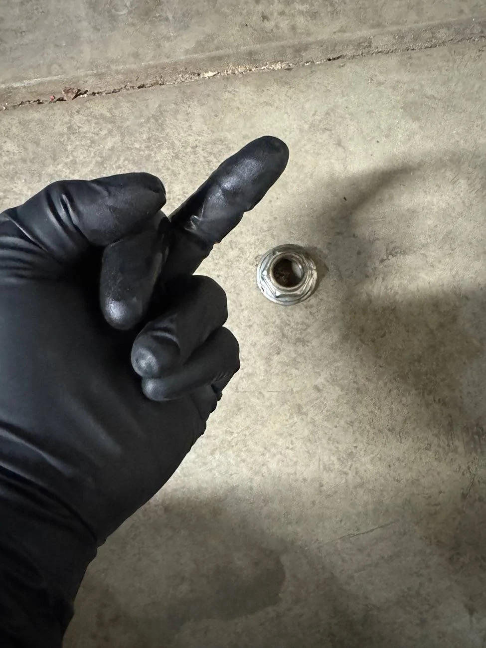

with the right tools, I can do the front suspension in just over 3 hours. That includes a dinner break and taking time to brush my kiddos teeth. It’s amazing what the right tools will do! I borrowed @AndyMedic’s Milwaukee impact. Turns out a $500 impact does a lot better than a $120 impact. Weird! The axle nuts only took 30 seconds total for both sides. Now they’re torques to 220 ft/lbs instead of holy f-ing balls.
these ride great. I’m glad @AndyMedic decided to upgrade to Kings (see above). I’ll tackle the rear shocks tomorrow. Right now, I’m tired and enjoying a cigar.

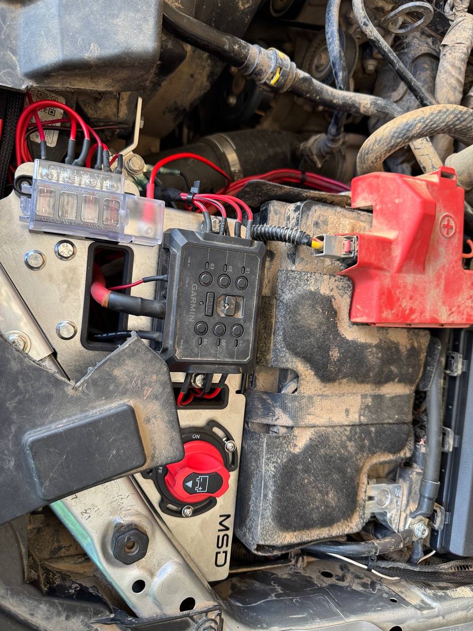

I spent 3 long nights after work really getting the wiring setup. I installed the SDHQ ground terminal, the MSD plate, and then wiring it all up so it looked good. I am really, really happy with how this turned out. I still need to hook up the winch to the isolator (the wire gauge is too thick and the crimpers are massive so I need second set of hands to crimp the new connectors on.
