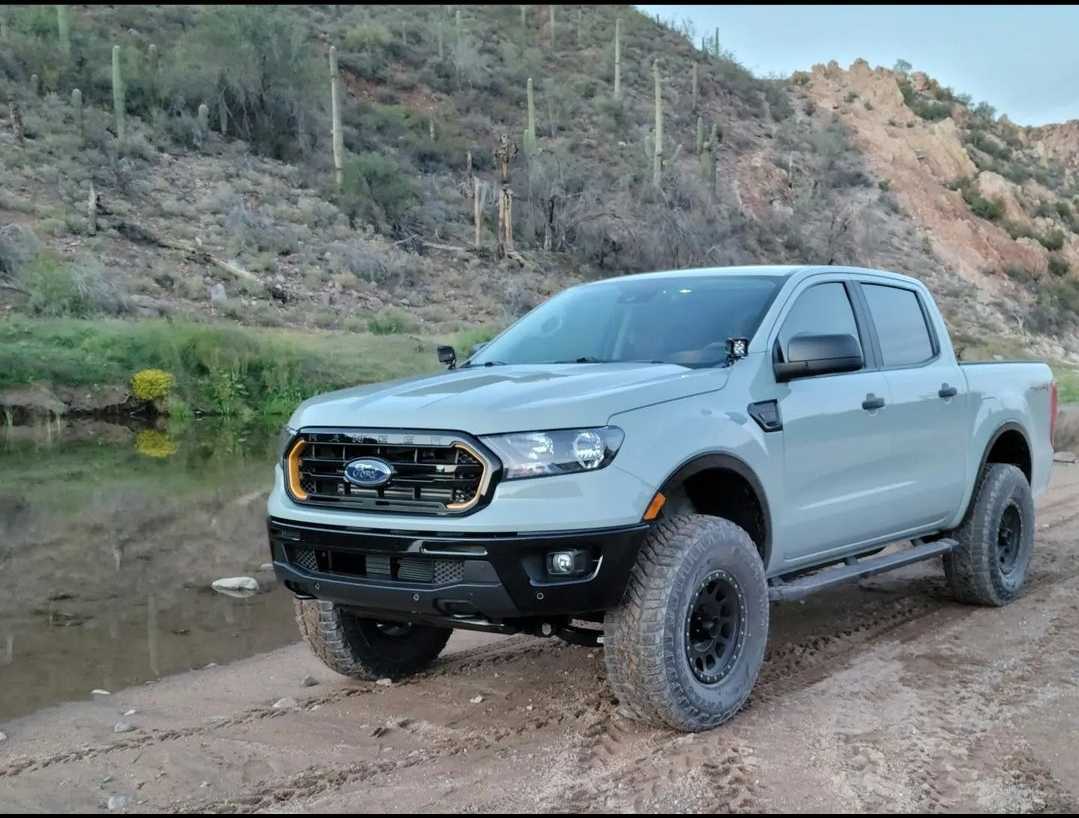

This is my 22 4x4 with the Splash package. Since this picture was taken, I have also added the FORD grille but swapped my gloss black perimeter trim onto it.

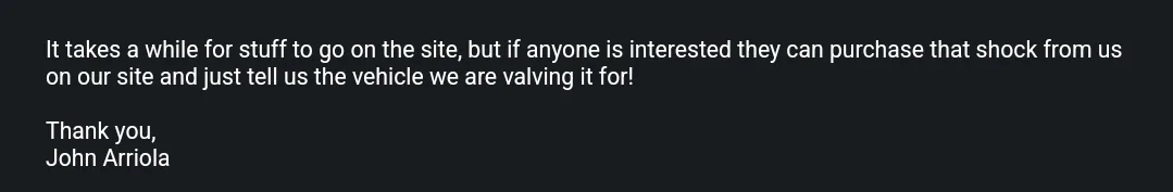

@Rad Ranger any updates on those rears?
Yup!
Got them installed last week and went out for a nice trip Sun-Mon. Had to mount the reservoirs diagonally from the shock body, but no issues.
The trip was mostly just rough dirt roads, but had a few spots where it got technical. Went down a series of ledges and drug the hitch on the last one. Went through a rock garden that ended up pinching my exhaust tip also. Overall, the shocks felt great. Unfortunately, I'm still using the FX4 coilovers, so that was pretty miserable.
I ended up speaking with the AccuTune guys about 2.5 non-res vs res and they said not to bother with the non-reservoir. Just save up and buy the 2.5 with reservoir. While the damping is much better in a 2.5 vs a 2.0, the oil volume just isn't there to prevent fade and cavitation. Eventually I'll most likely be getting Radflo 2.5 remote resi coilovers.
As far as the 2.0 remote res rear shocks, they are not listed on the website yet. I will come back and post the link once they are added.
