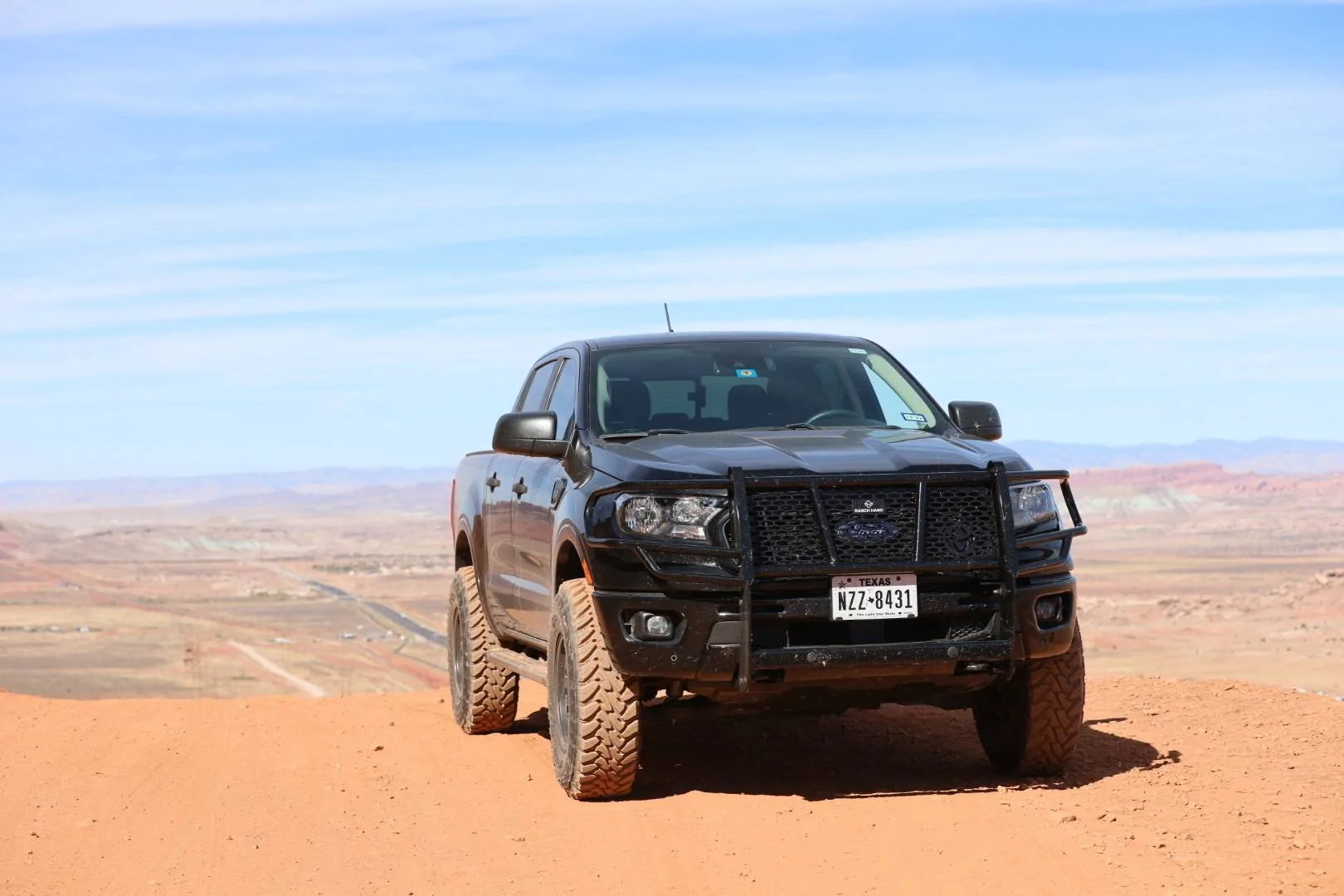

They’re definitely heavy, but boy are they tough
Hell yeah AND by far the best looking MT, I just cant justify getting them I live in a city now. Duratracs are almost too aggressive for me. You truck looks killer good work!!
