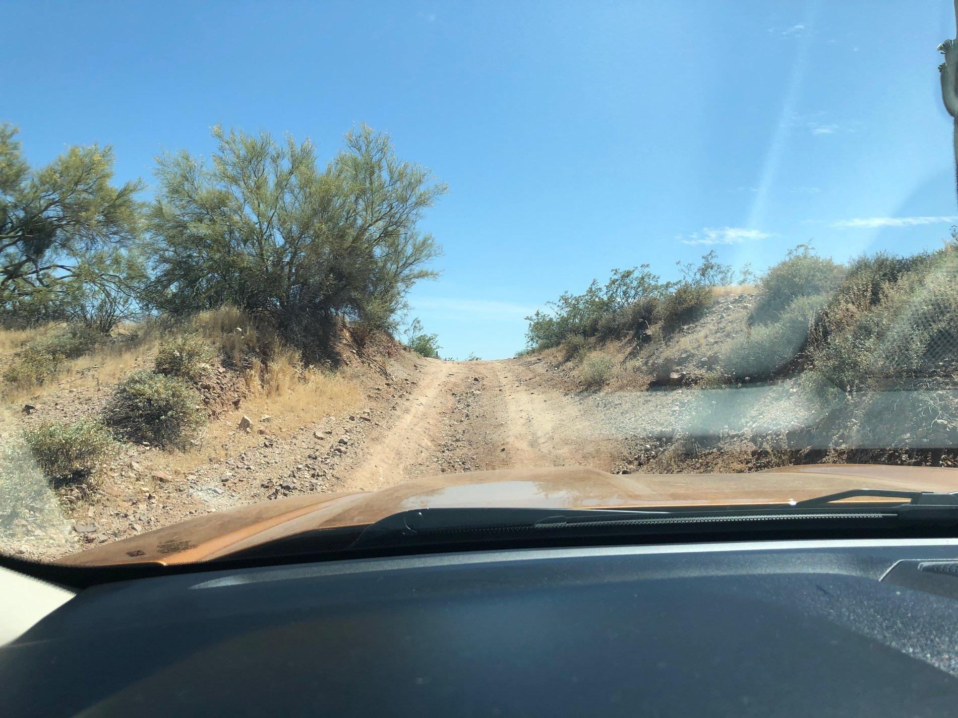

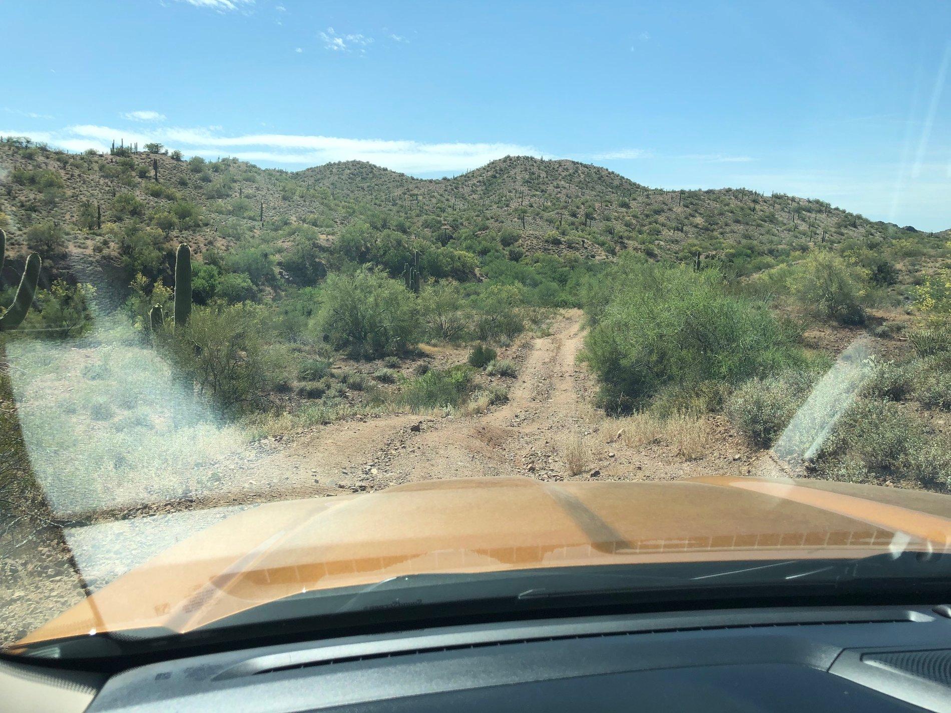

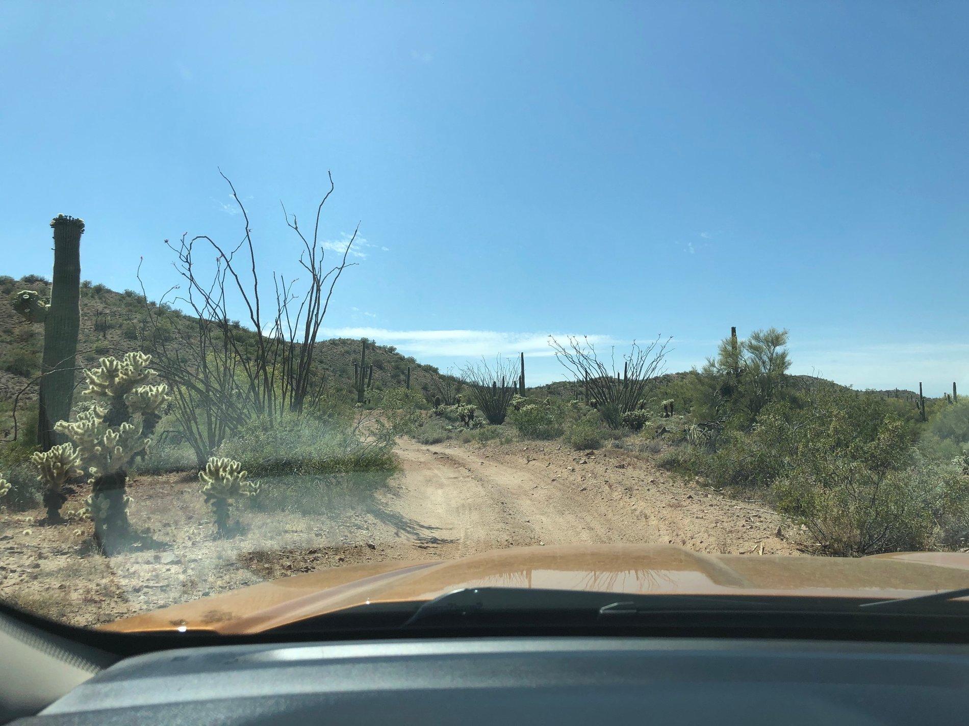

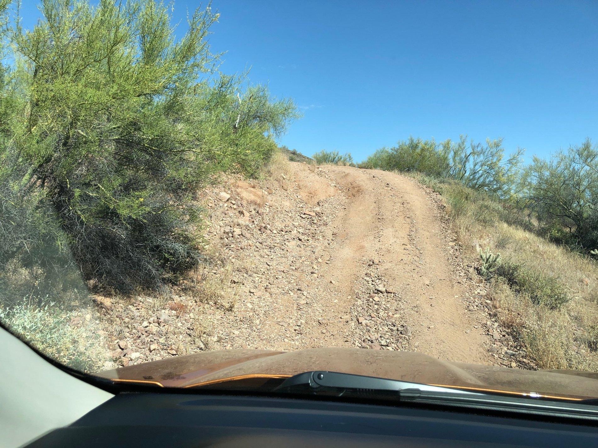

Hi Morgan, In the pictures below I was in 2wd the whole time except for when I hit the sandy washes (deer picture). Not that this was anything rugged but I still had to stay around 5-10 mph max. It was a trail I saw off the road yesterday as we were on our way back from Wickenburg and I decided to check it out,it was about a 10 mile loop. There were a few good inclines/declines and some small rocky areas but nothing crazy and I never had any problems in 2wd. You should have no problems handling the service roads with a 2wd.
