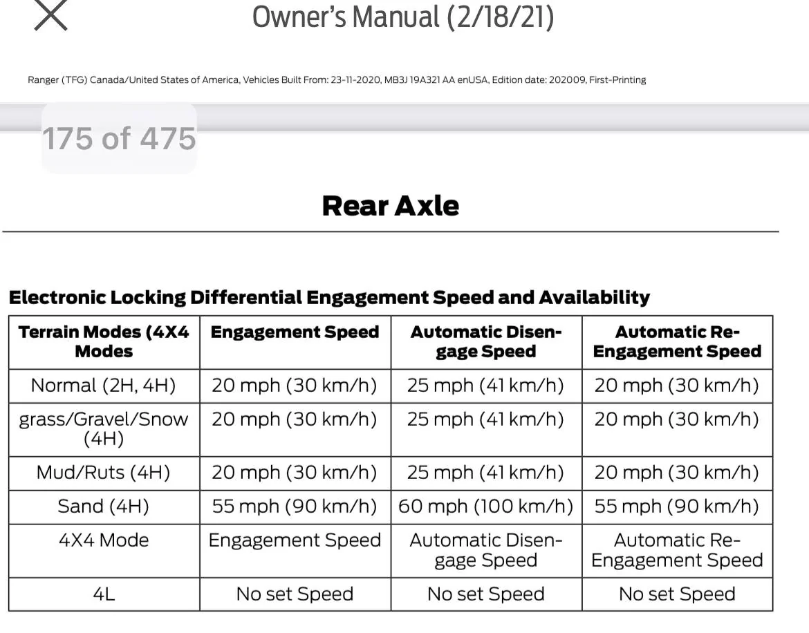

The locker will disengage at 20, unless your are still accelerating. I was at 50 mph today with locker, back off gas, disengages.

Does anyone know if there is any maximum speed threshold at which 4H disengages? Or at what speed the locker will. (I know - read the owner's manual)
68mph. for the 4H
If you leave it in 4H, it will reengage again once you're below 68. There will be a msg in the center stack when it changes. It's seamless. It doesn't pull, shudder, grind, or anything else shifting from 2H to 4H on the fly or vice-versa.
It is a good Idea to let up some on the accelerator or coast when changing modes, like you do on a multi speed bicycle, but it will wait if there is a high load on the transfer case, like hard acceleration or pulling a trailer up a steep incline.

The 5G Rangers will disengage 4L to 4H at about 22 mph. It will remain in 4H until you come to a stop, then it will re-engage 4L, if still selected. The same is true going from 2H or 4H to 4L on the move. It won't engage 4L until you stop. 4H can be engaged up to 68mph/110kmh.
Except that you have to be stopped for it to shift into and out of 4LO. If it were to do this while moving there is a high chance the transfer case would blow up.
That's what I said. Just to clarify, you can leave the twist knob in 4L, and at 20mph, it will disengage 4L, staying in 4H. When you want 4L again, you have to come to a complete stop. If you've left the knob in 4L, it will now reengage.

Don't know about max speed, but i've played with launching the truck in 4wd before and hit at least 70 in 4H. Think the locker disengages around 25-30.

The locking rear axle will engage and disengage as needed and depending on mode.
This is what I was looking for, thanks. Pardon my laziness of not looking it up myself.
The more I learn of terrain modes the more I like sand; I take my truck in deep sand on the beach a lot and have the opportunity to get it up in speed. I’ve tried sand mode before but usually just go to 4H and maybe the locker sometimes but now from what I know about these modes and how they control the differentials and more, I plan on using them.
