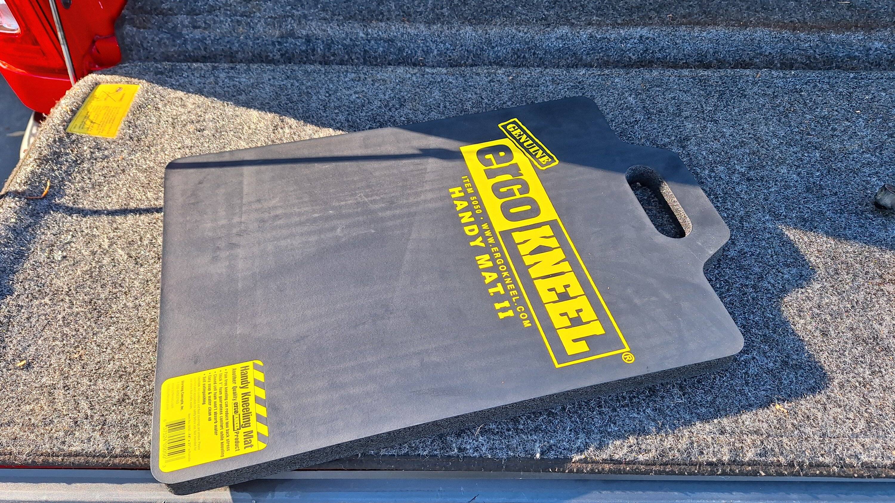

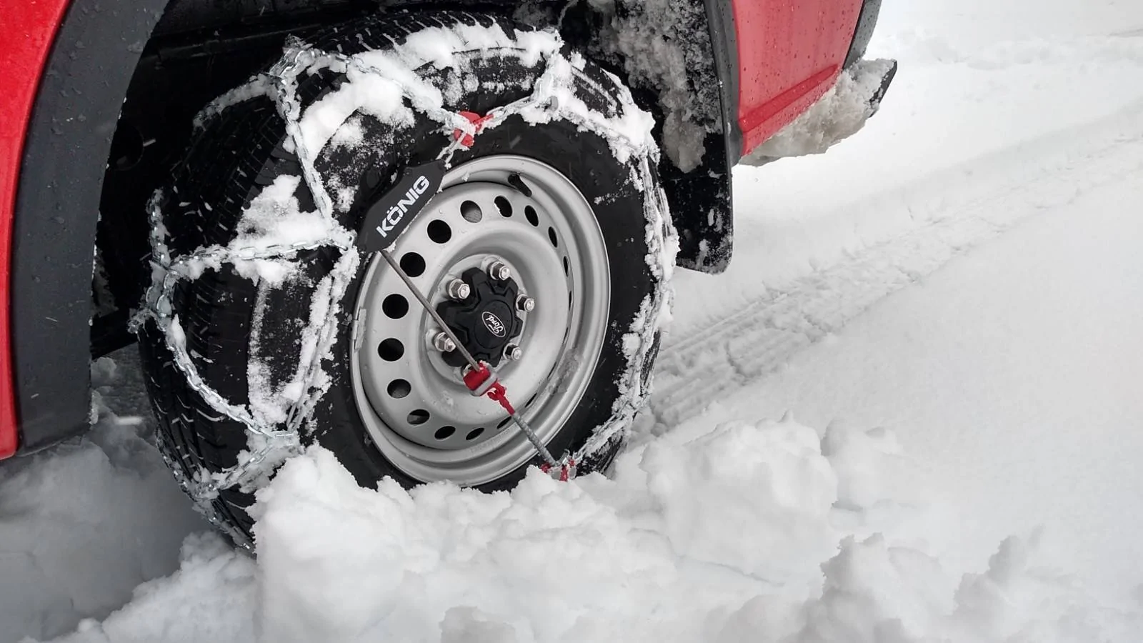

Old thread but for anyone searching, I love these snow chains. I've used them only a few times on my 2WD XL with stock steelies and they're easy to put on and take off (I've since bought a dedicated kneeling pad for this and other uses, rather than using my often dirty floor mat).
König XG-12 Pro
ergoKneel
