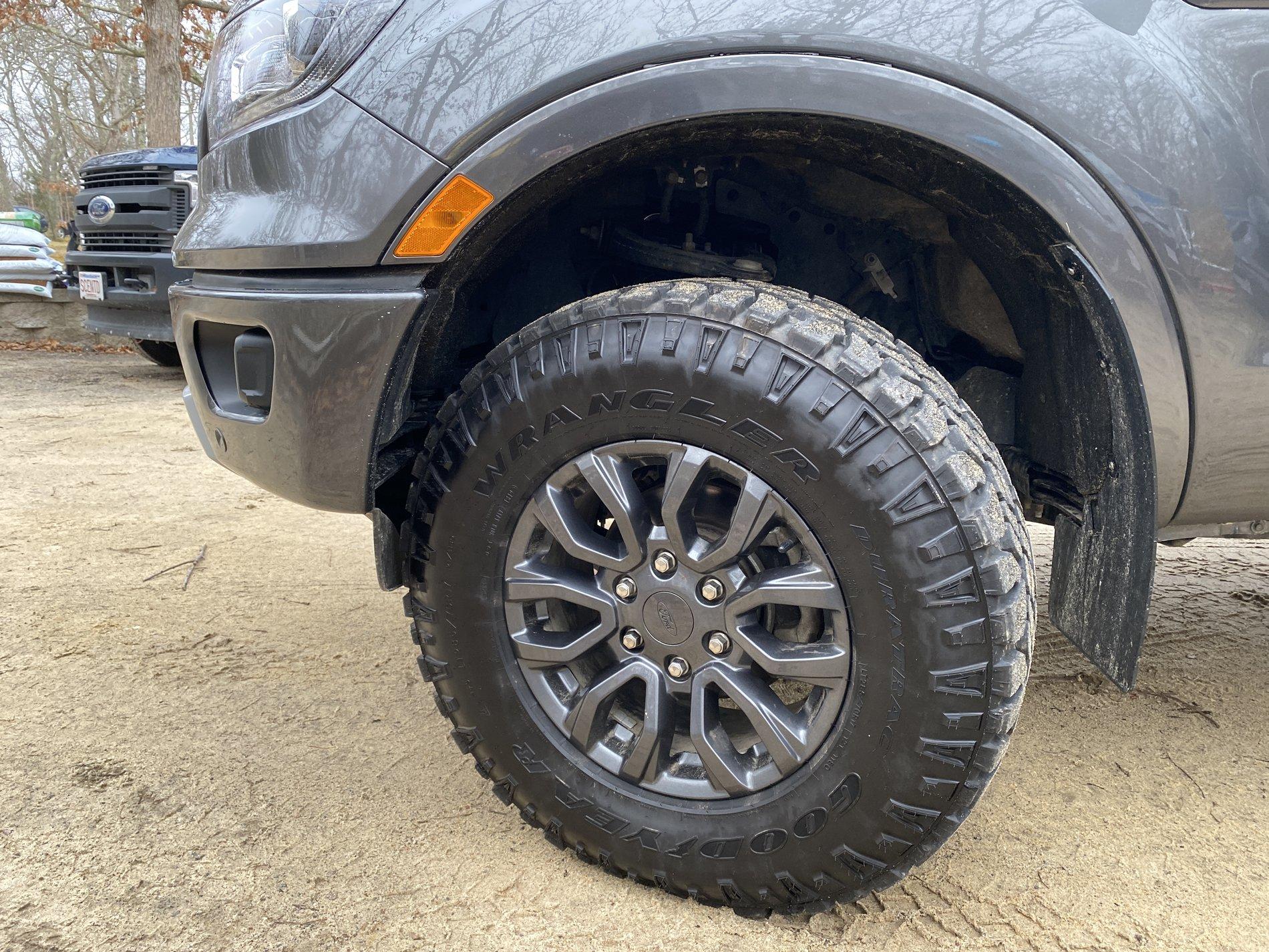

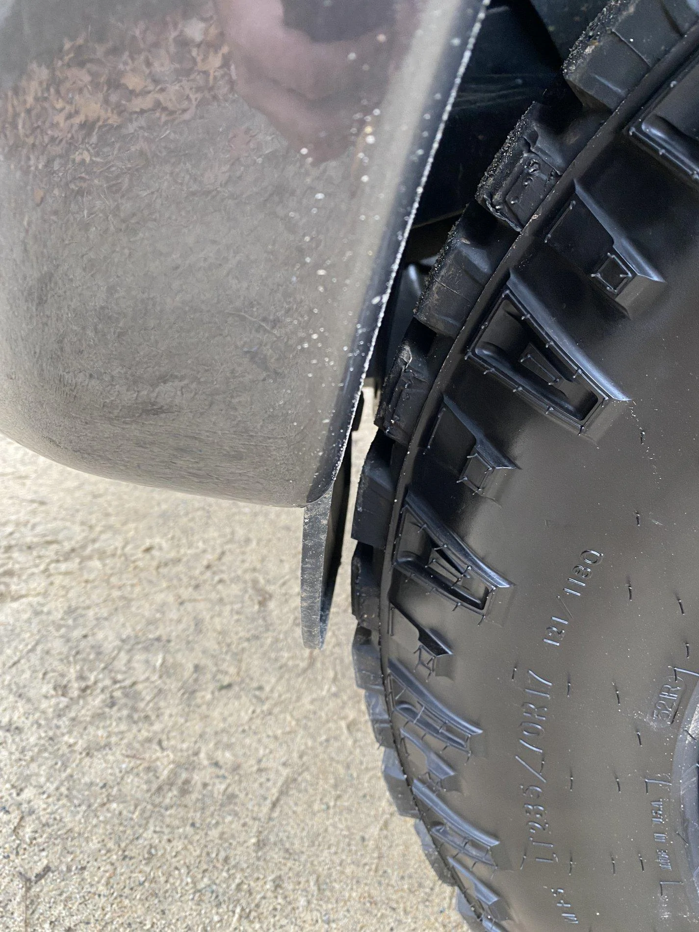

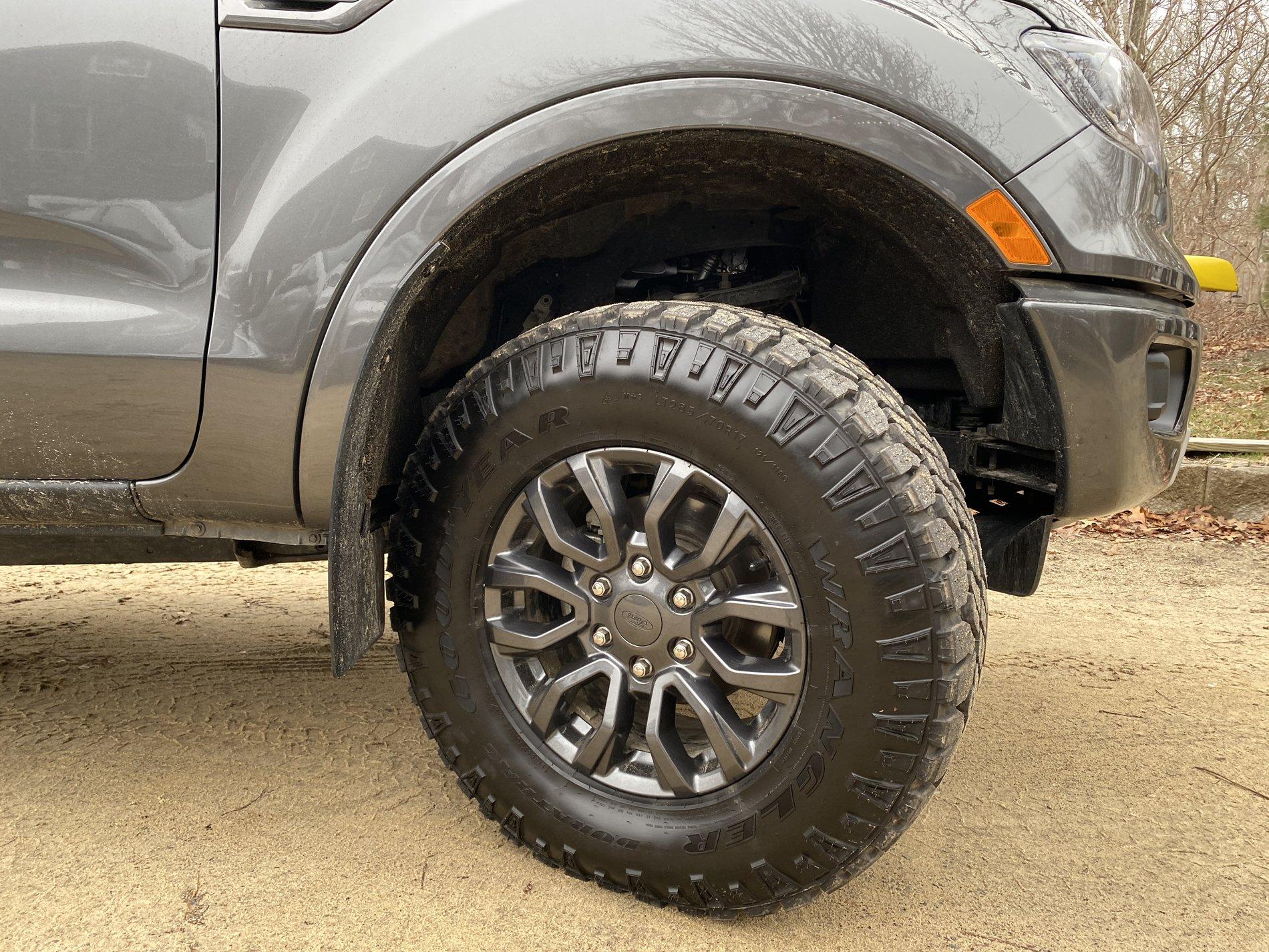

Zero chance of clearing chains in the front of my setup. I was considering stepping down to a 32" tire for dedicated winter tires, but Nokian makes the Hakkapeliitta LT3 in a 285/70R17 and I'm not sure a 32 would clear chains anyway. Plenty of room on the spindle with the 285s and 1.5" spacers, but the spacer takes the room from the rest of the wheel well.
I'd feel confident putting chains on with 3/4" spacers (or wheels with about that offset) and a tire under 31.5-ish. Might need high-clearance crash bars to clear the chains, but they would clear the bodywork and suspension just fine.
Do you have the 1.5" spacers installed in the photos?
If so they're a little tight for space, but the 1" or 3/4" spacers should be adequate to give inside clearance and around the wheel well for chains not to foul.
This may be the most cost effective solution for adding chains to the front.
