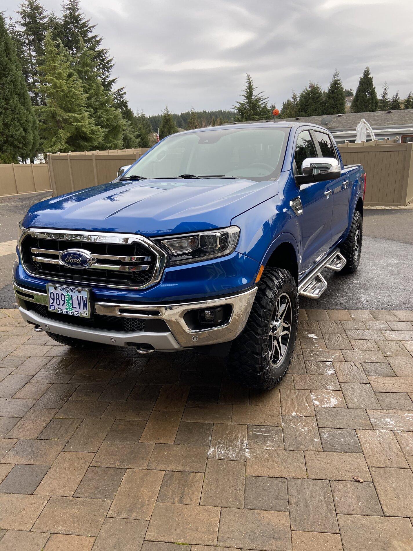

Did a bunch of research on this site for tire size, wheel offsets etc. Thank you to all that added helping info!
Here is my Truck:

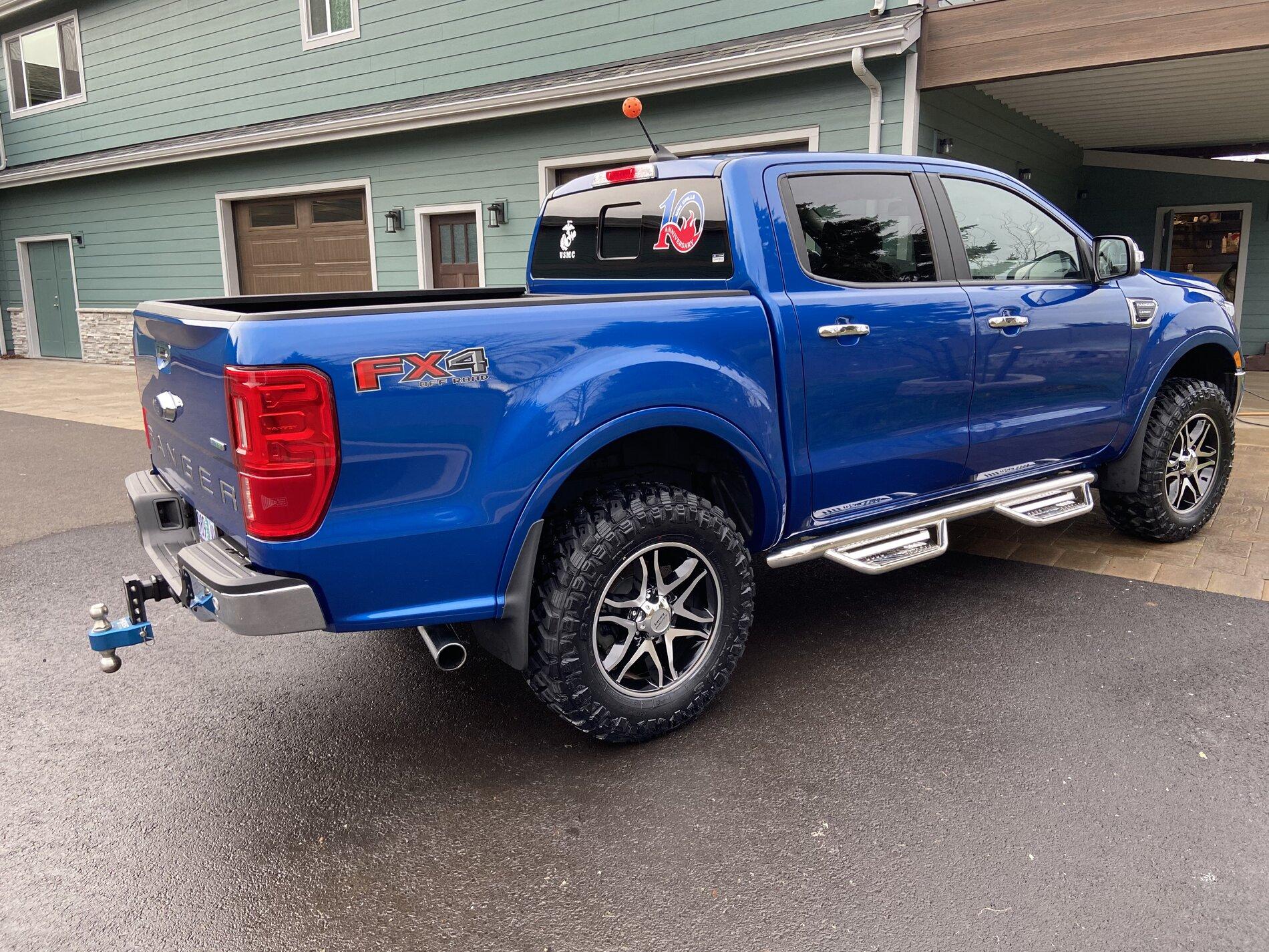

2019 4x4 FX4 lariat with a 2.5" leveling kit.

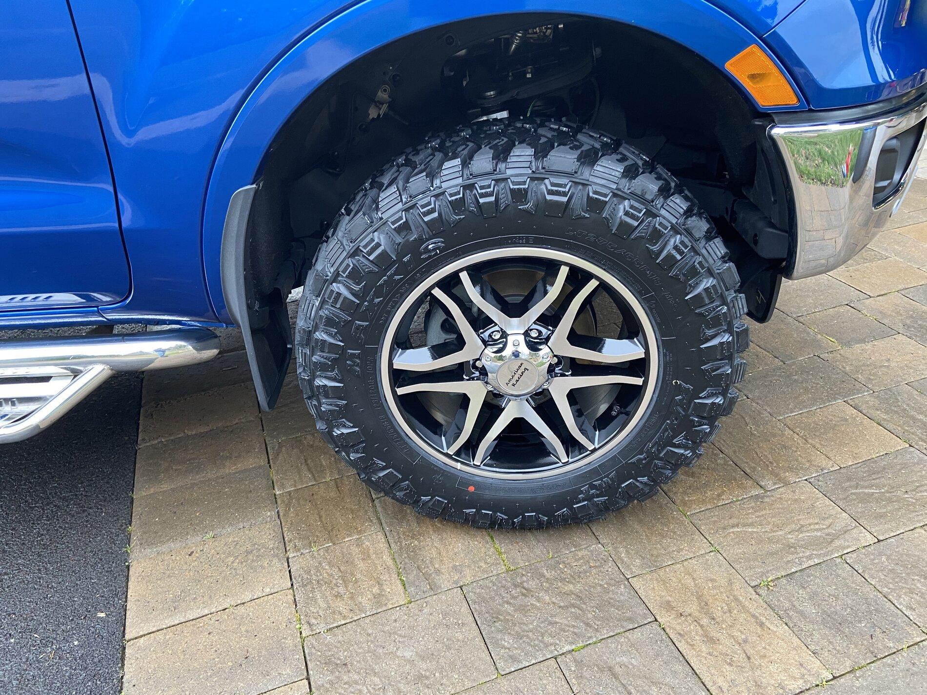

One thing I struggled with was understanding the wheel offset where + is toward the truck and - is toward the street (hopefully this helps someone else).
My stock wheels are a +55 offset so these bigger tires (although barely wider) wouldn't fit so I ordered wheels with a +30 offset (basically 1" different toward street) to clear. The tires do not rub under normal driving but do slightly rub under compression while turning on the intrusion beams in front so I ordered the BDS Intrusion beam kit to gain the extra clearance needed there.
I decided on these tires for the look and for the customer ratings on road noise for a mud tire (last truck was a diesel so never worried about road noise lol). I have to say they are slightly louder than the stock tires obviously but way less than I expected which holds true to other customer reviews. They are a load E rating which is overkill but they ride really nice and look awesome IMO. Currently running at 40psi which feels about right so far.
Anyone have knowledge how to adjust the speed/tire ratio in forscan? Say's these are +3mph at 60.

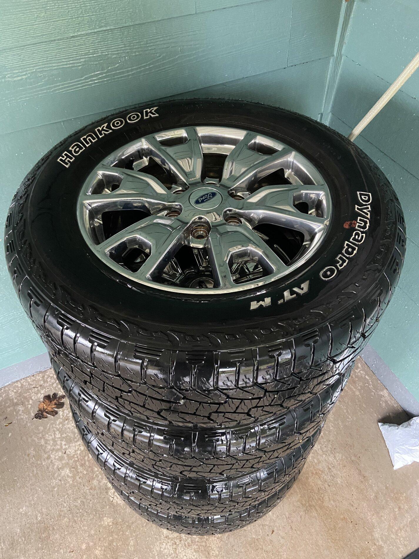

If anyone local is interested in the stock tires and wheels make me an offer and come pick them up :)
