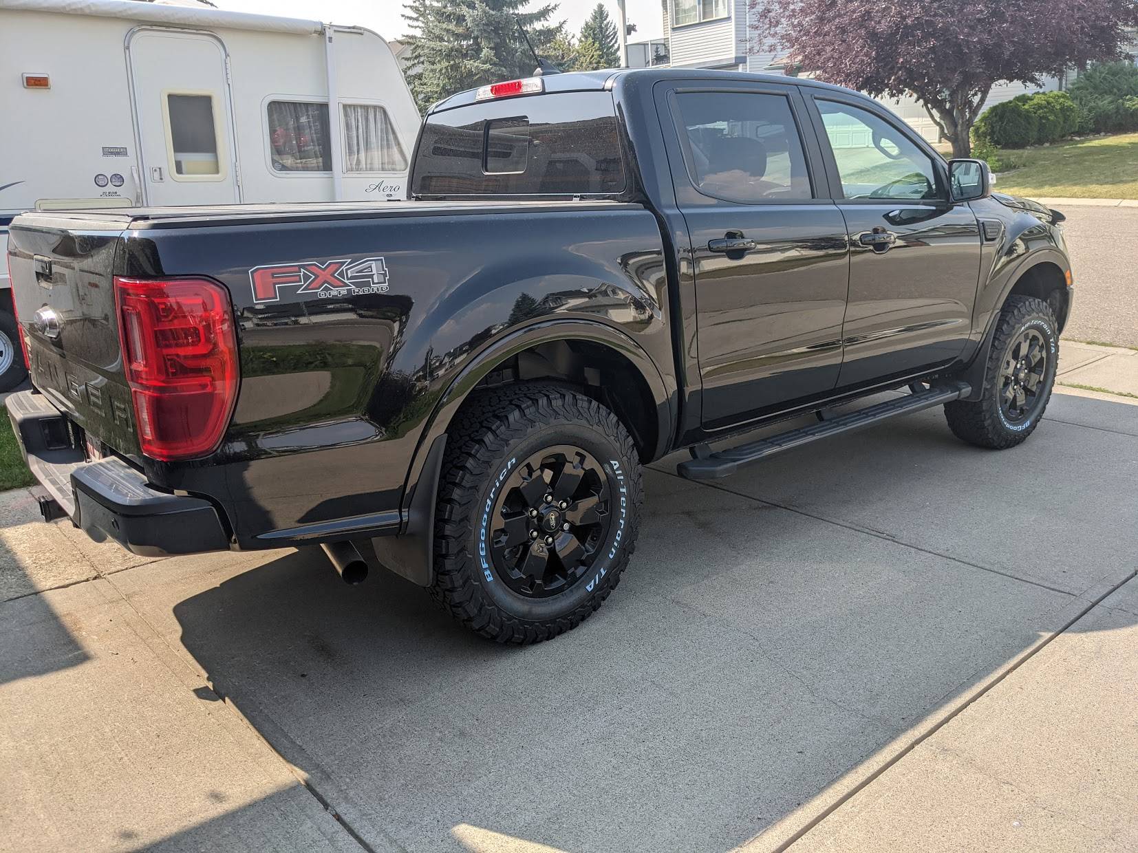

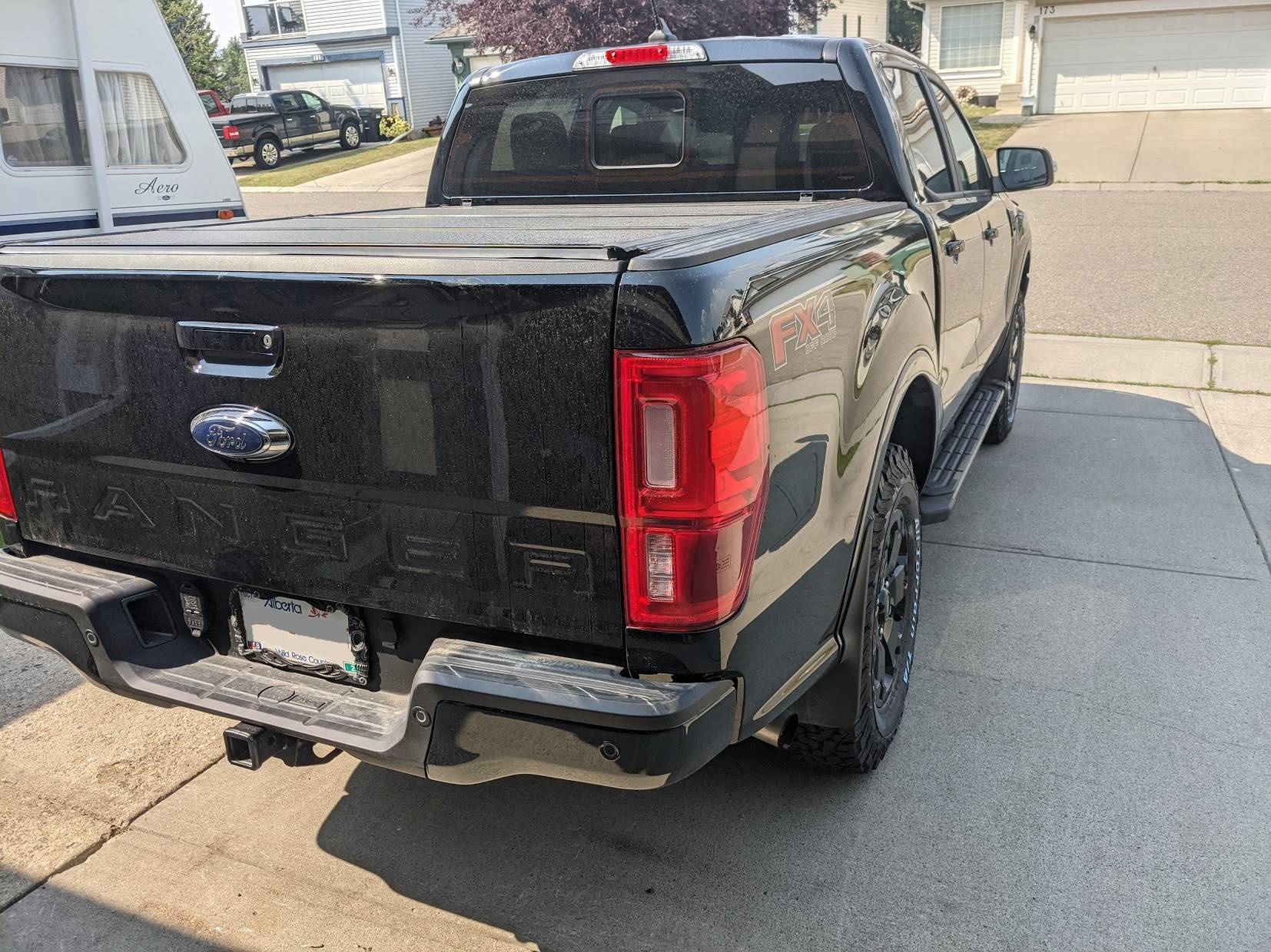

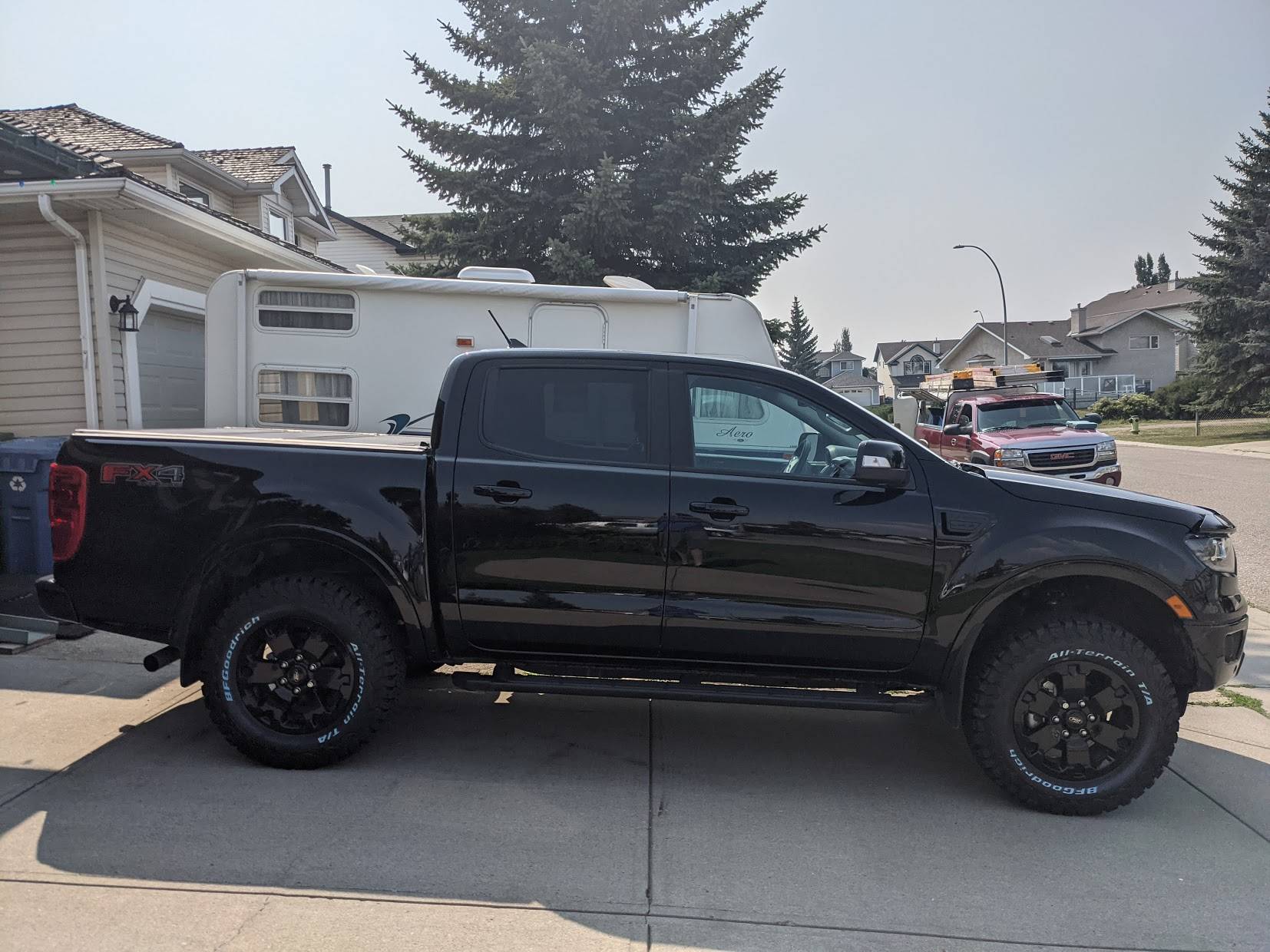

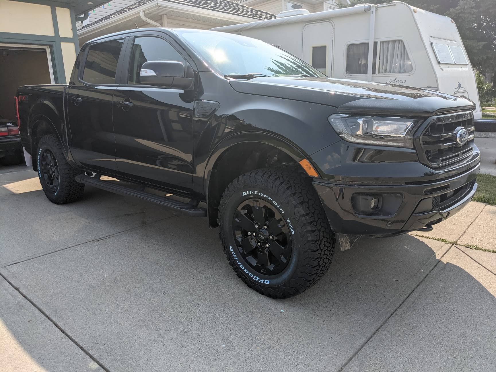

Long time lurker, first post. Just managed to squeeze some 265/70R18 KO2s on my truck with only a 2.5" leveling kit. I scoured for days to see if this would work without adjusting crash bars and couldn't find an answer as everyone seems to use 17" wheels. I took the chance on them and gave it a shot. Just wanted to let the next guy know that it works without any rubbing.

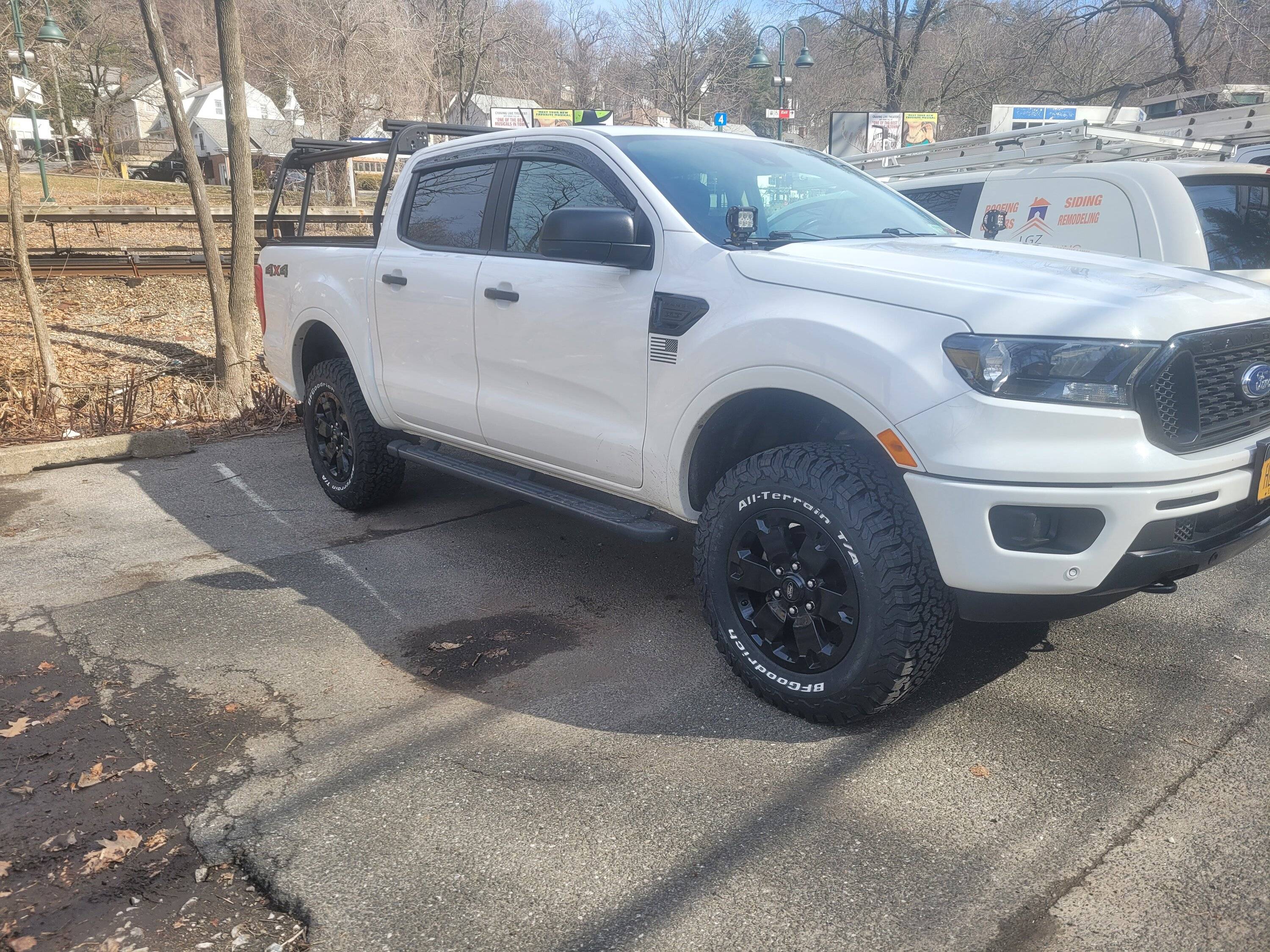

Thanks, just pulled the trigger. Same combo, I'll post pics soon. Your a gem.

Hi there, going about the same setup. Do you think adding 1.5" wheel spacer will start rubbing or there is enough room?
I think it'll rub, but probably not by much.

Hey Xevo...looking to do the exact set up on mine, do you think would work with a 2 inch lift or is the extra .5 critical?
Thx
Sorry for the very late response. I'm not sure, but it'll be super super close. If I was a betting man, I'd say it'd rub slightly.

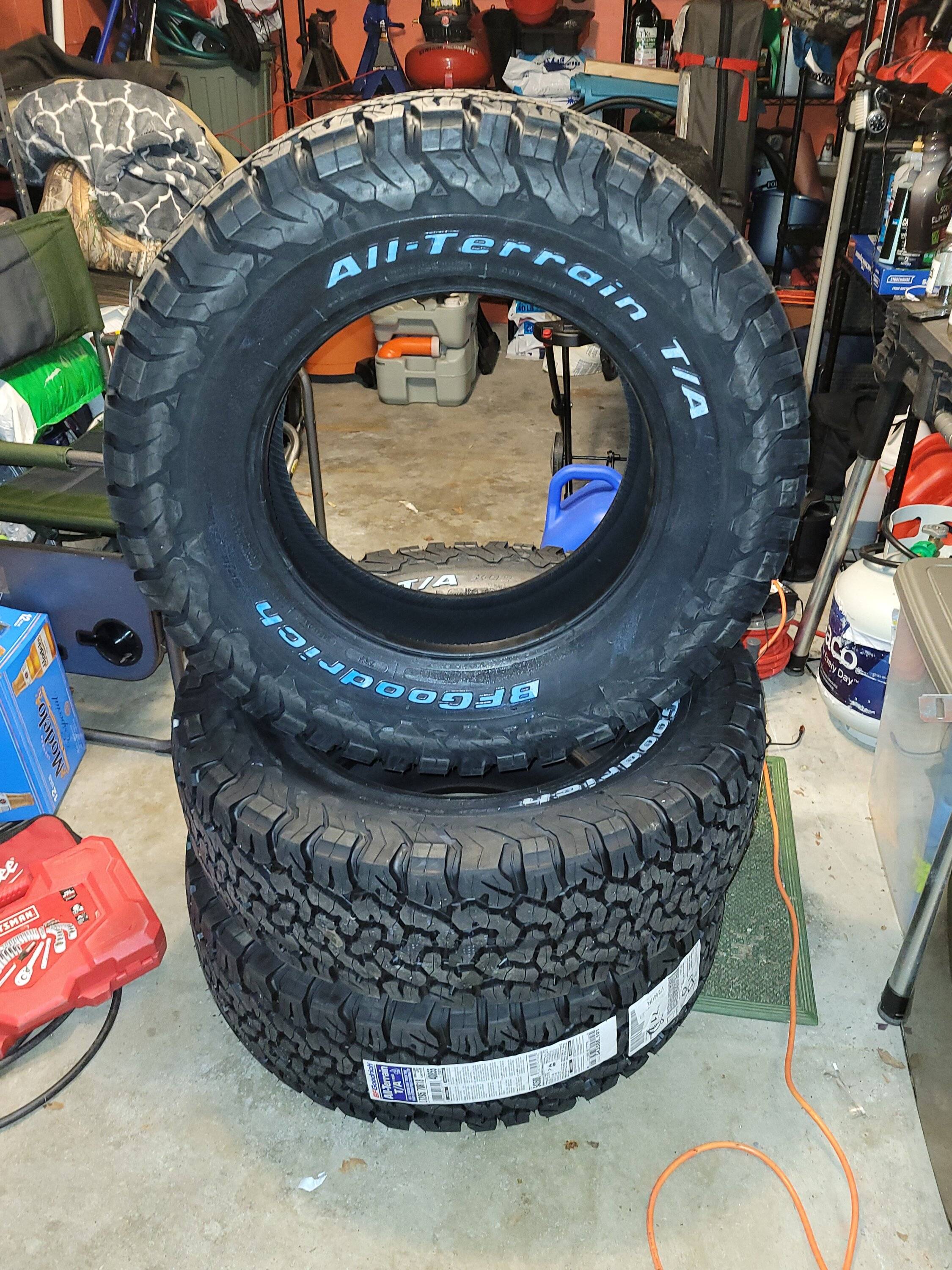

Nice... I bought these tires and bolting on soon. Techs and salespeople at Discount Tire were very confident that they'd work after a test fit.
