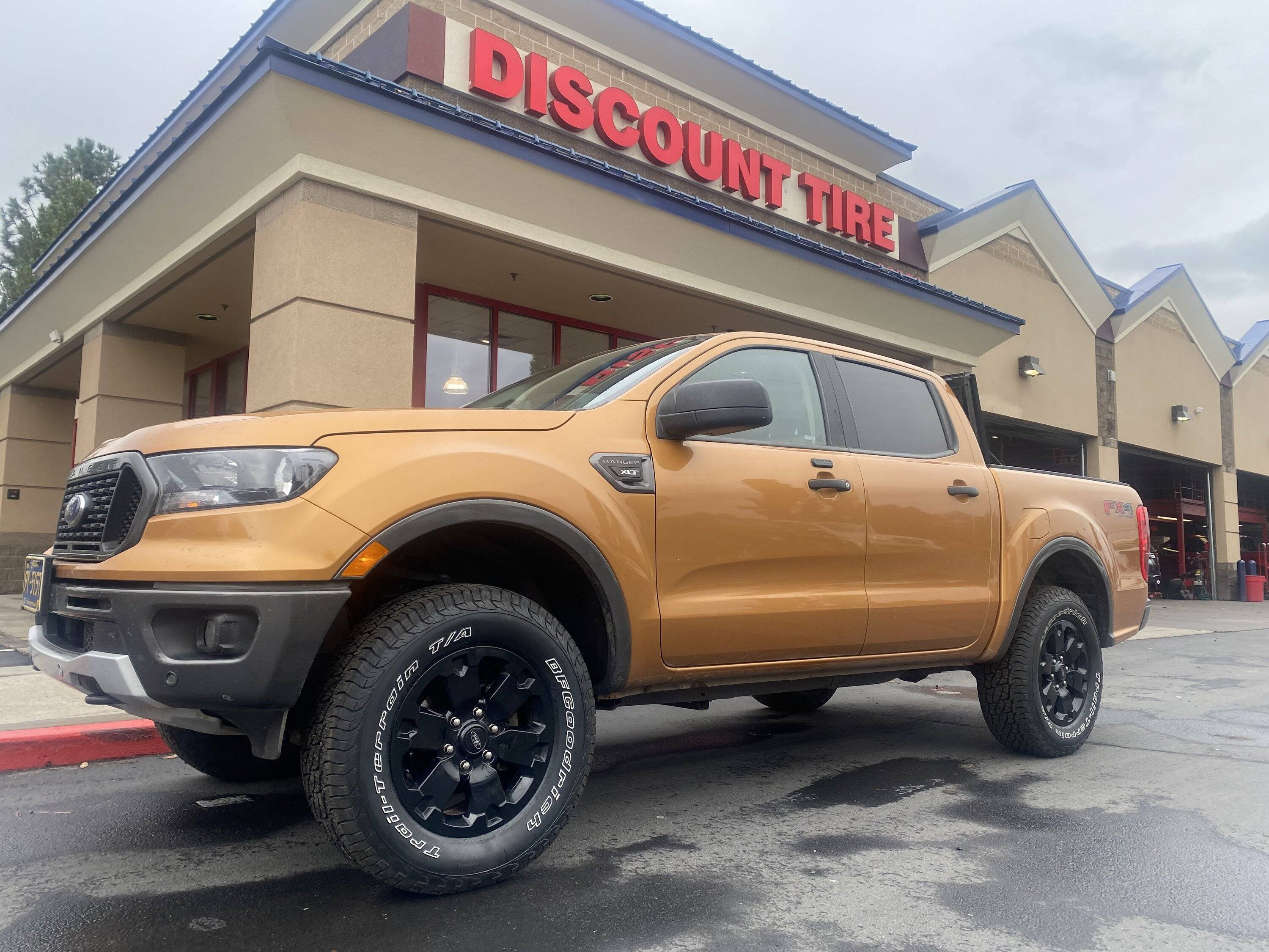

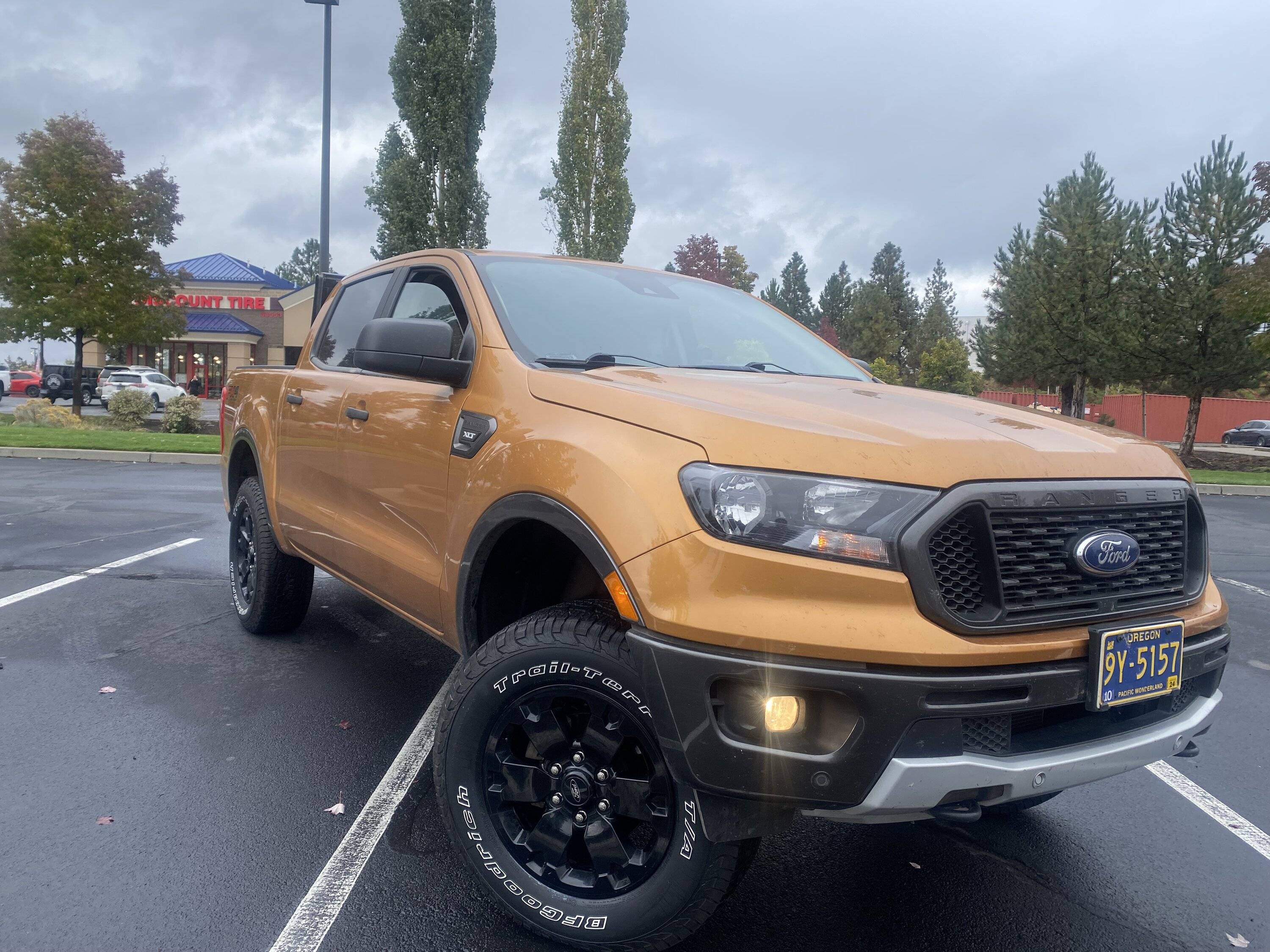

Update:
265/70/18 BFGoodrich Trail-Terrains 31.6 inch diameter
stock wheels
no crash bar mod
2" Ford/Fox level kit
no spacers
Verdict: No rubbing yet. I haven't done anything to get to full lock but during normal driving conditions these fit just fine.

Update:
stock wheels
no crash bar mod
no spacers
Truck looks awesome! Always liked that color. Thank you for your patronage. We appreciate the opportunity to earn your business.

Update:
stock wheels
no crash bar mod
no spacers
That’s 32.6” diameter.

Turns out there’s a bit of front crash bar rub on full compression. Assuming both sides - but, it’s happening on driver side when backing down our driveway. Gotta check passenger side. Either way - Ready Lift Intrusion Bars are going in on Monday.
