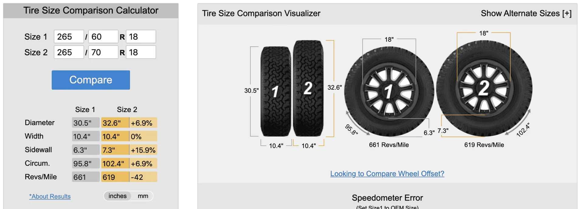

Now I'm trying to figure out the largest size BFG KO2's I can upgrade to without further modifications (spacers, crash bar, etc) and without rubbing.
I'm currently running stock 265/60r18.
Does anybody know if the 265/70r18 will fit without rubbing (or any other size that would be recommended)?

No worries - your truck is badass! I appreciate the feedback. It seems like the 265/70r18 should be fine although I may opt for the 265/65r18 anyway. I'm kind of trying to keep the stock look while giving it a little bit more edge (without going overboard).

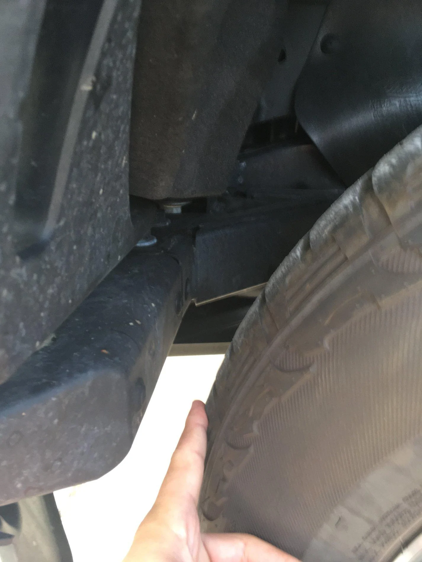

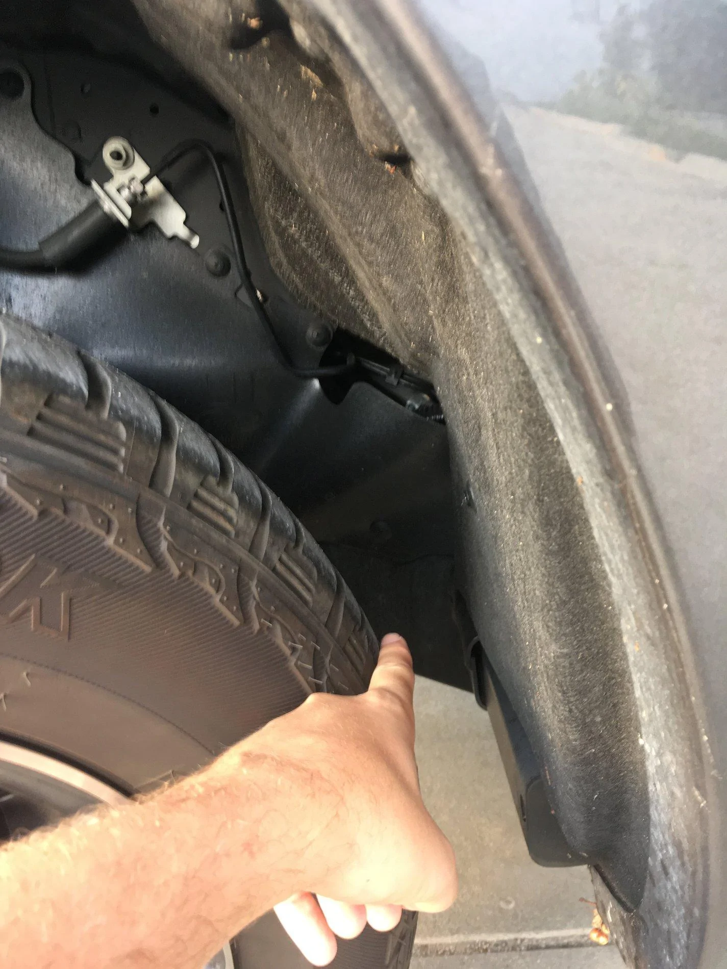

Anyway, here are some pictures I took this morning with the stock 265/60r18 and 2" BDS lift.

I'm thinking of going one size up to the 265/65-18 too. Picking up 1.1" tire height.

Just to add add'l complexity to the equation:
I'm also thinking of going with with the 275/65r18 size which is almost 1/2 inch shorter than the 265/70r18 but almost 1/2 inch wider...
