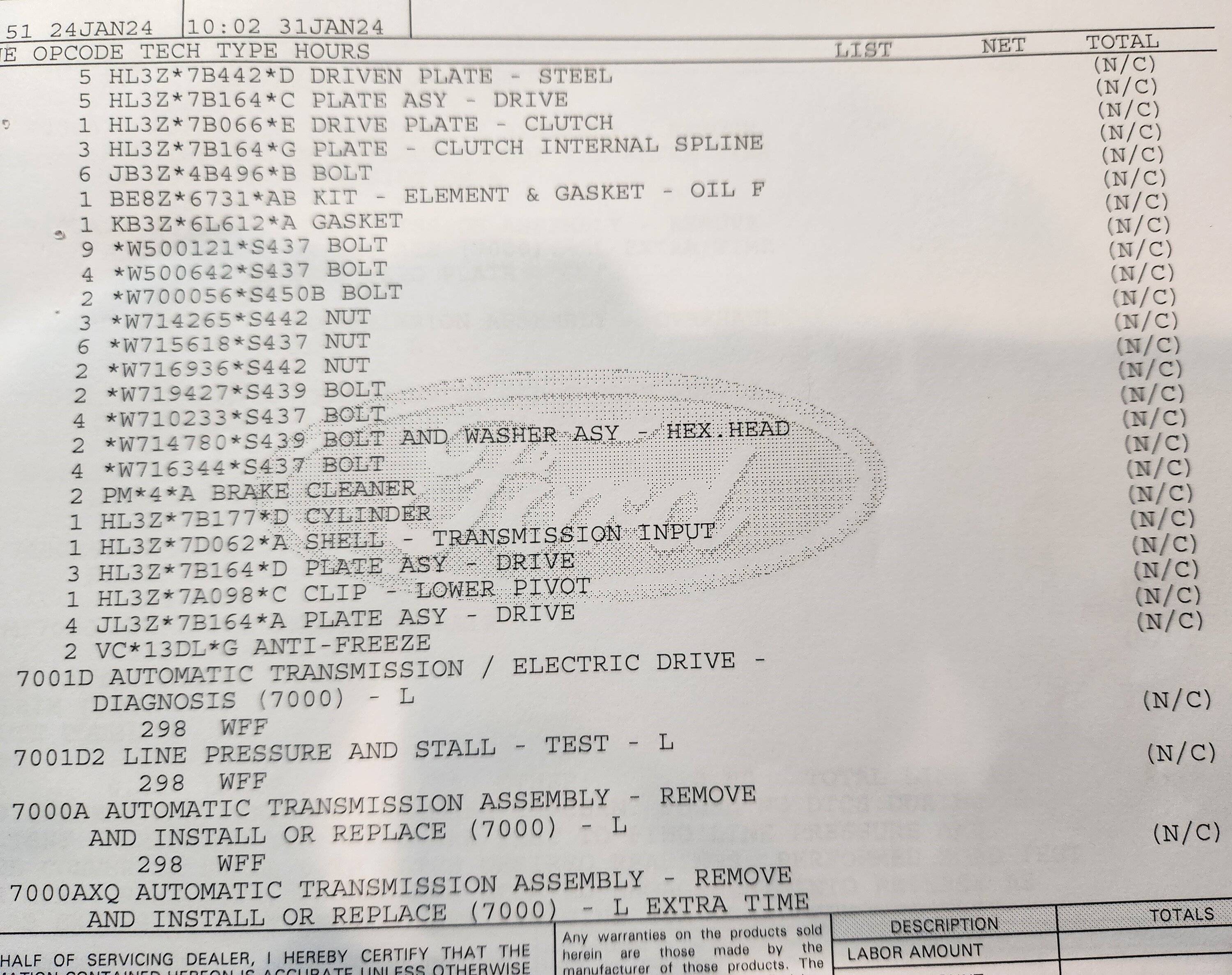

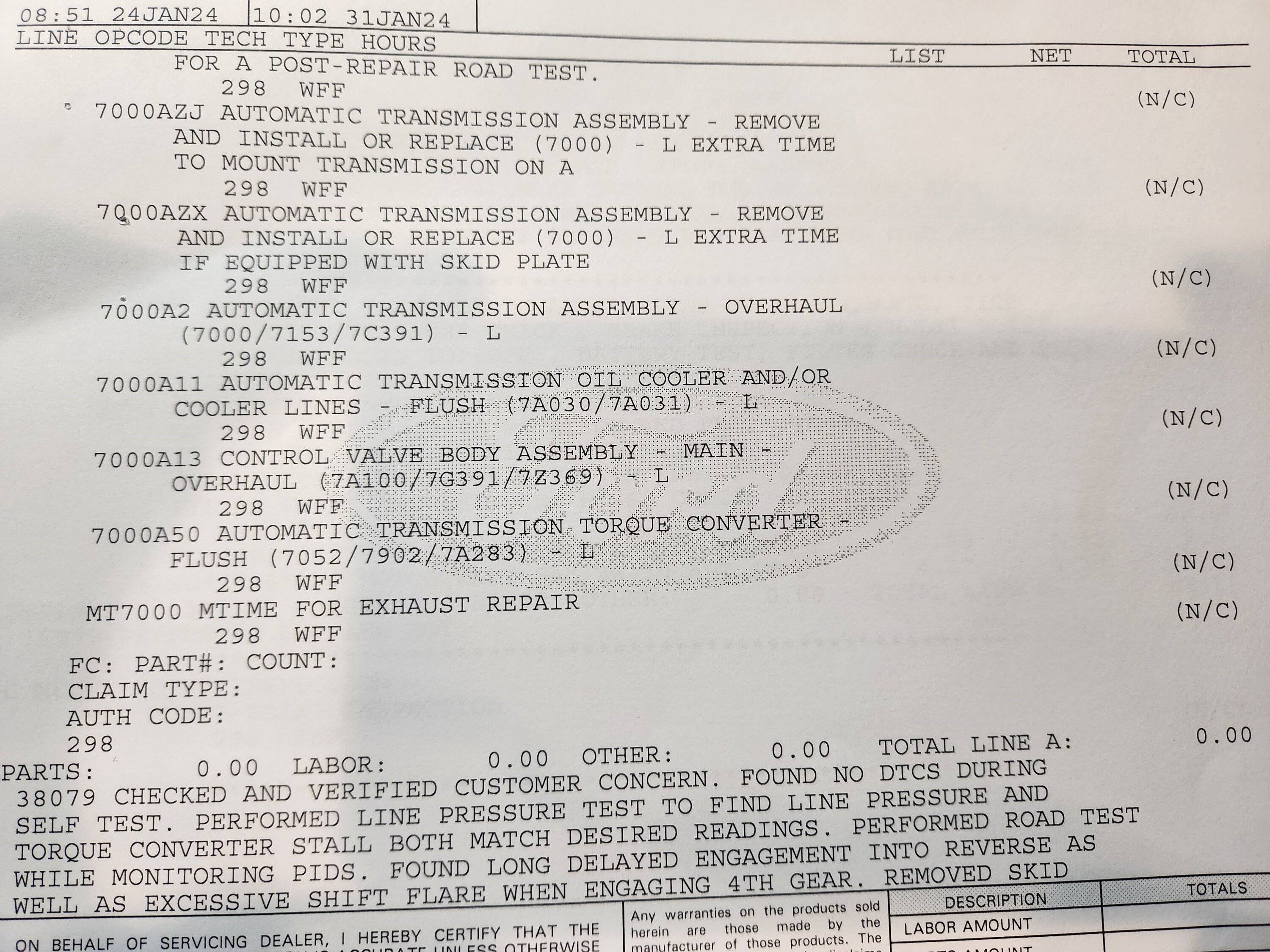

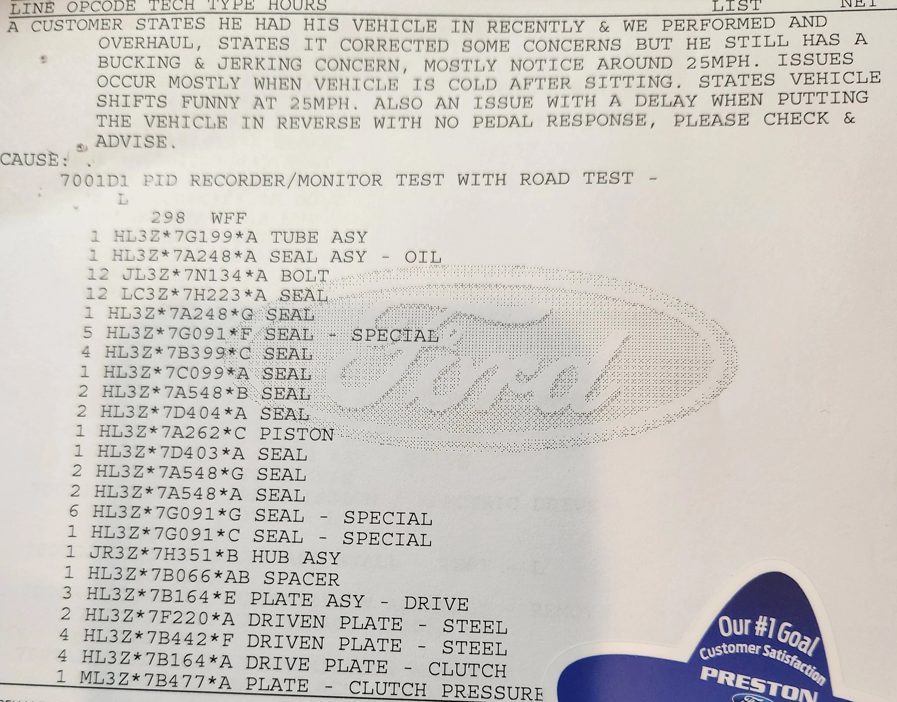

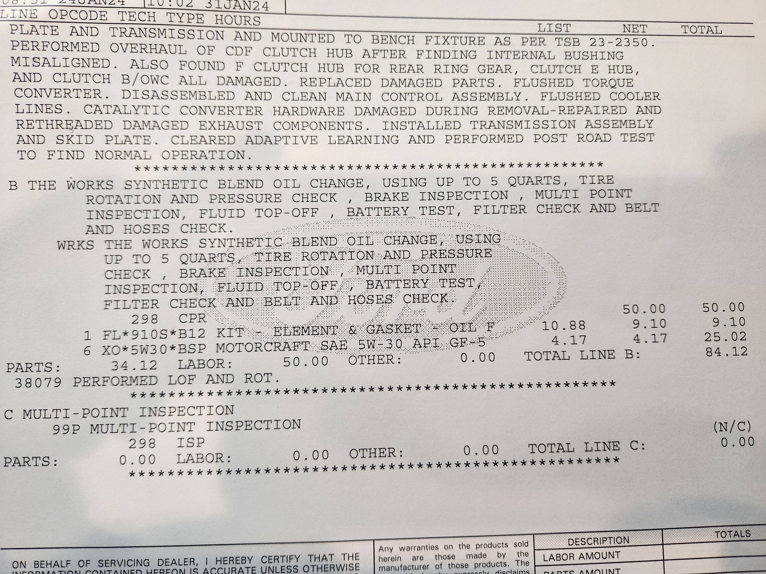

(FINAL?) UPDATE:
Just got my truck back. See pics.
Felt great driving home. Completely different. Smooth.
Buuuuut, I was in this spot once before (after the valve body overhaul). I'm optimistic, and it really does feel great, but obviously the next few weeks will be very telling. Maybe I'll take a road trip to give it a good test!
Fingers crossed the issue may be behind me!
Also should give credit to Preston Ford in MD. I took it to them twice, and they found something both times. I did not get any kind of blow off or resistance vibe with them like I've felt elsewhere. I'll be going there regularly from now on.
