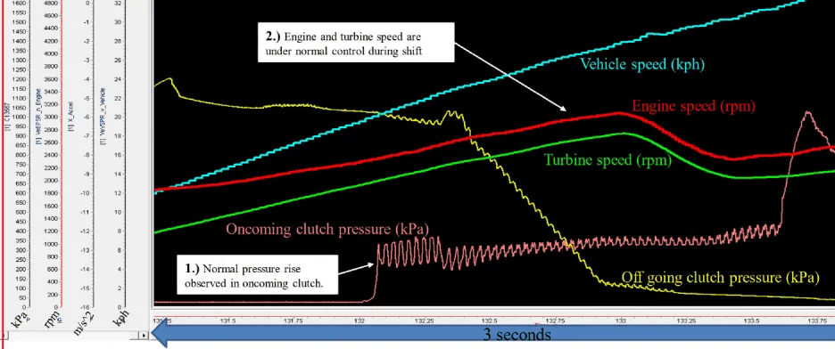

I'm basing some of this off of some of the charts in the unsealed GM 8-speed lawsuit. Even though the transmissions aren't the same, I suspect that most modern TCM's control at least somewhat similarly.
Sonnax is already on top of the problem of low line pressures as well:
https://www.sonnax.com/parts/5619-main-pressure-regulator-valve-kit
From the lawsuit as an example. (Yes, these are clutch pack pressures and not line pressures).
I monitored my pressures even with both the adaptive learning on and off and they were all over the place. It is crazy.
