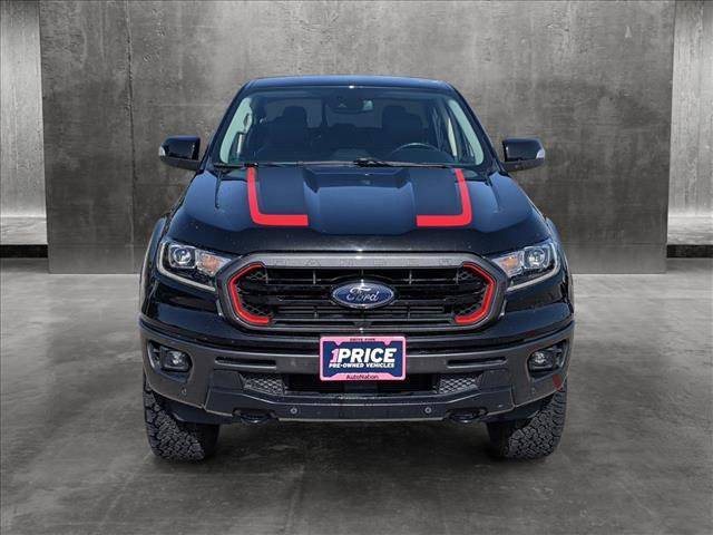

Thanks for the info. Looks like mine was a DEC '21 build. It has 35k on it and I saw a video of it running and it seemed ok, I'll get a better look when it shows up. No mention of ASS on the window sticker, I'll check on the struts. These are the headlights, I think they are the LEDs?

Those are LED, it may have been a dealer order for their lot, if so it will most likely have the ASS (Auto- Start-Stop)
