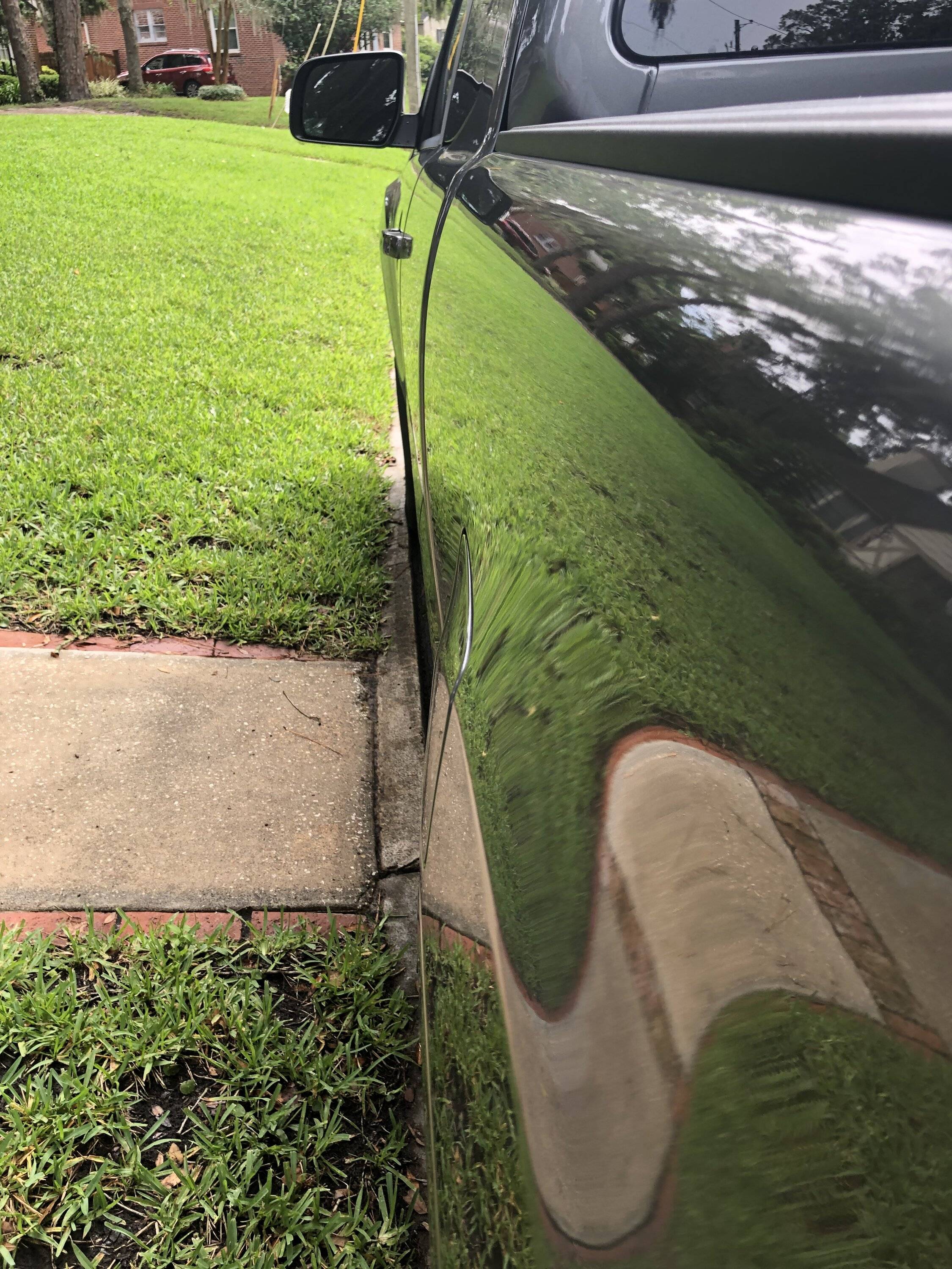

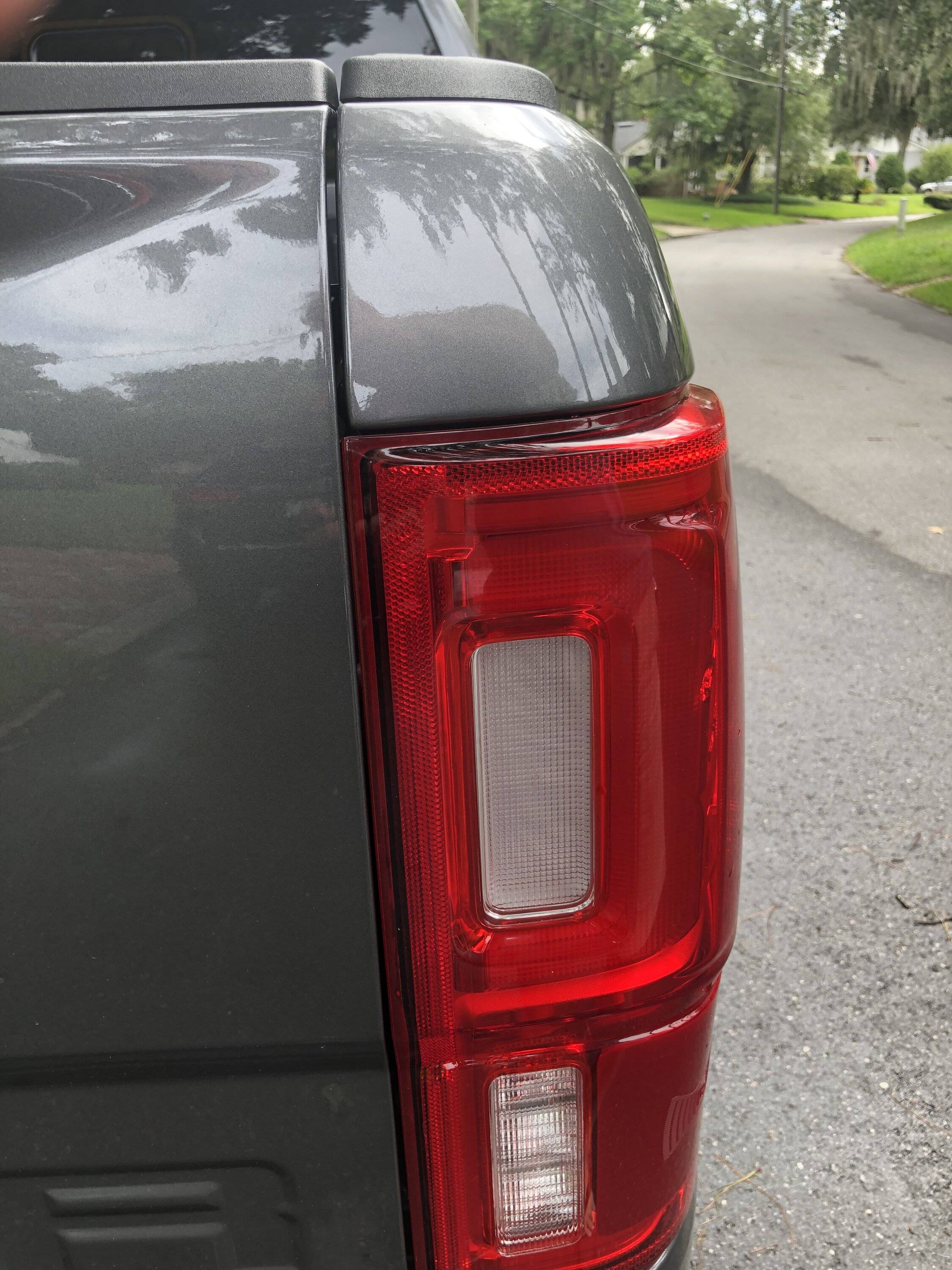

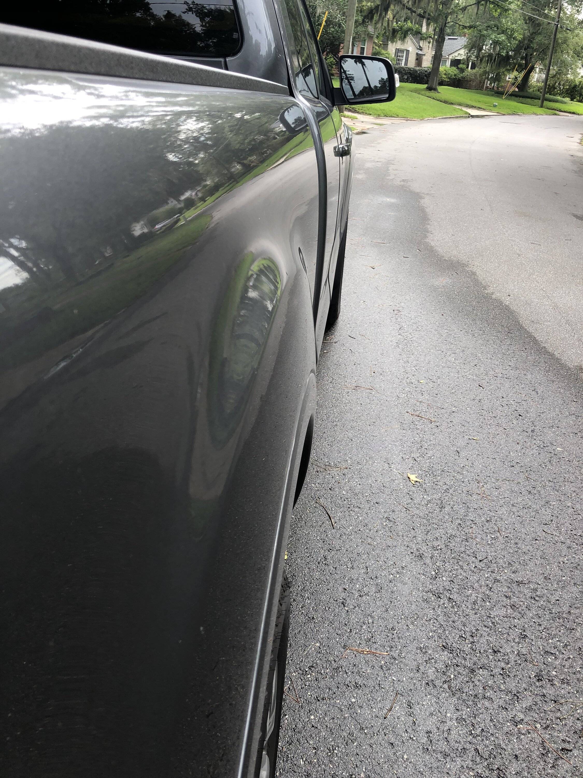

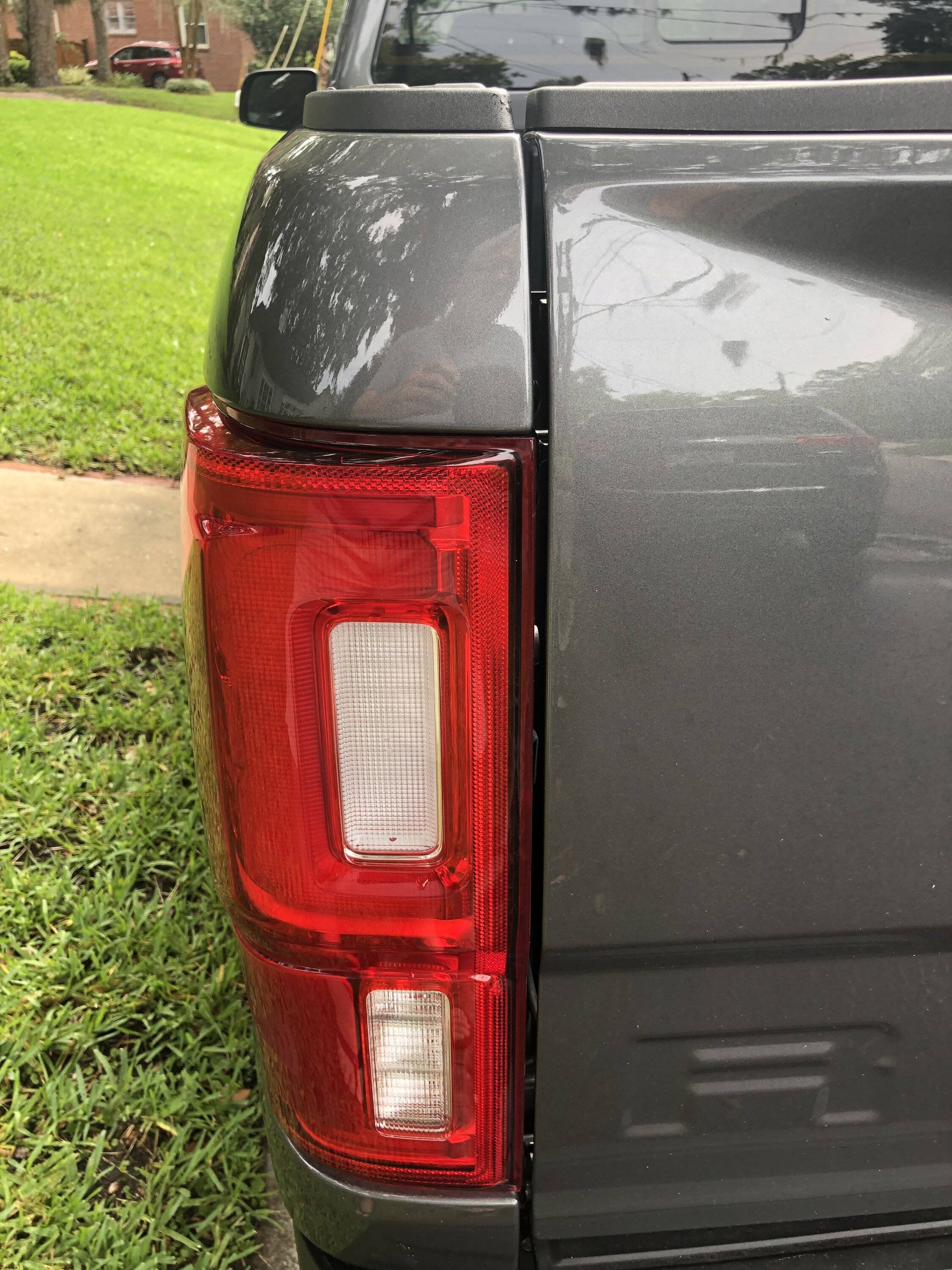

Body shop originally said they couldn’t fix and said no one ever noticed. Said the f150’s had this problem too. Can’t tell you if the bed or the cab was aligned.
Service rep didn’t know.

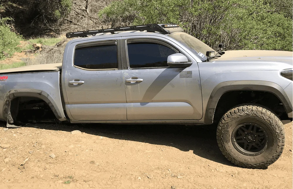

Sadly that's a brand new 2022 on the dealers lot that's for sale right now. ?
Progeny2021
Joe
Oct 20, 2021
1,211
2,689
Charlotte, NC
There's another image floating around of a nearly new Tacoma that lost the rear differential/springs on a California highway - I would be unhappy for sure.....:sunglasses:

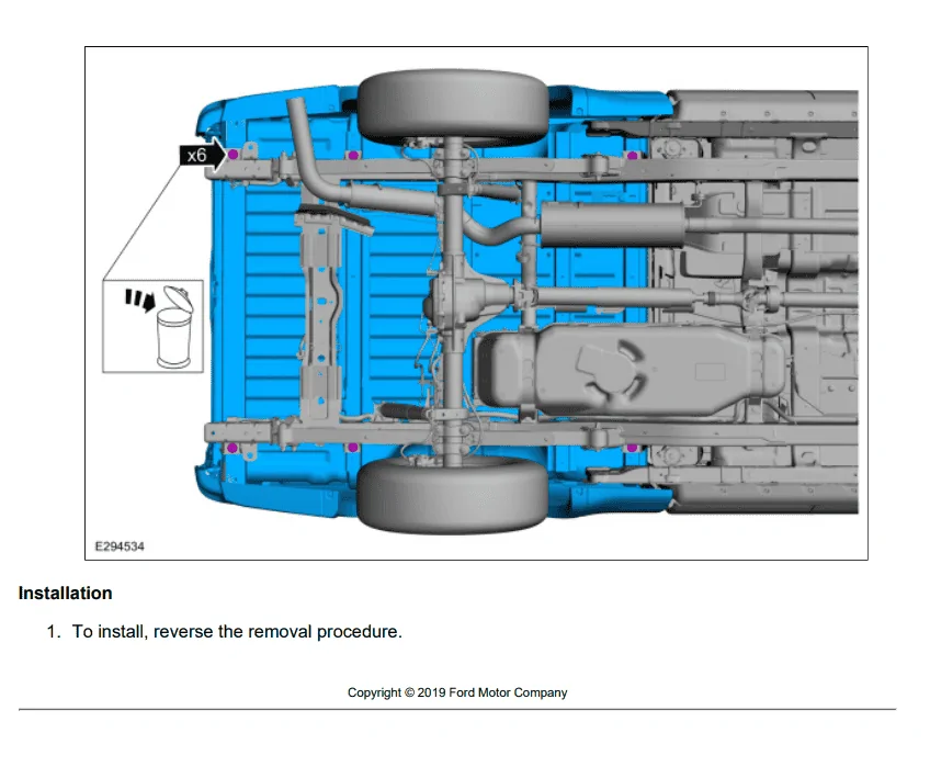

there is 6 bolts.
they are listed as one time use
but you can see how easy it is to crawl under there after 2 beers....cuss for an hour, have two more beers as you push it into alignment with a buddys help. (might even be easy to just use an alignment punch if you have no budds)....and then get back under there with two more beer and tighten them back up.
what better way to spend a sunday morning instead of going to church.
Pretty sure there is another thread on here relating to this issue.
I have a SCAB that the bed is offset by 1/2 inch. I was looking into correcting this myself and then came across this image. Then looked up the service procedures. See that trash can with a nut going into it. Well if you crack the nuts to move the bed you’re supposed to replace them. Seems the torque amount stretches the threads enough so they want them replaced. That’s when I decided, it’s fine, I’ll live with it.
