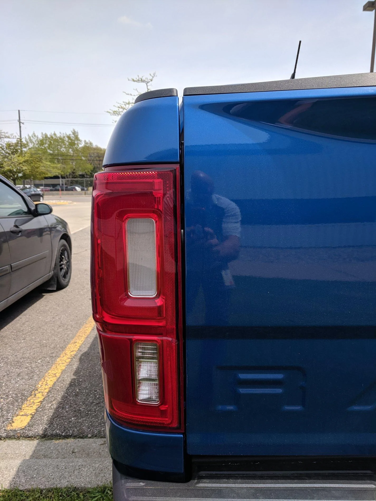

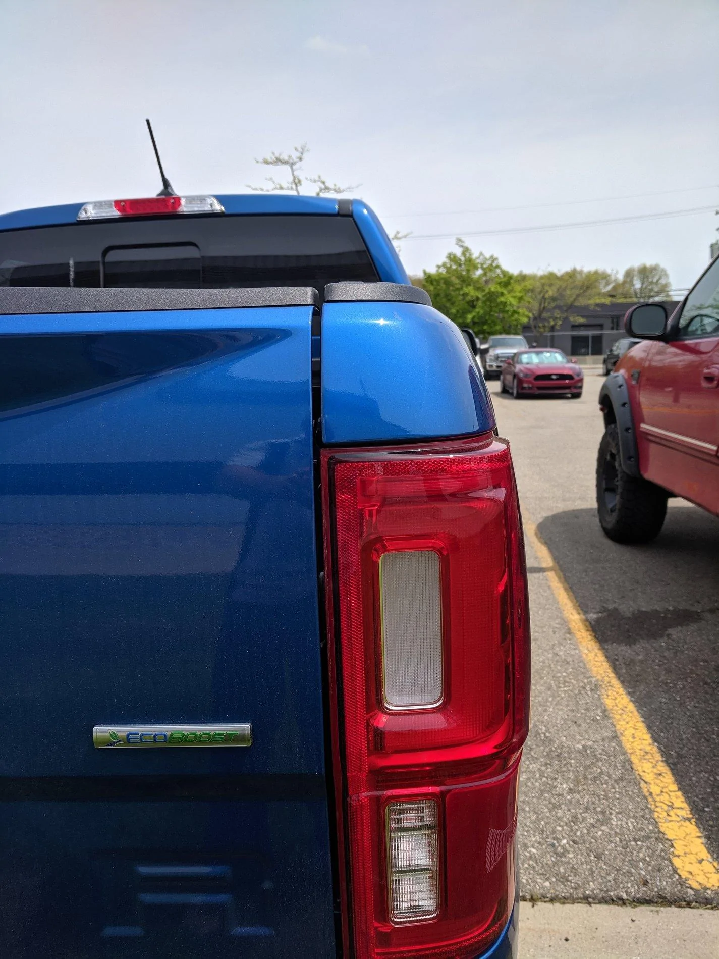

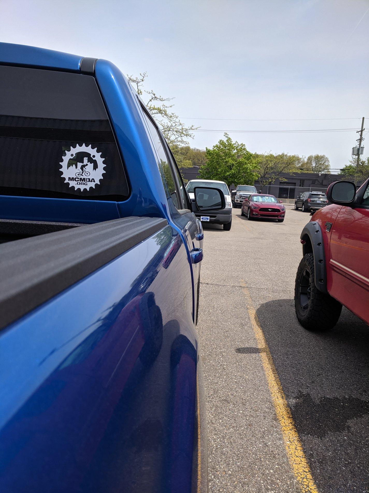

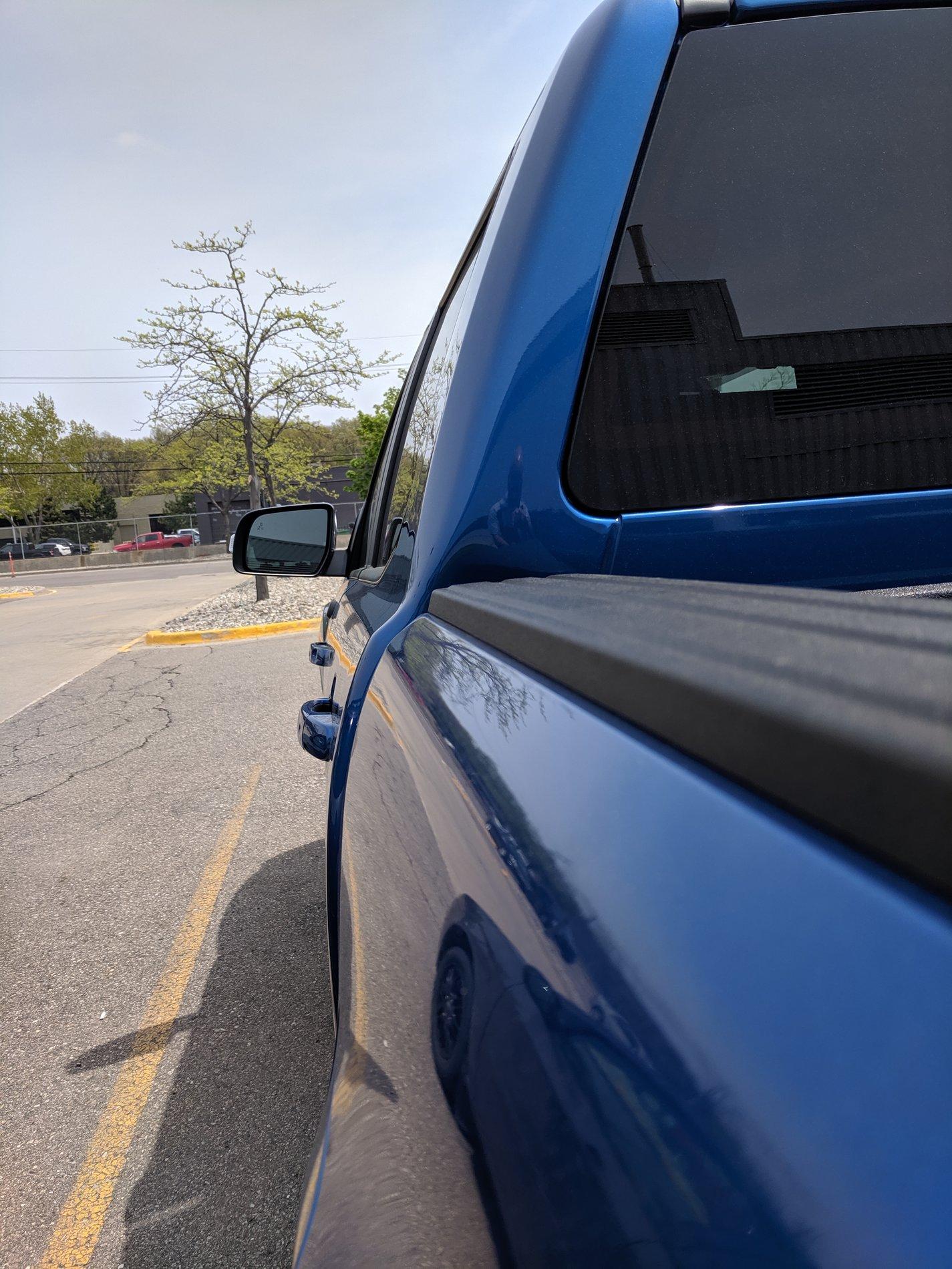

Has anyone else had this issue or had it fixed yet? Just noticed today that mine is almost identical to this; my bed favors the passenger side by about 1/2". Probably an easy fix, just seeing if anyone else has tackled it?
Mine also has that issue. Havent talked to dealer yet.
