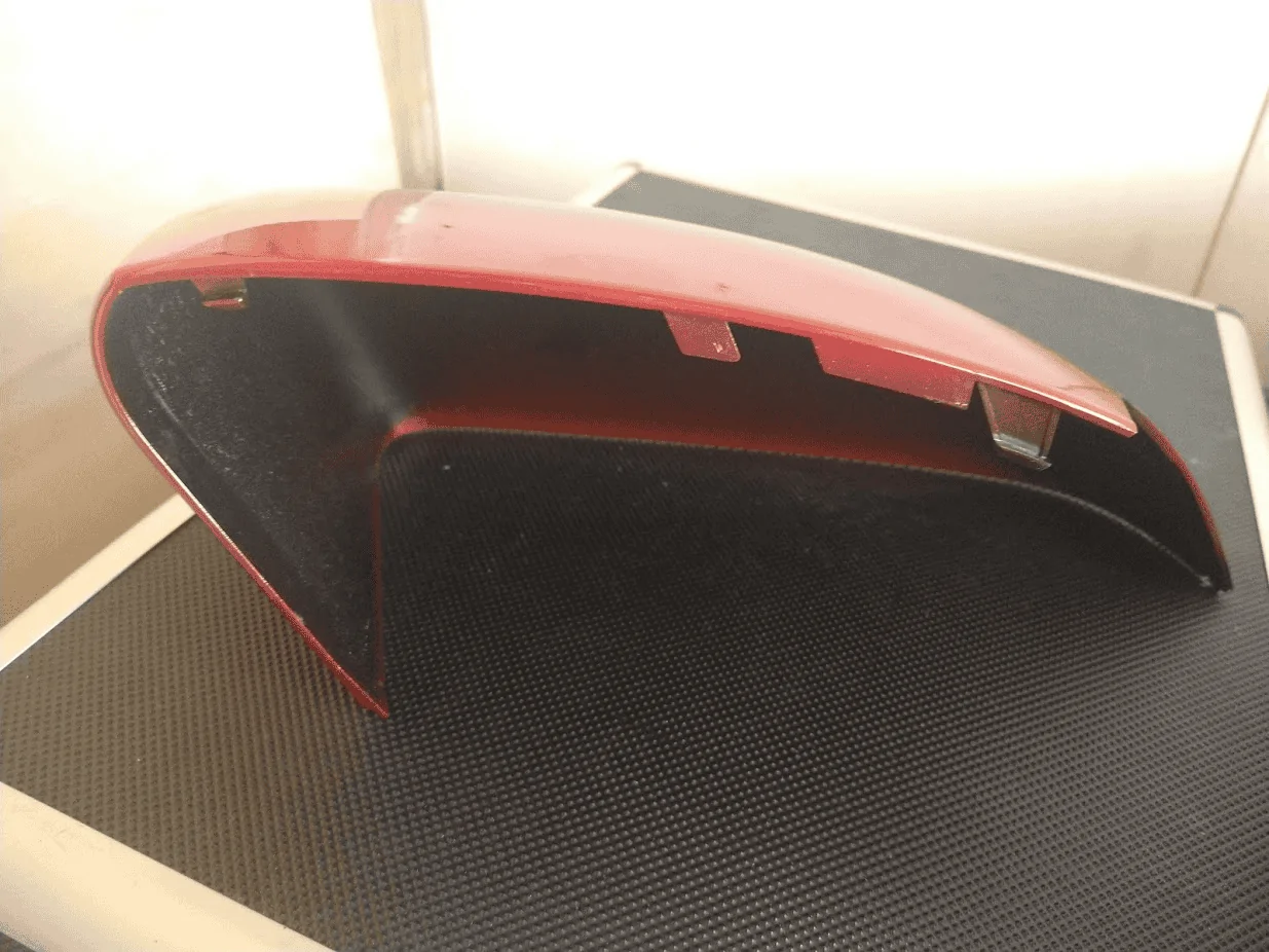

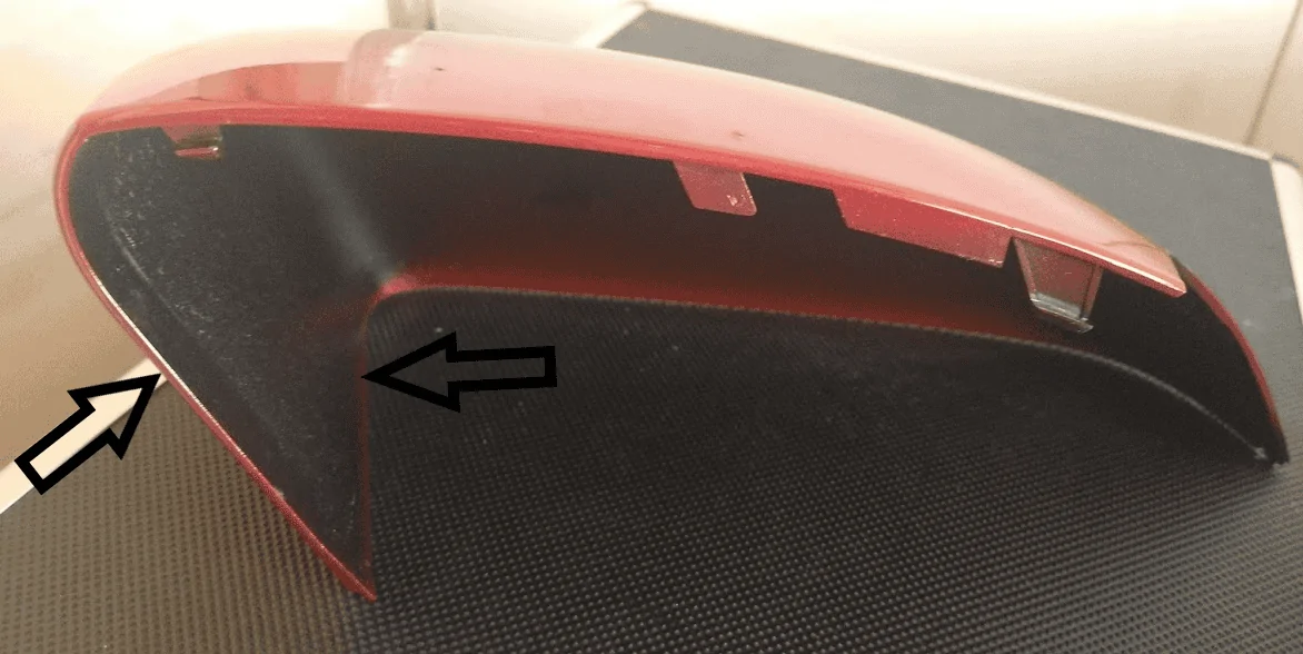

Bit late for the info on cap removal, but here you go:
I'd suggest using a plastic or wood spudger instead of the metal screwdriver i used, but i dont care about cosmetically damaging the mirrors in my case. The second time i break out the screw driver in the video it was not needed (I thought the bottom clips might have been engaged still), you just have to pull at the correct angle, gently wiggle it a bit.

You need to start at the outside top edge of the cap prying at the seam with a trim tool (plastic). Work your way towards truck slowly, top should open for you, and it will come off. That how I got mine off 2019 Lariat.
