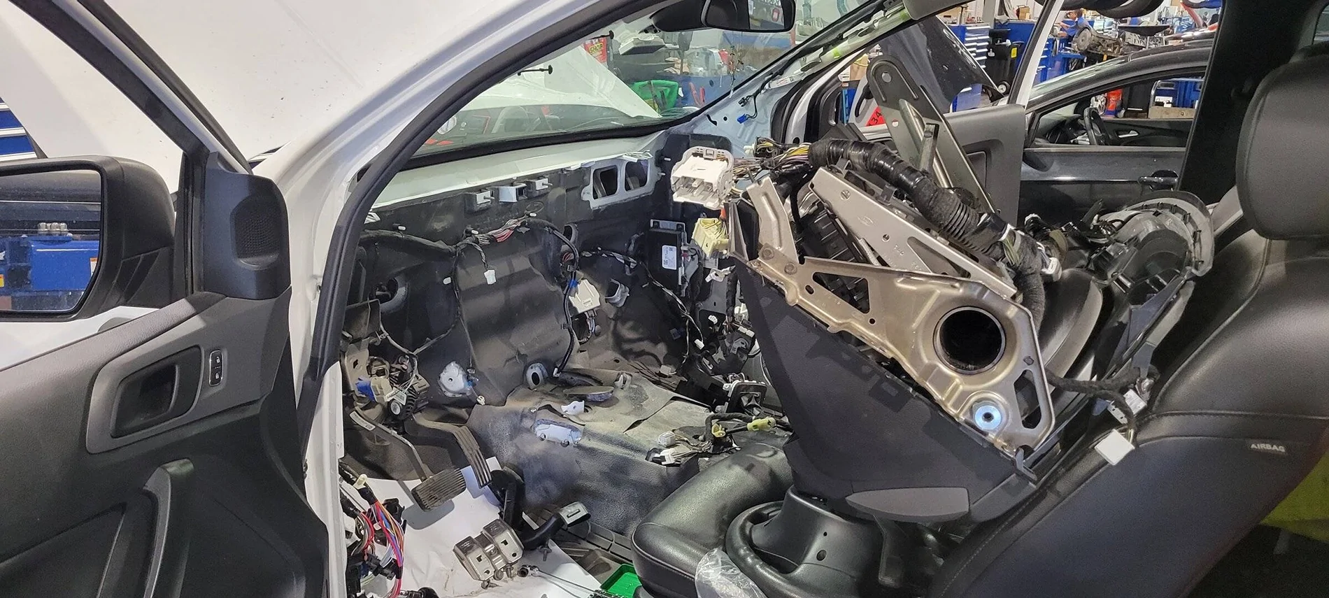

Keep in mind that’s 10 hours with all the right tools, resources, expertise, manuals, and training. I’m not saying it’s impossible to do but pulling the dash completely out and flipping it upside down onto the seats is a daunting task.

thanks guys. i can send that check list to my guy. The pic of the removal is deff worth a 1000 words. Deff cant afford to try and do that on my weekend due to using the truck for work.
