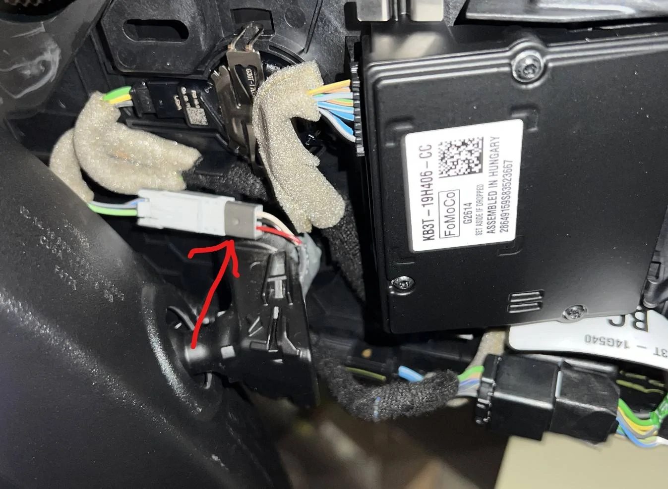

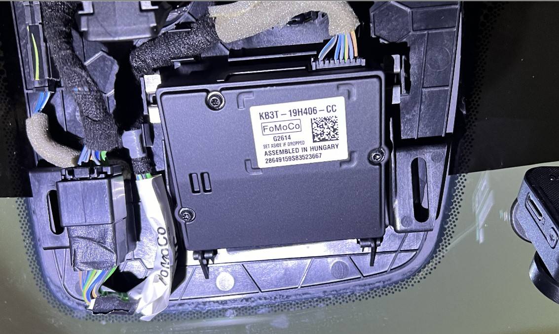

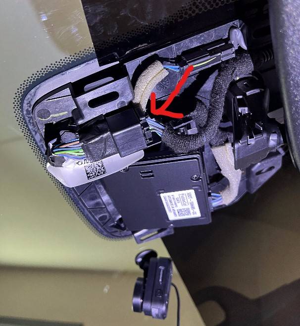

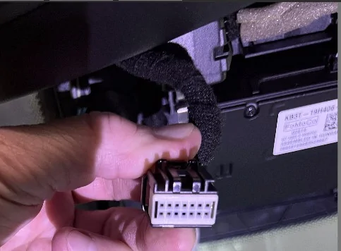

Does anyone know which shop manual or tech drawing will show the pin out for the rear view mirror plug for the 2019 Lariat? After downloading a ton of these, I cannot find any that have the pin outs for the mirror plug.
Background: I have been waiting for Dongar to offer the 14 pin USB adaptor for my dash cam, but they still do not offer it. They do however offer a 2 pin universal where I need to find the 12v an ground wires on the mirror plug. It's not a great solution, as I have to stab the two pins into the back of the plug and hope it stays there. Yes, I can sort out a volt meter and try to find it, but if there is a pin out drawing, it would be much easier.

You don't want to tap for power there that is the inline connector for the IPMA. only has a 7.5 Amp fuse protection.
If you follow that connector, you will see that it routes over to the IPMA Module
Best to use the connector for the Auto Dimming Mirror - Protected by a 15-Amp Fuse 12-Volt Power Source
Before you make it permanent, I would back probe for power and ground and then try it for operation.
The Ranger gets finicky when tapping for power.

Oh wow, I thought that was for the mirror, thank you for letting me know.
Looking at my picture, which one is for the auto dimming mirror? I only see two connectors.
I thought the other, larger connector was for the forward camera module.

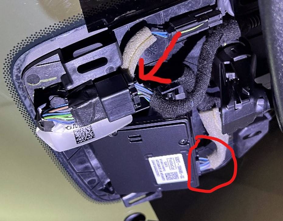

I found another connector behind the mirror. I had surgery recently so I'm a one arm man and this isn't easy. This looks like either a 3 pin or maybe a 5 pin. Is the mirror dimmer connector that I should tap into?

That should be it.
FYI - The power to the mirror is not full time, it only powers when the Run/Start Relay is energized.
So, with truck off, power will drop off.
The power feed for the Auto Dimming Mirror is shared by the Exterior Mirror Control Switch
So, if you can adjust your exterior mirrors, you will also have power for the cam.
FYI-The other 3-wire connector in the Pic is the - Rain Sensor

Instead of splicing for power
Here is a adapter.
Click the video link on the Amazon Page for a Ranger Install
Amazon.com: Dongar Dashcam Power Adapter (3-pin Type B) for Select Ford Vehicles. Compatible with 2019+ Ford Ranger, and More. Built-in USB Power Source, Connects to Rearview Mirror, Easy to Install : Automotive
