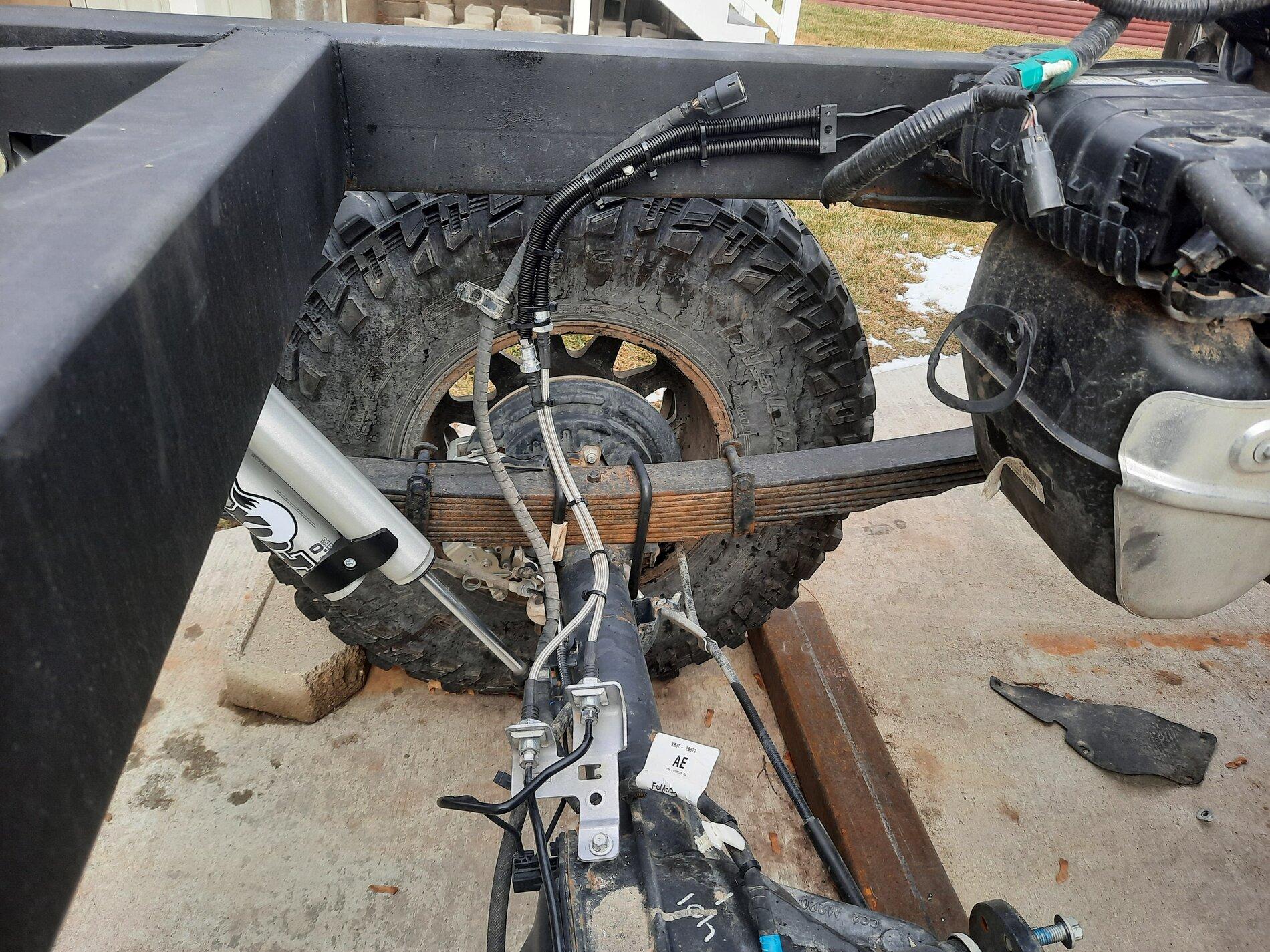

Custom brake lines for the rear. Was able to use some extended raptor brake lines. Ford uses a really uncommon 10x1.5 thread and none of the places that build custom brake lines had anything available.

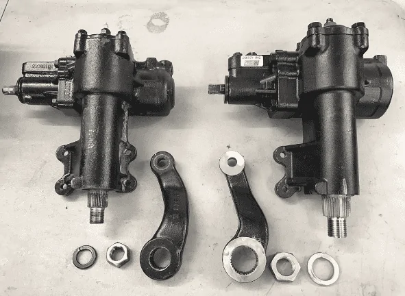

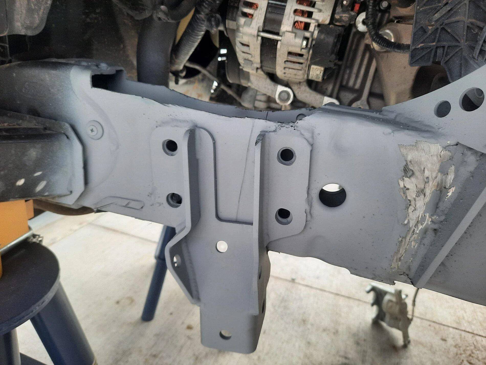

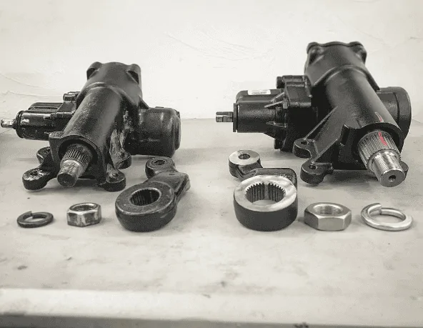

Not a lot of room to mount the steering box. I originally bought a PSC XD2 box made for a Jeep JK, but no matter what I do, it hits the alternator. PSC is great to work with and is trading me out and sending me a standard housing but upgraded for hydro assist gear box. Hopefully it fits.
Here's an internet photo of the difference. I wish I could have used the larger box.
