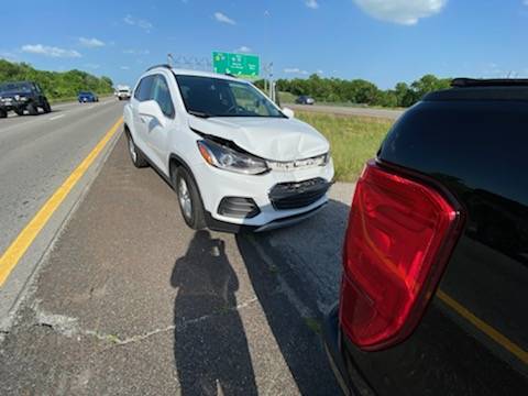

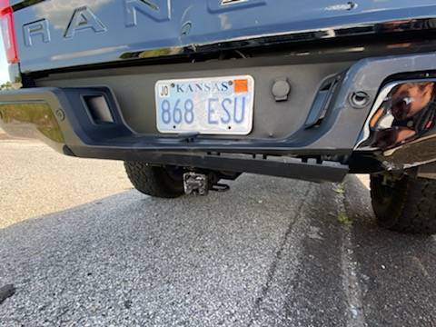

Her airbags did not deploy hit squarely on the receiver hitch of the truck. She stated the last time she looked she was traveling 45-50mph and did not hit the brakes before she hit the truck. Said that the sun she did not see anyone stopped.
Given those photos, I highly doubt she was going 40MPH when she hit. There would have been a LOT more damage, especially to her car at 40MPH.

Looks like she was hard on the brakes an was in a nose dive when she hit the ranger. I hit someone like this, The only accident I've ever been at fault in. It did far more damage to my van than it did the van I hit since my bumper went under his an his bumper hit the grill radiator support area.

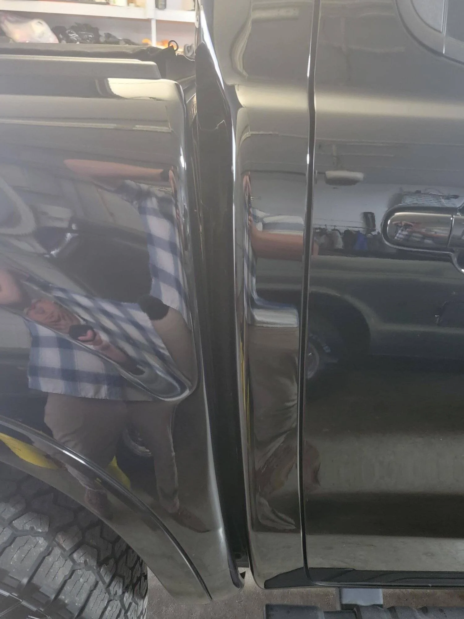

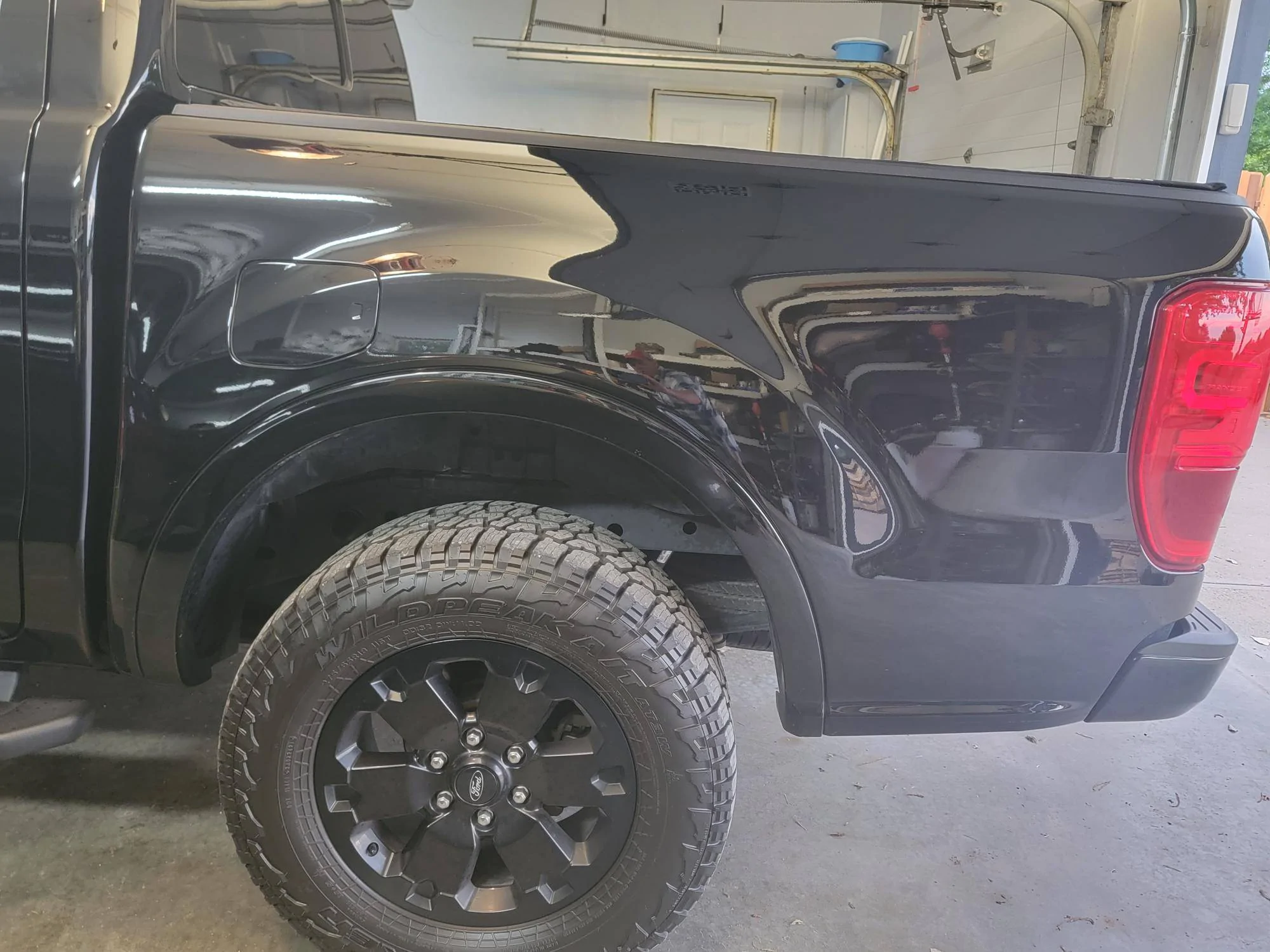

Glad everyone is ok first and foremost. Looking at pictures of gap between bed and cab, it appears the frame is bent somewhere near the back of the cab or front of bed. Gap a bit wider at top than the bottom. If they fix it, I'd push for a replacement frame.

Wife was rear ended Thursday night car that hit her was going 45-50mph. The frame of the truck is bent where the receiver hitch mounts.
Any familiar with a total for frame bent? Bent on both sides about half an inch.

Figured I would update everyone.
Dropped off at Ford body shop for repairs.
When they looked at it they also stated it was a higher speed impact over 30 mph and stopped to ask if everyone was OK.
Frame bent on both sides. - replace
Bed - replace
Tailgate - replace
Bumper and receiver hitch - replace
Right rear taillight - replace
All Ford parts.
