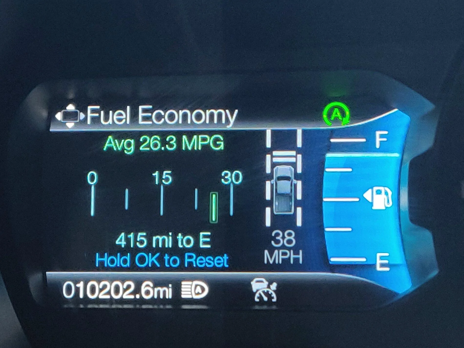

I have never heard of this issue nor seen it on this forum...like the other post said I am sure a Ranger with an issue could cause such a problem but mine seems perfect. and with 26.3 MPH, I suspect my gas is not leaking into the oil.
