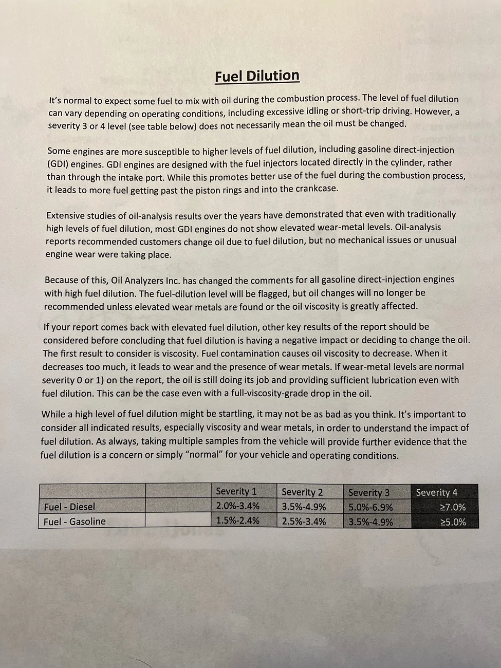

Update. Visit to dealer was semi productive. Expressed my concerns with my service advisor who knows me quite well from us owning two Ford vehicles still under warranty. He heard me out and wasn’t sure what they could do. He asked another advisor if he had run into this situation before. He said he had not and explained that without a run ability issue or codes there wasn’t much they could do. He suggested I contact Ford to see if they would open a case for my issue. They gave me the phone number and also a sheet that talked about fuel dilution ( see attached). I called the number and was connected to a representative. They listened and then admitted that they had no mechanical experience. So after multiple attempts to explain the situation in layman’s terms they finally seemed to get it. They issued me a case # to initiate steps to look at my issue. I printed off my oil sample results, oil change history with detail, a copy of their oil dilution sheet and a short letter explaining in detail my issue and concerns. Dropped it off at the dealer and was told that the service manager had received notification of the case from Ford. So with my documentation they would contact Ford warranty to see what the next step would be. We’ll see what happens.
PS According to their sheet I’m at severity level 4 with noted viscosity loss with only 300+ miles on my oil
