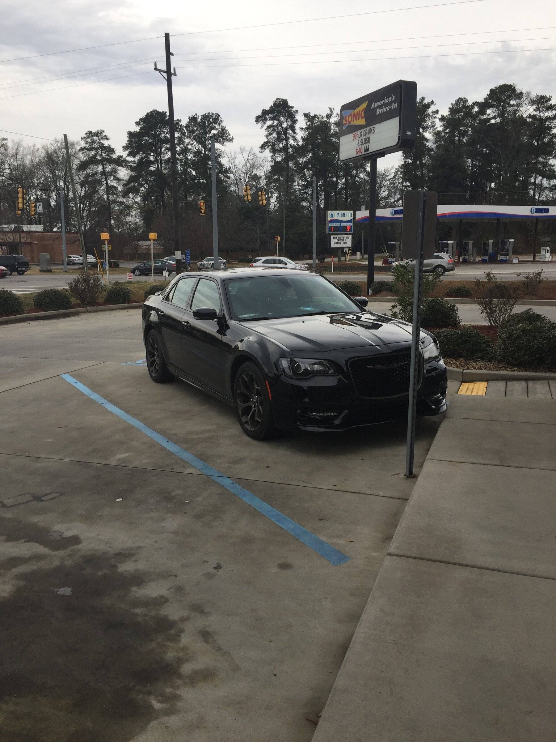

My Ranger has been flawless to date as all 3 previous Rangers I've owned going back to 1988.
Regarding my 2020 Chrysler 300S, I was seriously considering buying the extended warranty when I found out there had been issues with the 5.7L motor over the years. Otherwise, the power windows seem to be the other 'issue'?
The 5.7 had problems with the valve seats initially, then with the timing chain/gear when MDS was introduced. Then, it was cam/lifter failures. Updates/recalls have corrected these issues for several years now. Valve seat detachment was a manufacturing problem at the mexican engine plant. The timing chain/gear was an unsuitable design for the MDS setup, while the cam/lifter failures were attributed to owners using the incorrect viscosity oil, poor quality oil and/or not changing the oil at the prescribed intervals.
Properly maintained high mileage motors have been disassembled to find immaculate or near immaculate valve train components. Enough potential buyers were concerned about the 5.7 reliability that my selling dealer gives a free lifetime limited powertrain warranty to the original purchaser. Go to the 300 forums and you'll find people who bought their cars new years ago, bought the extended warranty and never used it.
I feel good about the 300 going forward, as I do the Ranger.
