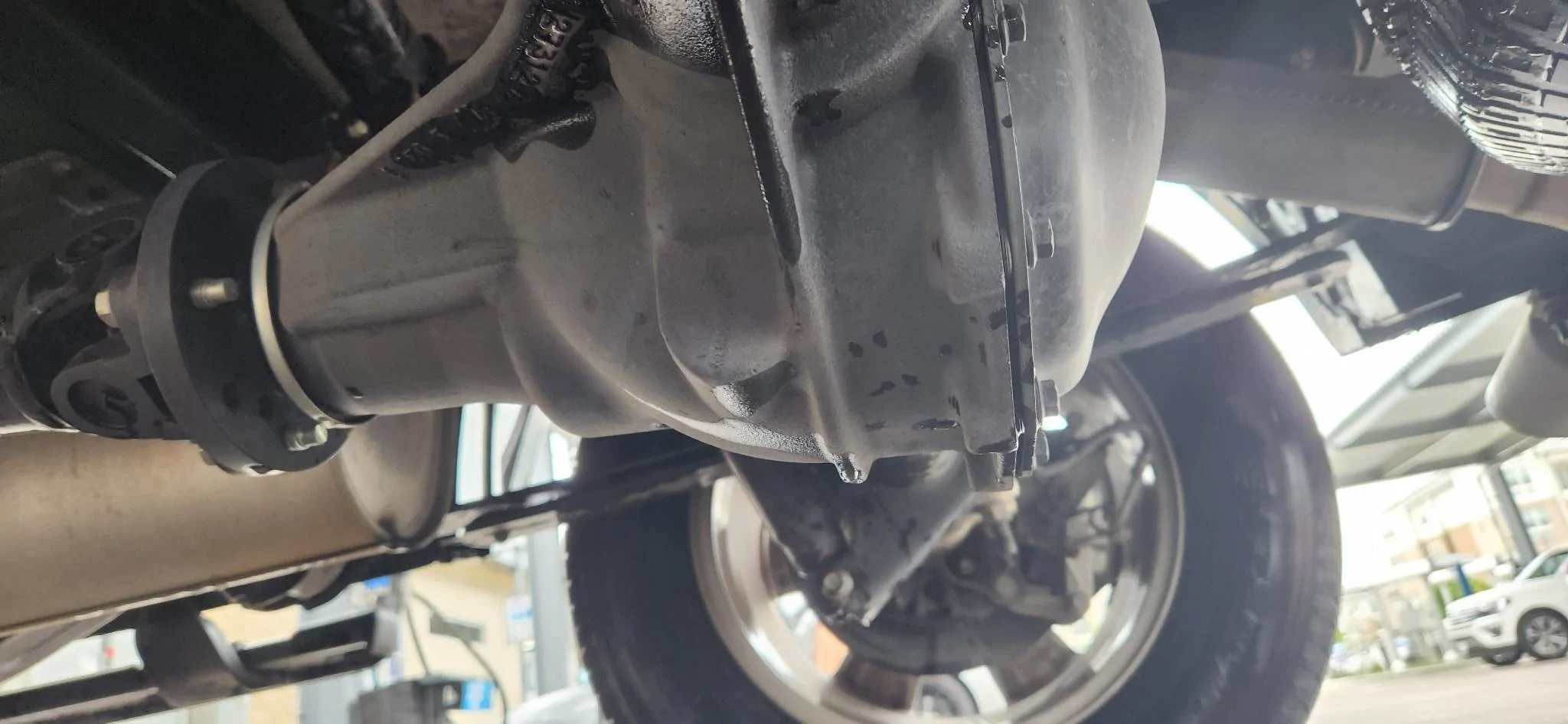

Step One :
-Park on a relatively level surface.
-Locate and clean around your Fill/Drain plugs (if equipped)...Some model years do not have two plugs unfortunately. :frown:

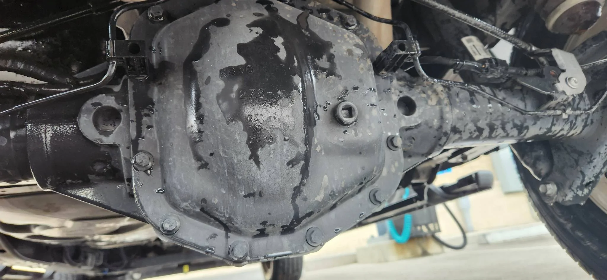

The FILL plug is located on the rear differential cover facing the rear of the vehicle. The DRAIN plug is located on the bottom left front of the differential.

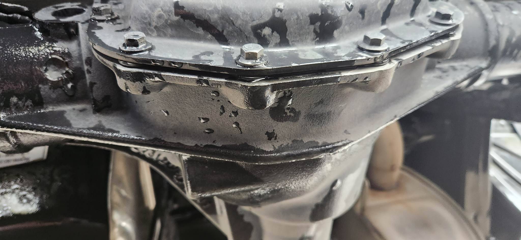

-Use your ratchet and extension/adapter to break loose the DRAIN plug. Since the torque spec is only around 20 ft/lbs. it is easy. I let mine drain about 5 minutes or so until the old fluid was barely trickling out.
-Now you can inspect the drain plug for any gunk (likely will have a metallic goo attached to it) or metal shavings.

Was the drain plug another deleted item? Another 2019 here with both fill and drain plugs.
It was and I should've taken that off mine too. lol
Yep. I do believe reading other forums 21+? had it deleted.

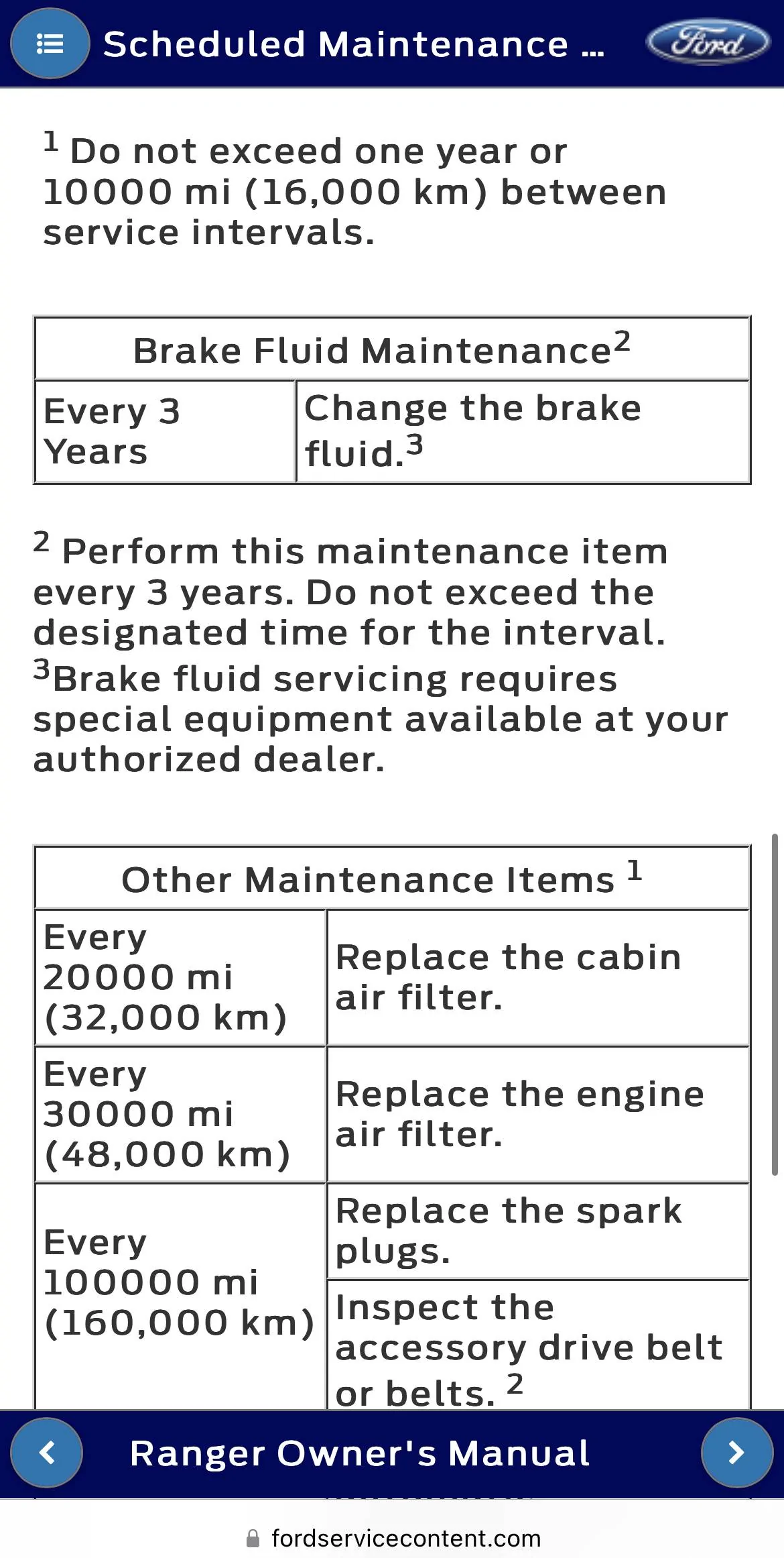

Kind of like there’s no brake fluid change interval in our owners manual but there is in later models..?
Interesting on the brake fluid. How many have changed theirs at the three years? Might have to look into getting it done.

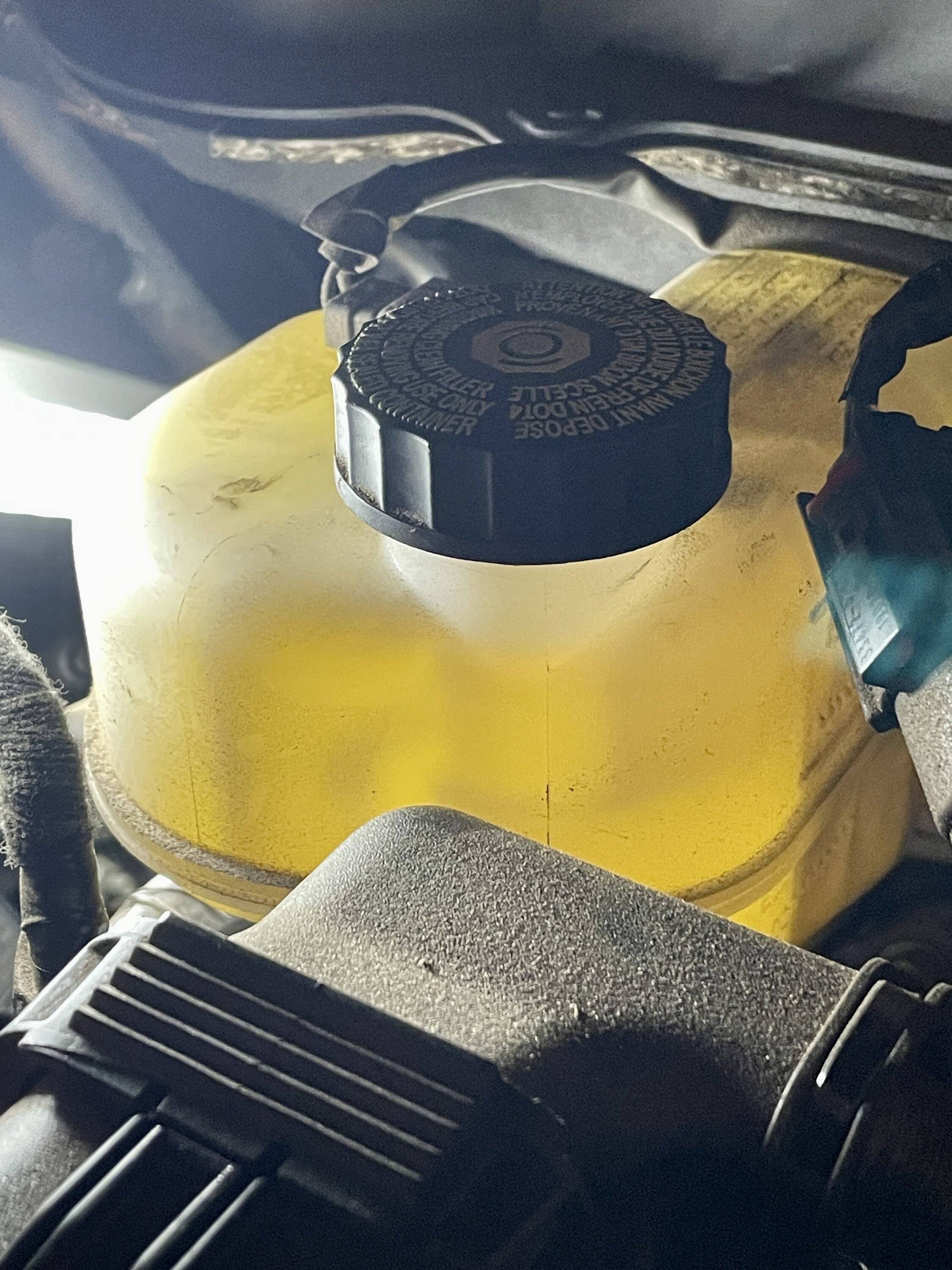

Interesting on the brake fluid. How many have changed their at the three years? Might have to look into getting it done.
I did actually get mine done at the local dealer for $140 the other weekend. 47,000 miles/3years11months since truck has been built.
It’s the one fluid I do not want to fail. ?
I think it went during 21. Mine was almost a 22 going by build date and the drain plug is gone. Some 21s have them I think.

I wish mine had a drain plug... but I guess easier to clean it out / really get the old oil out when I remove the cover.
You sure about that? Drain plugs for both axles are on the housing not the diff cover.
