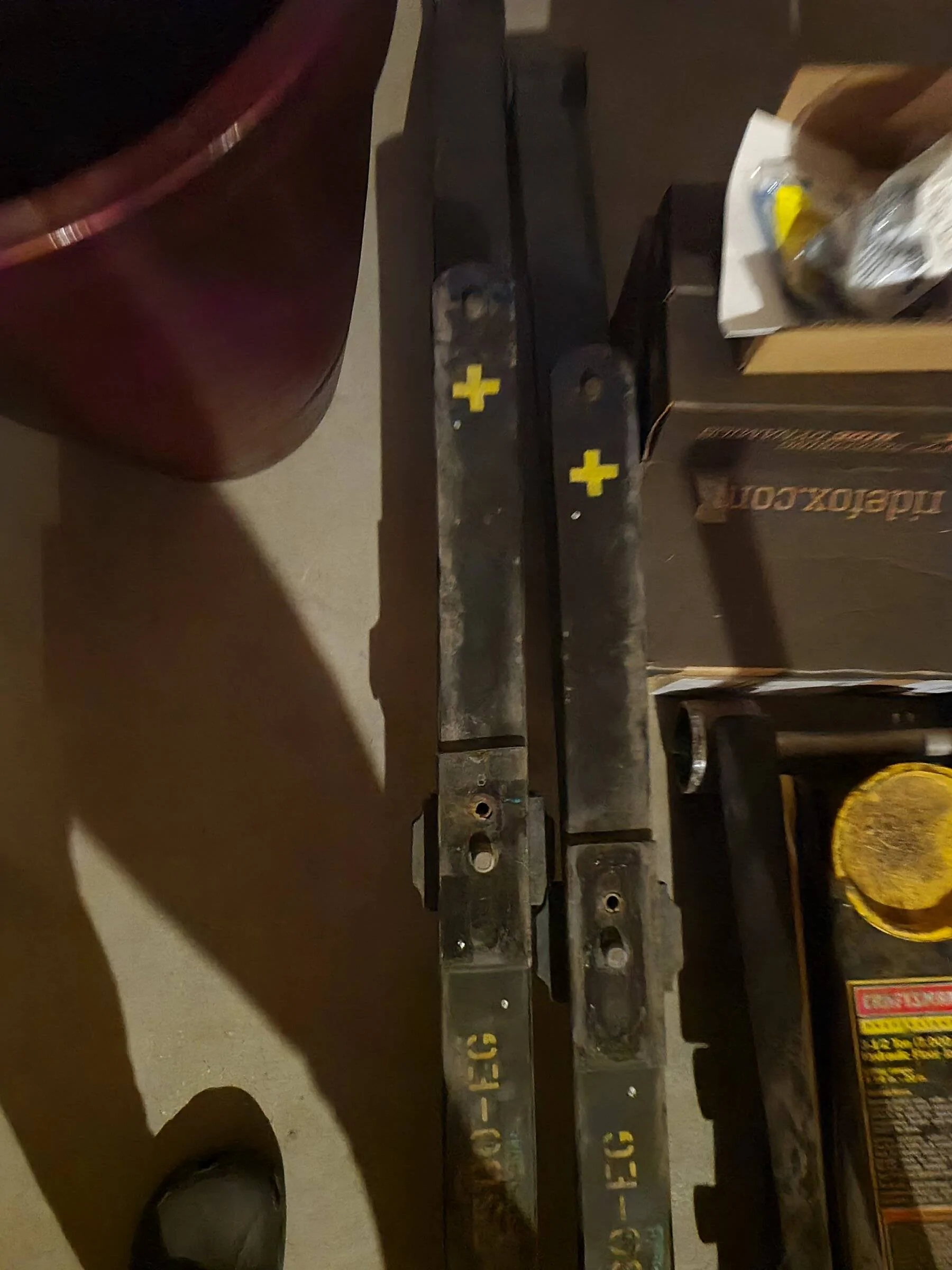

First of all. Calm down, Karen.
Second, check the + and - markings in yellow on your factory leafs. You should have + on the drivers side and - on the passenger side.

Ford marks springs on the taller side of spec with a +, shorter end of spec with a -.
As you can see mine had 2 +s and a factory lean as delivered. My global leaf packs came with the proper + and - and the lean was gone after the lift, shims completely removed.
