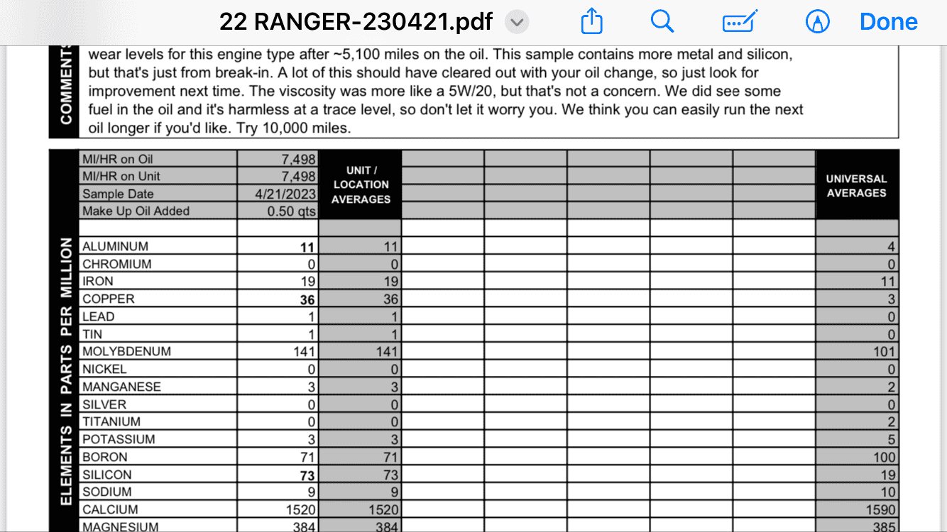

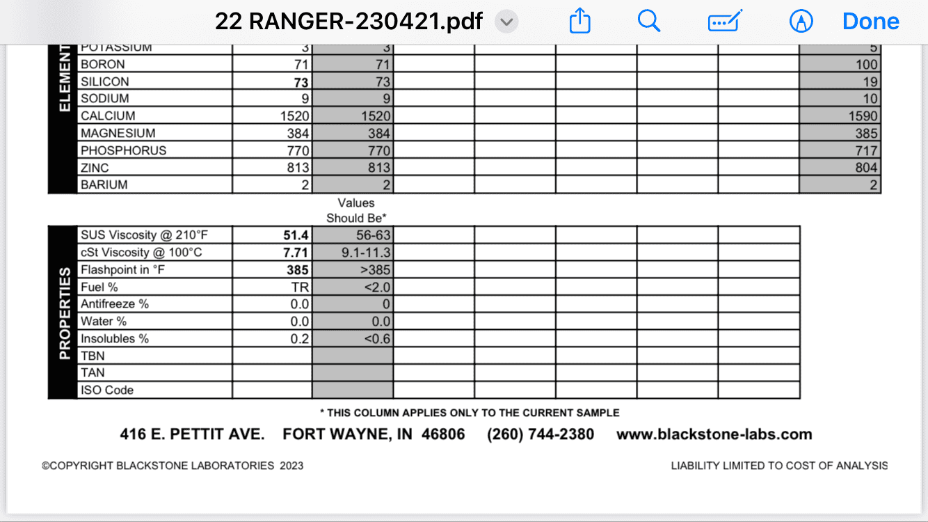

one question how often do you change your oil ?
I change it whenever the oil life monitor gets below 30%. That gives me a nice 3,000 mile buffer if I need to go to somewhere far, like Texas or Colorado.
Here is the Blackstone report from my original oil change, I am still running the first Amsoil fill I did and have yet to get under 30% OLM. Should I change it before 16k?
ccasanova22
Oct 1, 2022
403
456
Lakeland, MN
2022 Ranger XLT Tremor
I am also concerned that my 2.3 EcoBoost appears to be shearing the oil. That is some thin oil (unless the factory filled it with 5W-20 by accident)
