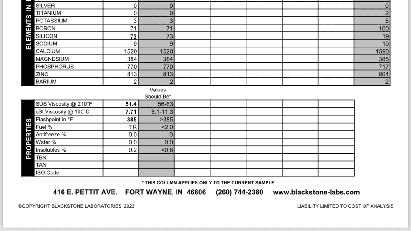

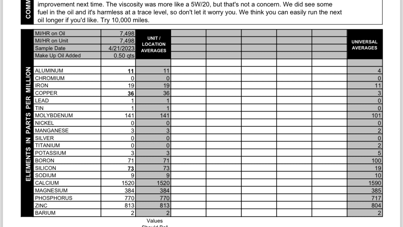

Well I now am seeing consistent oil consumption in the summer months (and oil level slightly rising after some winter use) so will take it in to the dealer. I might pull a Blackstone too, as the last one was done about 7k miles ago. Here is my last oil analysis:
