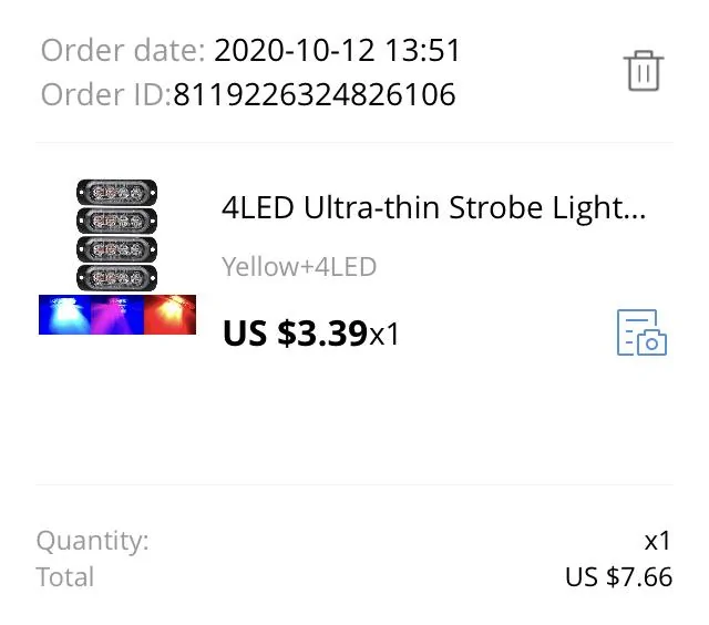

I don’t have the cool signals in the side mirrors so I thought ‘what the hell’! Couple of LEDs from AliExpress and a little wiring. $15 out of pocket. I drive at night every work day so the more I can communicate with other drivers the better

Nice! I just might have to do that. Did you have to remove the vents or were you able to fish the wires through with them on?

Had to pry the vents off. Just go careful with plastic tools.

Great location.. I wanted to add a signal to the mirror but the vent location looks better and easier. ??

Great mod. Do you have a link to the lights?

Awesome idea! I might toy around with it but put the LEDs just inside the actual vent.

I'm guessing wiring it was as simple as splicing off the turn signal wire somewhere?

Yup. Just tapped into the signal wires at each headlight. Feeding the new wire through the inner fender was the hardest part. Easy/fun project overall.
