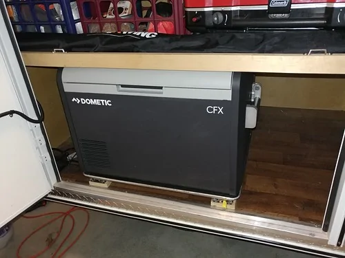

In my camper, I made a slide using Accu-Ride slides (mounted flat) and the tray is an aluminum baking pan. I had to move shelves and stuff in the camper to make sure it fit. Considering that I was tight on space on all dimensions, and I had the door threshold lip to clear, I think the solution I came up with was pretty solid.
For maximum vertical clearance, though, having the slides vertical to either side of the fridge is probably the best. Mount them to a thin metal base and maybe you could get away with 1/2" or so of extra vertical space used up. Not sure if you even have that much space to work with.
You could go with fridge tie-down straps and put footman loops on a flat metal base with a rubberized bottom (like flex seal or similar). Make the base bigger than the fridge so you can put other gear on it to hold it down.

FWIW, mine, as pictured, adds about 1-1.5" of height with the flat mounted slides and the tray (closer to 1" without the wood spacers, and closer to 1.5" with the wood spacers to clear the threshold).

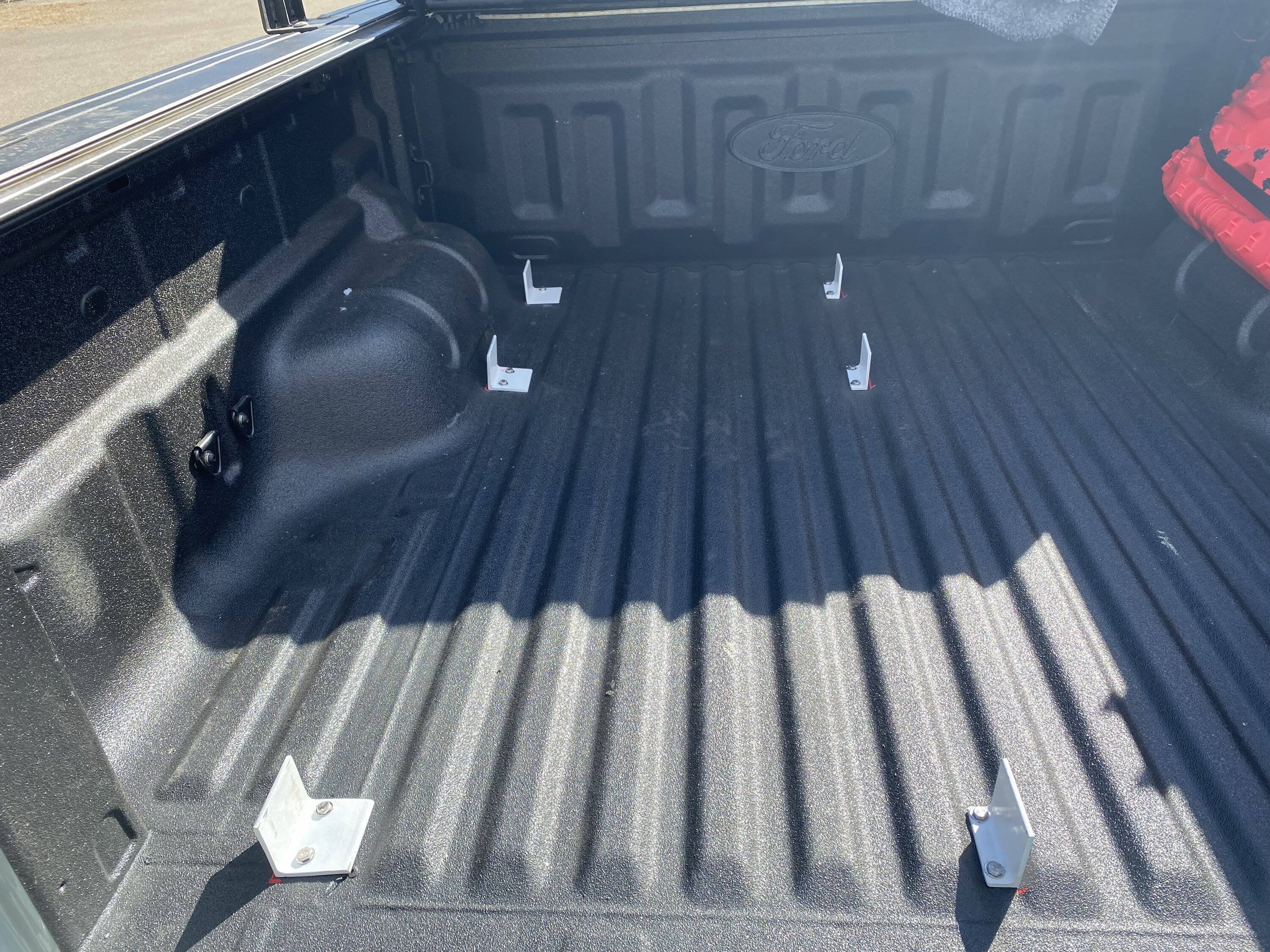

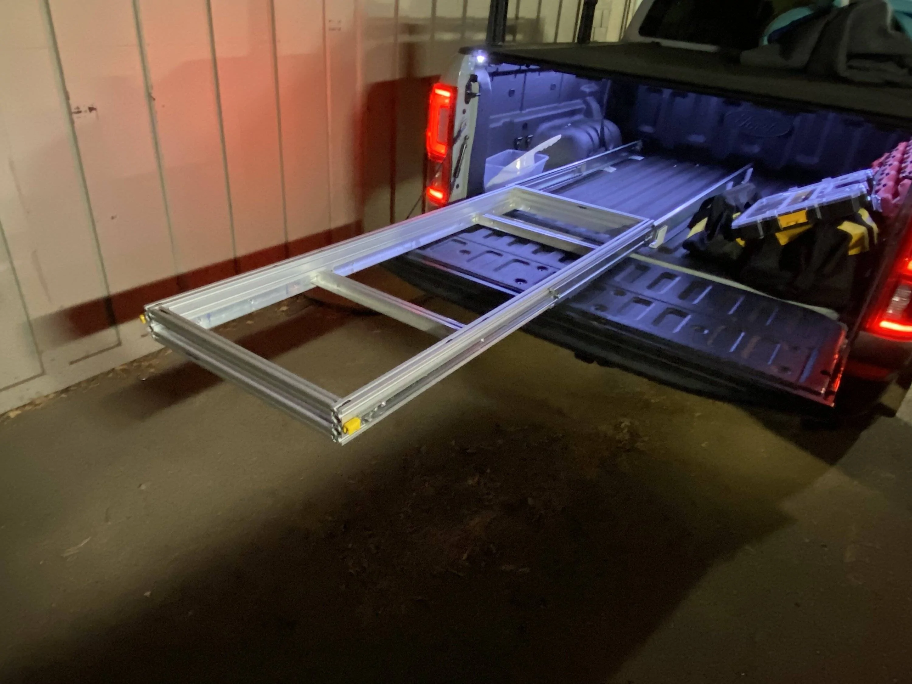

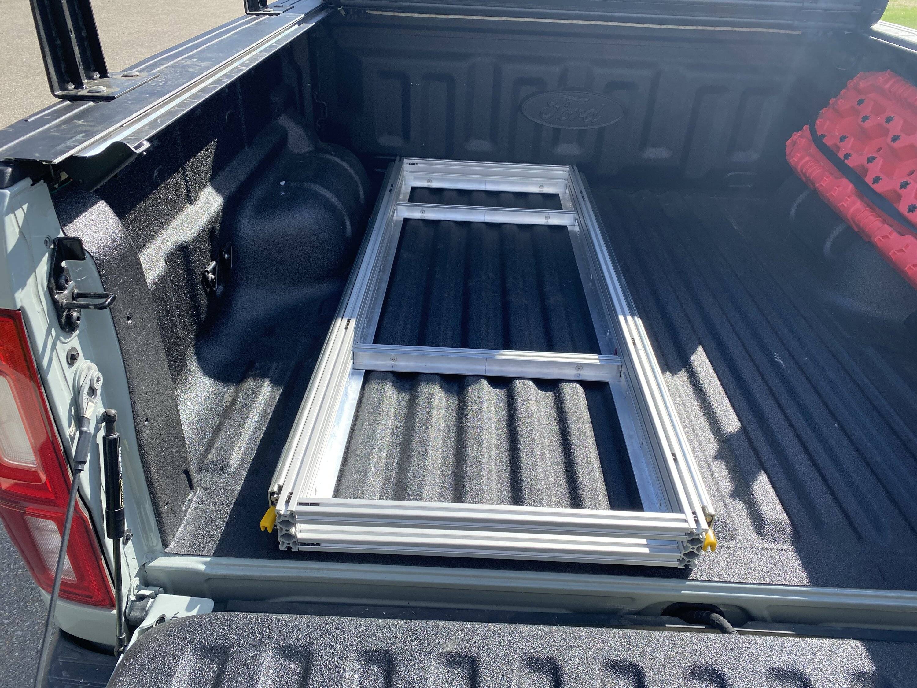

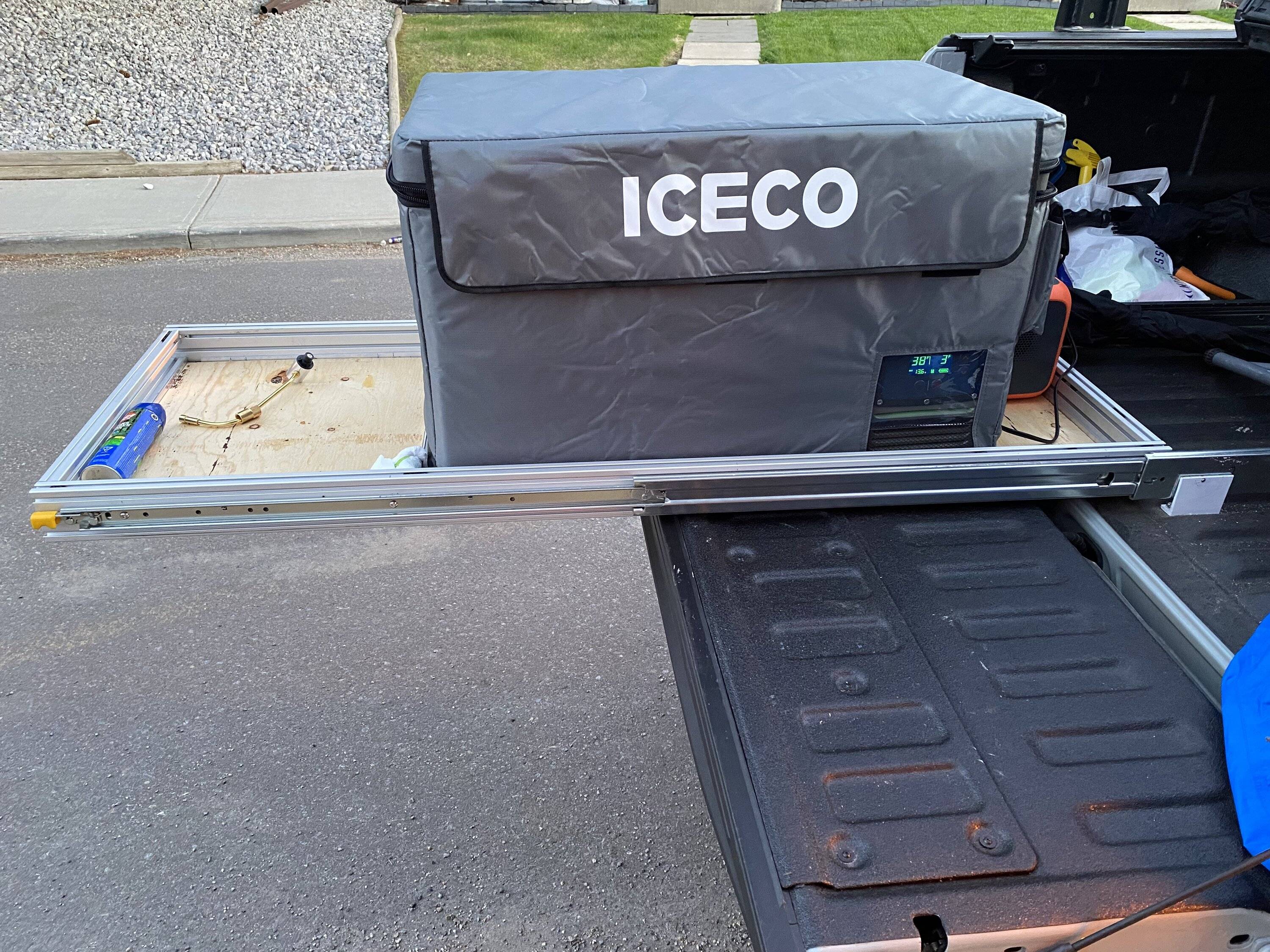

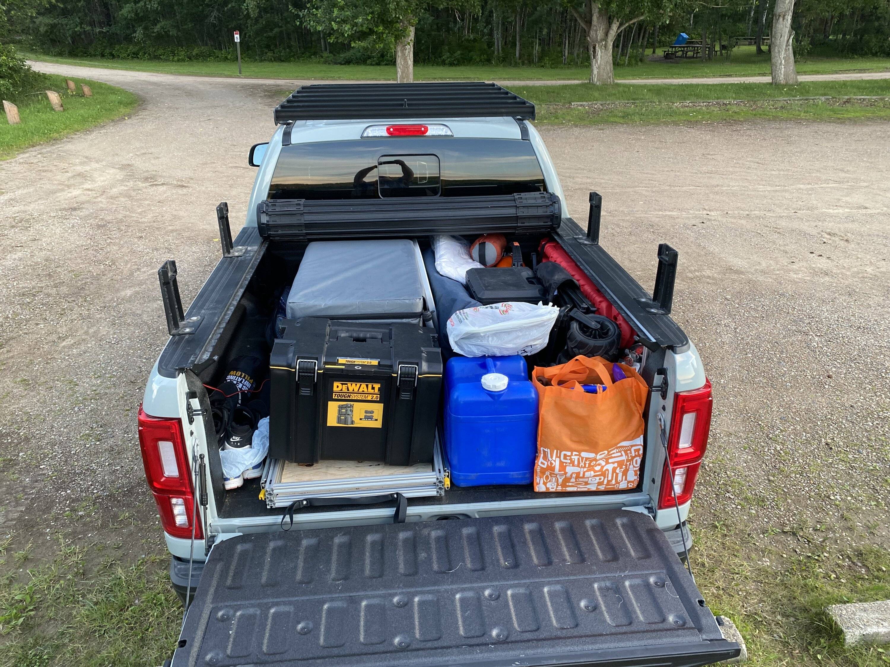

I have the Iceco VL60. I built a slide 1/2 the width and full depth. In order for it to work, it could be no more than 1/2 above the bed of the truck. I got full extension slides that lock closed, 1/2 extended, fully extended. Measured so the feet for the slide would be in the troughs of the truck bed. Then ordered the extruded aluminum pieces and hardware. I have the Bak Revolver X4S cover.
The fridge just clears with the insulating cover on. I want to have the cover modified so I can just zip-off the top and leave the sides in place for dent/stretch protection.
I keep the Bluetti solar generator at the front, there is also enough space for a propane bottle there. The space closer to the tailgate usually holds the camp kitchen tote. I’m down the camp kitchen rabbit hole now. The Dewalt box held everything. It was just an inch too wide. But it was too heavy for the girlfriend.
Here are some pics that may help or even inspire your project.

Okay, this is just sexy. Seriously awesome work. A full-length slide out shelf is probably exactly what I need as that solves a few other things I've been working through in my head. Nicely done!
