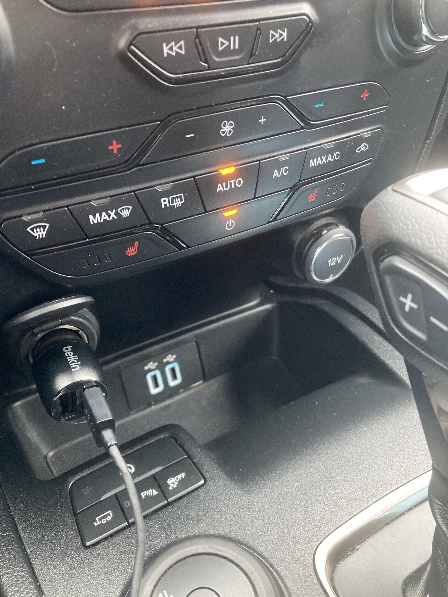

The 12V plug in on the right side stopped working..
I bought a phone charger and had it plugged in on the right, and it worked fine for a couple of Weeks, but I noticed today that it wasn’t working. I can take the same charger and put it in the left and it comes on immediately.
any ideas on what it could be, or what I can check?

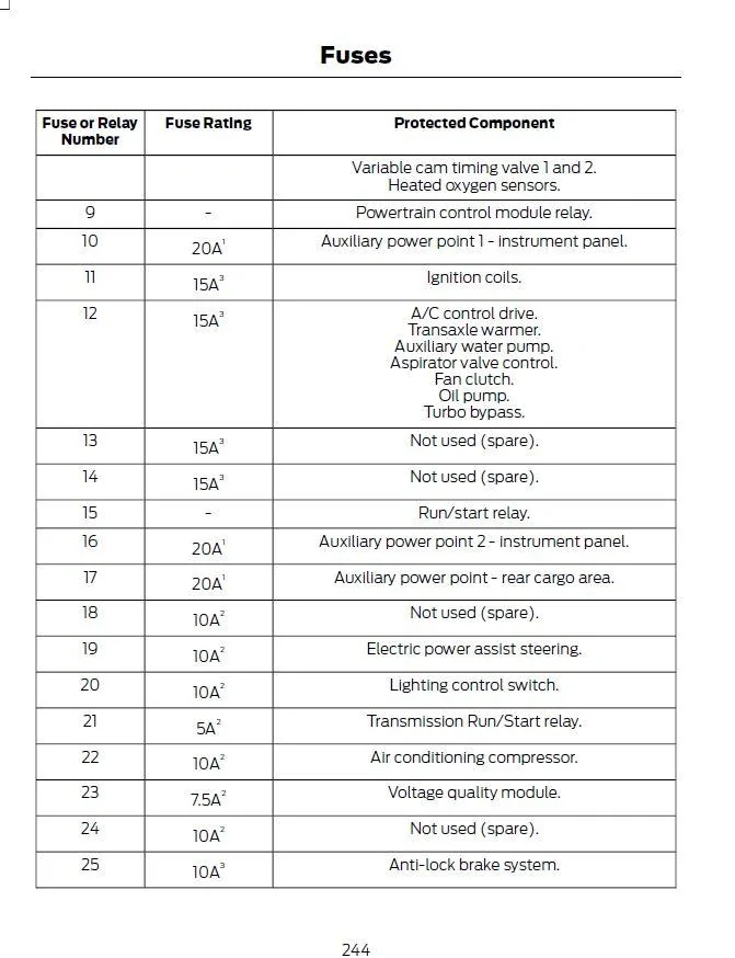

Check Fuse 10 and 16
