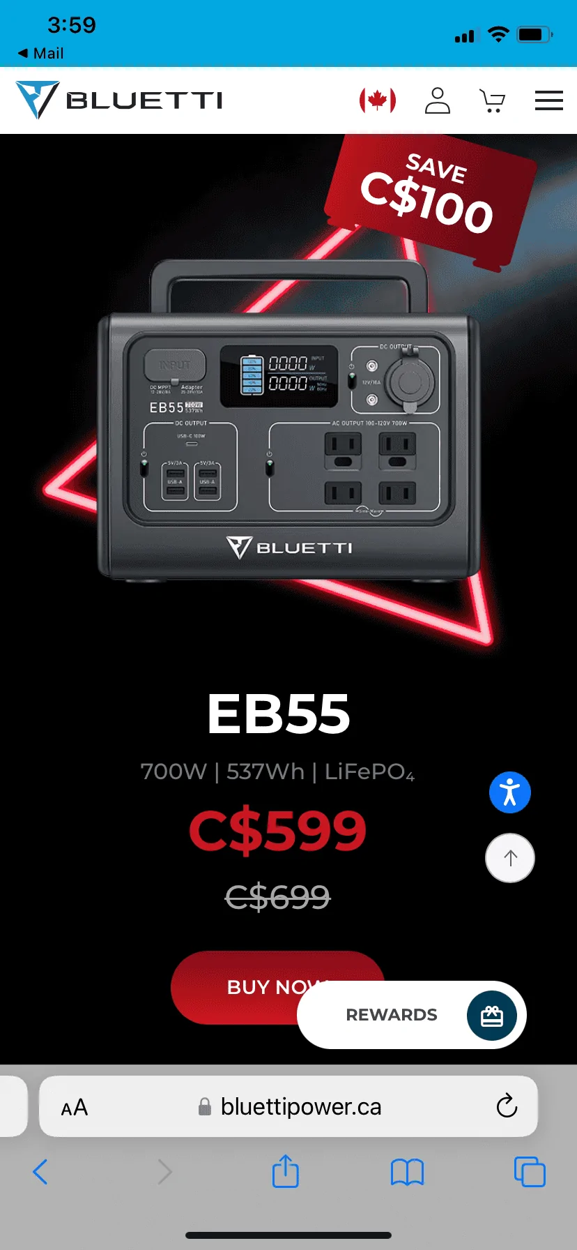

Had a bit of a setback this week. I really like the Iceco fridge. The issue is with the battery/solar generator I had purchased earlier.
I noticed the Bluetti AC50S was only lasting a day, and would be dead after arriving home from a day at the lake. The odd thing about this is that the Bluetti is plugged into a 12volt outlet in the bed of the truck. I have come to find that the Bluetti is no longer charging when connected to 12volt.
No problem, it’s only 8-9 months old. I reached out to the seller through Amazon. After some troubleshooting, they determine there is an issue and they offered me a 30% refund. I declined, stating the unit has a 24 month warranty and is only 9 months old. They then inform me the unit is discontinued and parts are no longer available. I asked for a full refund, with the full intention of purchasing a replacement, and possibly upgrading. I just got the email approving that.
So, back to the drawing board. I liked the price vs capacity of the AC50S @ 500wh. The next step is the EB55 @ 537wh. The price jumps by $250. While a couple AC outputs would be nice, I really don’t need all the USBs and wireless charging.

Glad to see they refunded your money but I think Bluetti would've took care of you if they hadn't. I have the EB55 and while there's way more outlet than I'll ever need the longer run time is great. I had it connected to my Setpower RV45 in the truck all day with temps in the mid 90's while in Moab and it only used 40%.
I got mine on Amazon when they had a $100 off coupon which they have every once in a while so you can keep eye it on their website. Also, if you can hold out a couple months you might find a really good deal on Black Friday.

I think that’s the one I will keep an eye on. The price really went up - $639CAD. I am okay waiting for Black Friday or Boxing Day.
