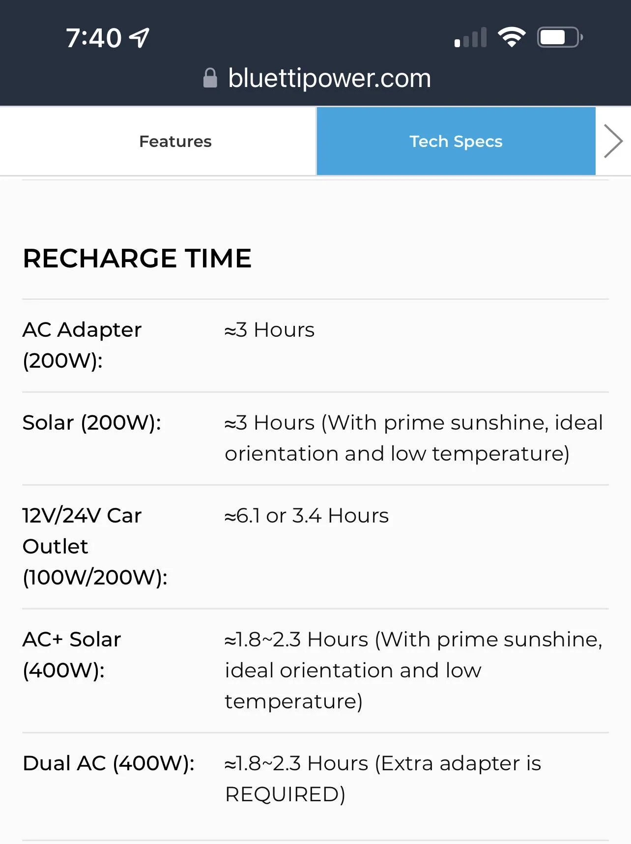

File this under “DUH” but somehow I could not find the recharging time of the EB55 when I looked before, but now I’ve found it.

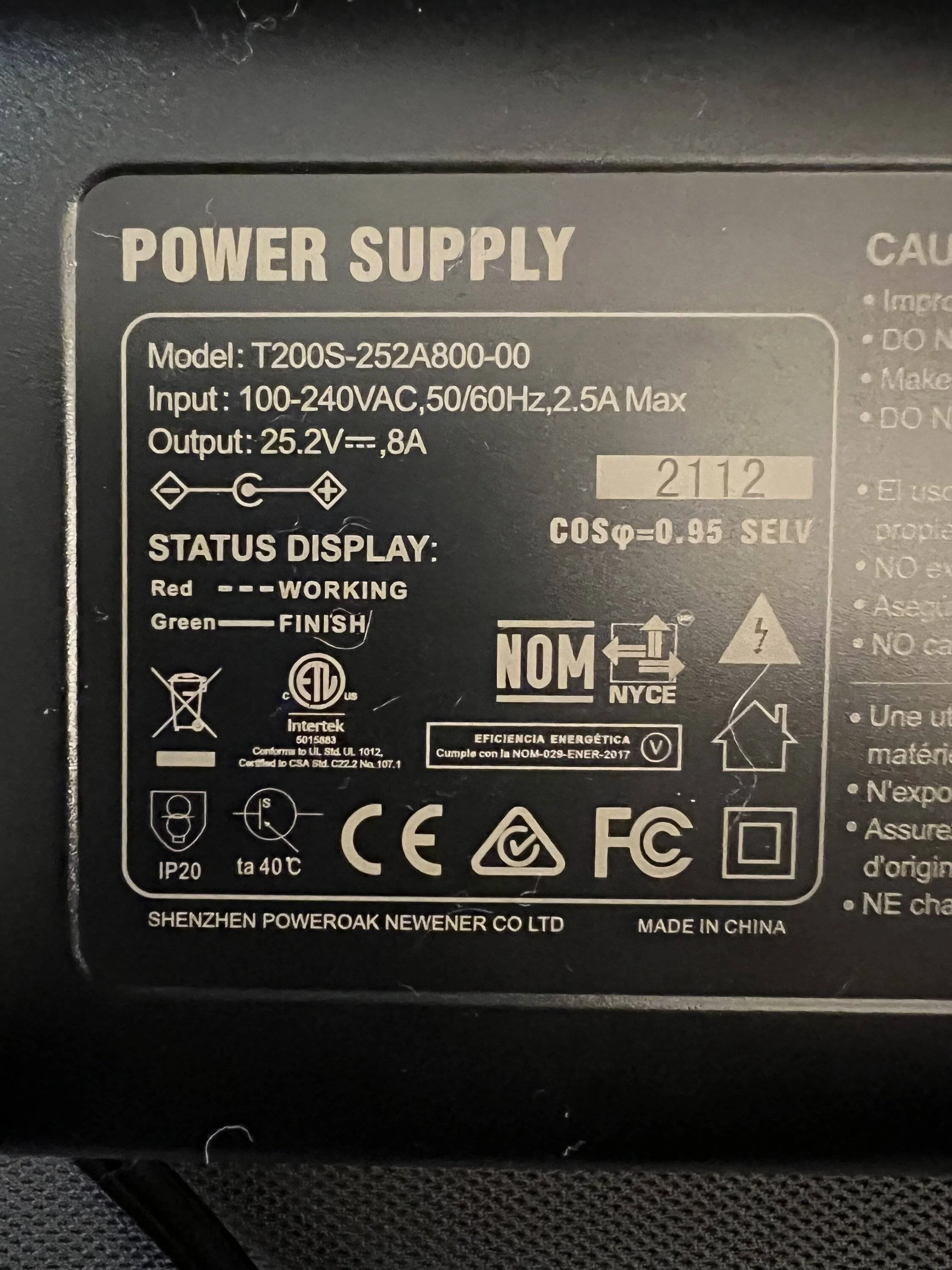

Confirms my suspicions - just over 6 hours to recharge on 12V. I read on another thread that the 110 Outlet in the Ranger is limited to 150W, and the A/C charger appears to be 200W. The brick itself says that the input is 2.5A. That makes me think that it might work just fine off of the 110 outlet without risking blowing a fuse if the adapter adjusts for the lower wattage, but it would probably take 25% longer or close to 4 hours to recharge using the 110 AC adapter.
