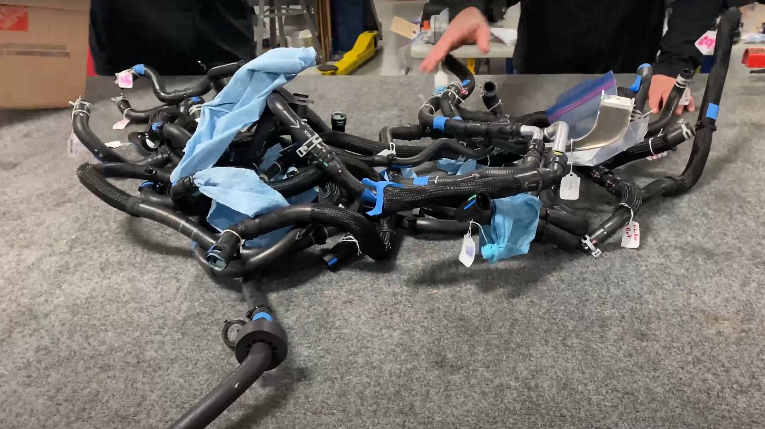

And battery cooling, and battery coolant pump(s), and a battery coolant valve(s), and a coolant temp sensor...
Mustang Mach-E battery cooling system:
