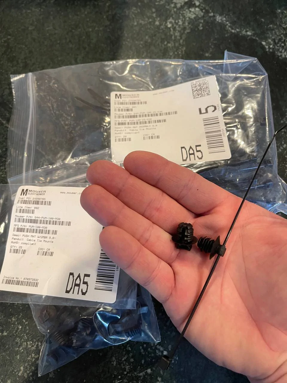

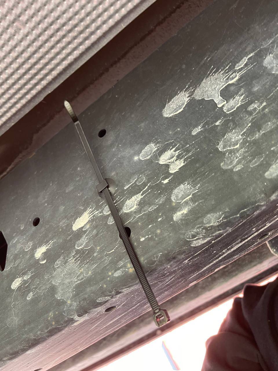

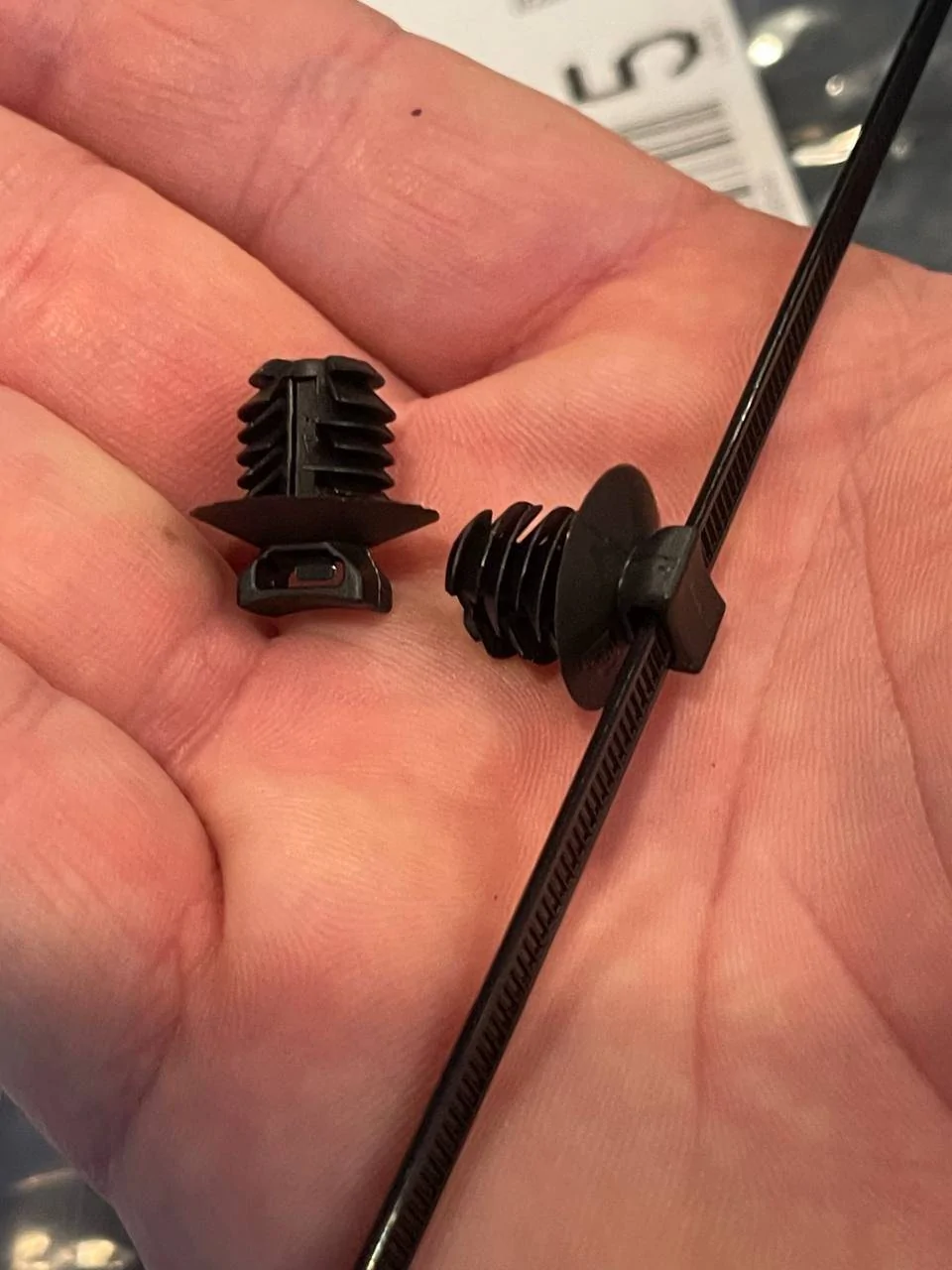

if you were like me, and wanted to run some wiring along the frame, but can't find the correct "firr tree push mounts" for the holes (5/16, ~10mm) because they all are for 1/4 inch holes (at least when you search on amazon, etc). I've found the solution!

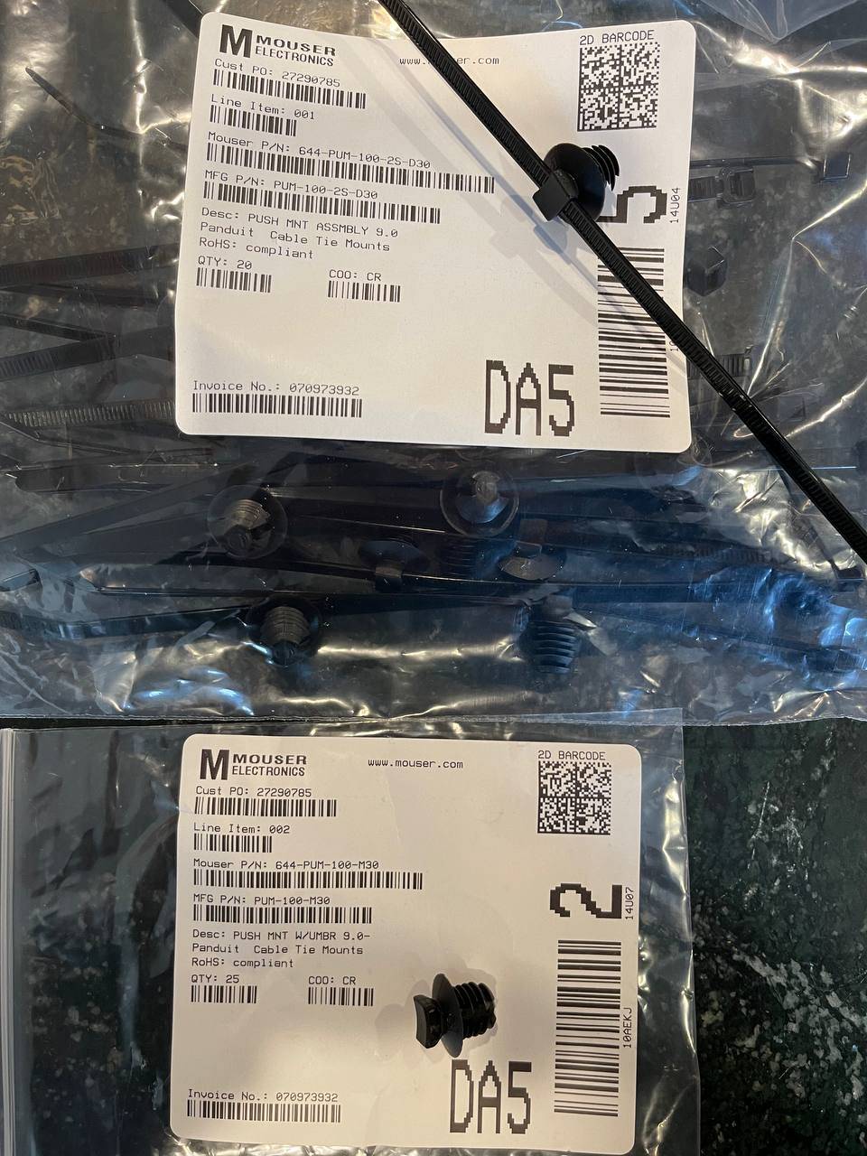

Panduit has a good selection, and you can buy them individually from Mouser. These are the only ones I've found that don't need to be bulk ordered (500 qty) and that actually fit! There's a short video clip of me trying to remove one...
https://www.mouser.com/ProductDetail/644-PUM-100-M30
https://www.mouser.com/ProductDetail/644-PUM-100-2S-D30 You can get them with or without the corresponding zip tie.
Panduit is one of the manufacturers for a ton of wiring harness mounts and stuff anyway, but finding these wasn't terribly easy because so many don't list the hole diameter...

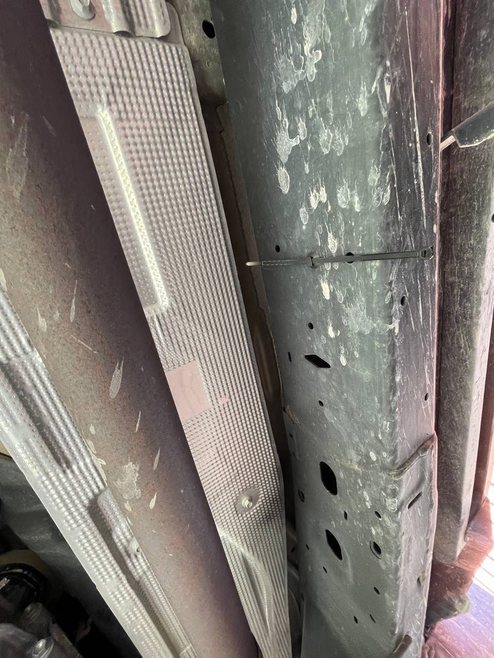

I was going to try that, and may still in the future, but my only two issues were: If the wires are laying on the frame bottom, that's a a chance for water too pool/not drain/sit there causing eventual damage (long long term mostly, but just my thoughts on it) and there are some routes i found through the frame that are very tricky (straight up pita) to get through. Using fiberglass push rods to find a good path had some hang-ups. I'll try again when i get some of the more flexible fish tape.
