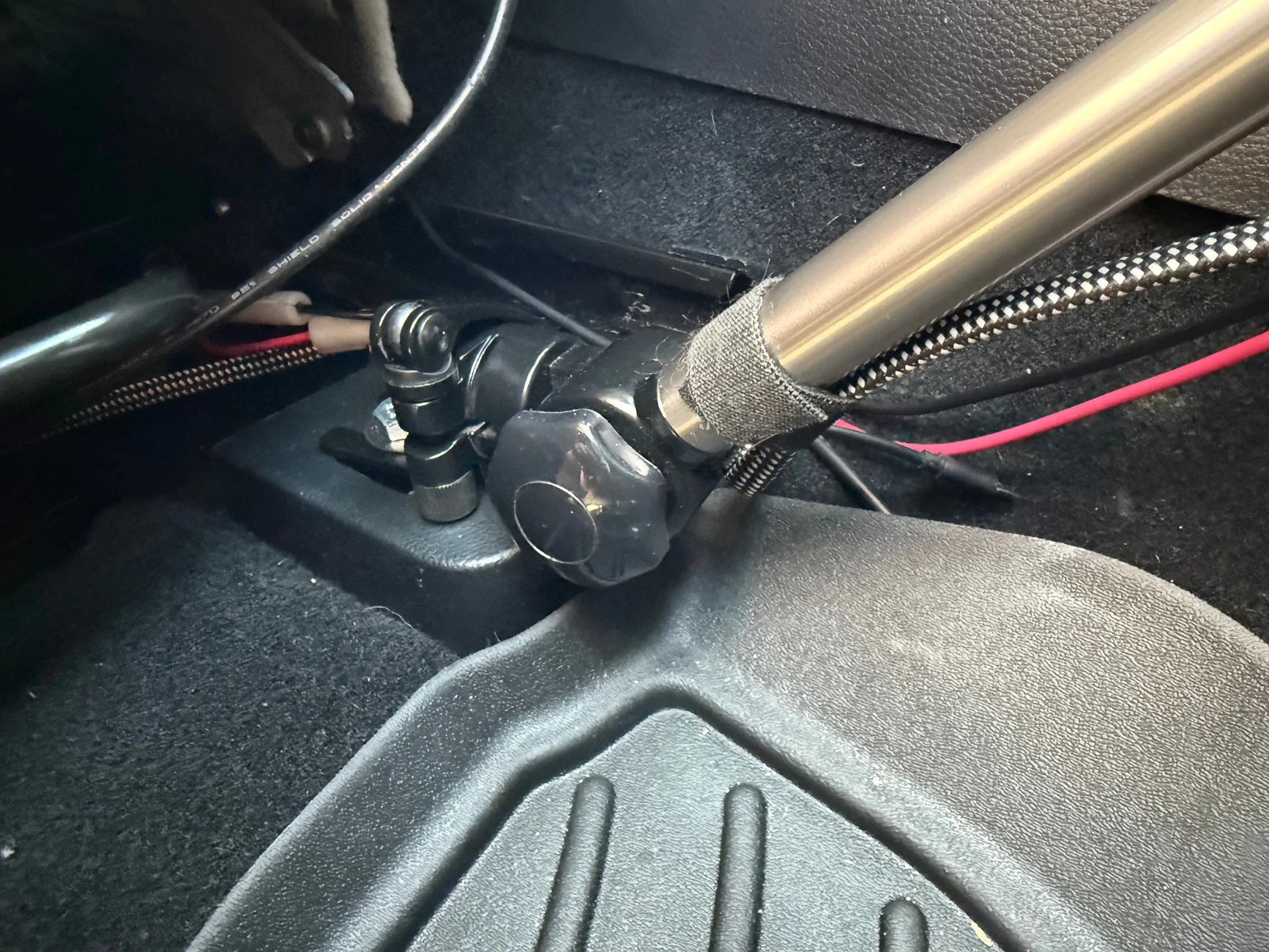

I believe I figured it out. The L-Max mount normally comes with a spacer and long bolt for this purpose, however my package is missing the washers and extra long bolt. I'll head to the hardware store in the next day or so and post photos of how I got it installed.

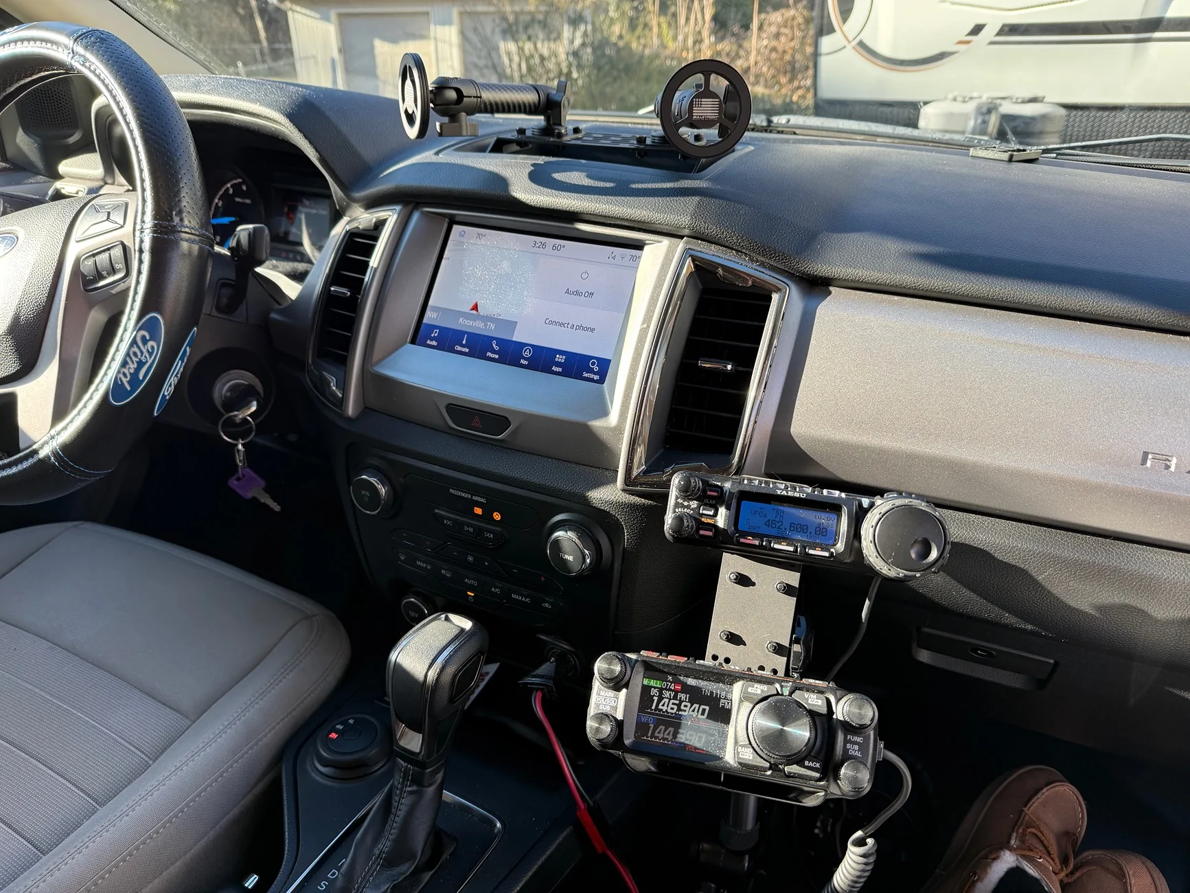

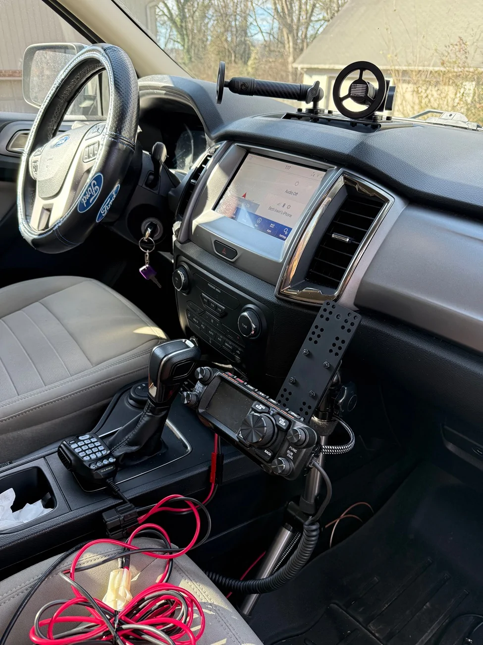

The kit was indeed missing the 60mm bolt that goes through the center of a spacer. Got everything installed. Here’s the setup. I’m usually the passenger so there’s time to play radio on long drives.
