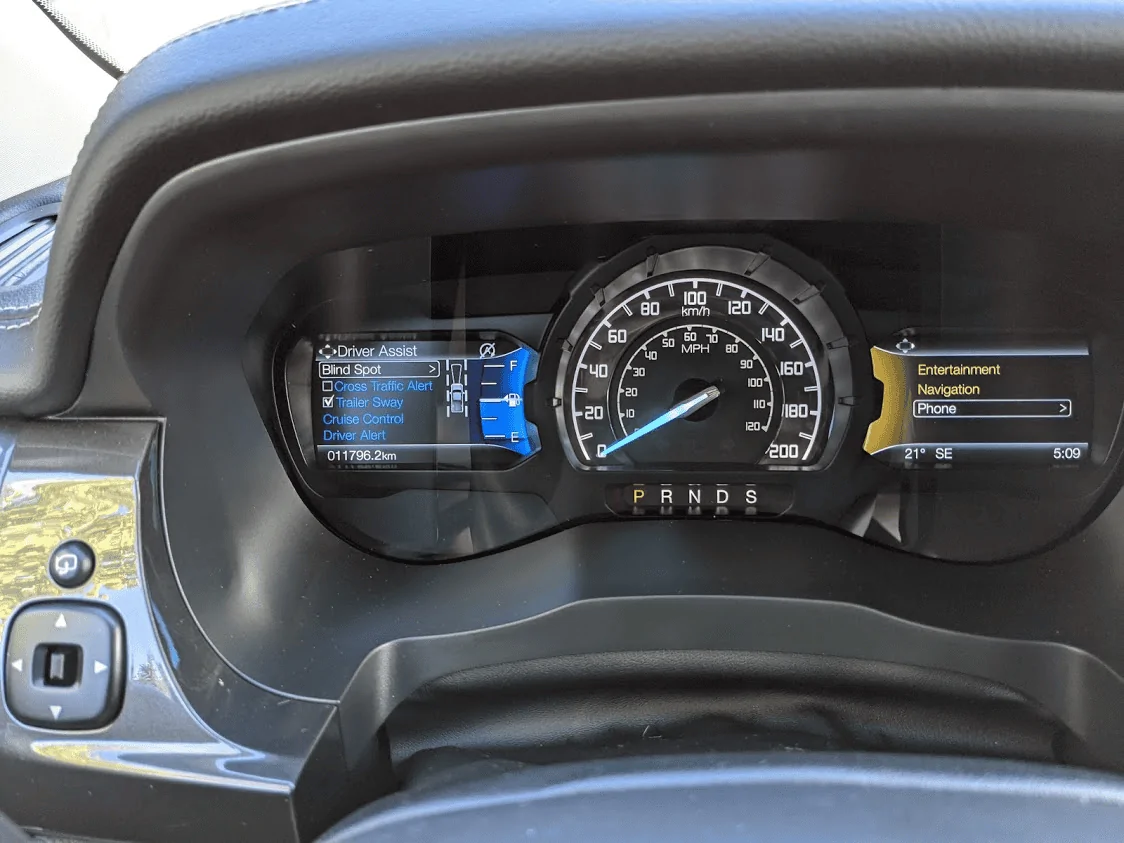

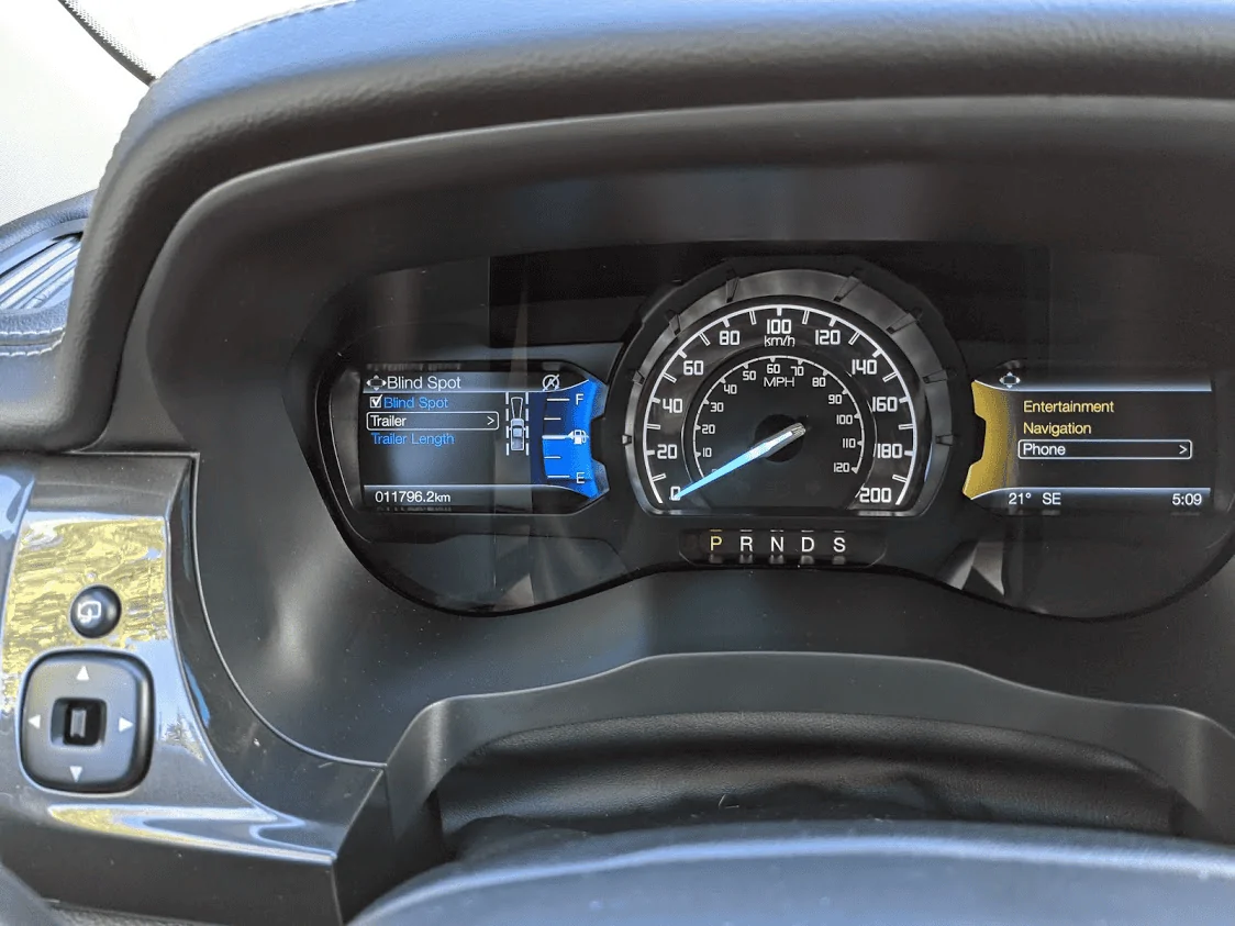

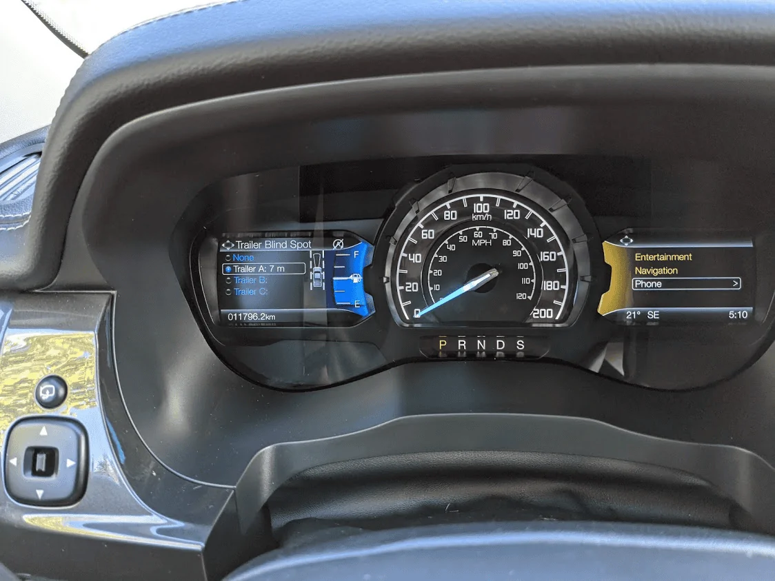

Tested adaptive cruise with the Curt Echo and happy to report that when the vehicle in front of me slowed down to stop, causing my Ranger to automatically brake, the Echo activated the trailer brakes as well. Automatic emergency braking should therefore work, too.
Sidenote - I love how the Ranger pre-charged the brake pedal during this test. I wasn't comfortable relying on just adaptive cruise to stop the vehicle so I was hovering the brake pedal, ready to take over. I took over once I saw that the Echo was braking as it should, and it was really nice to have the brake pedal become more sensitive, requiring significantly less distance an pressure to complete the stop.
So can you confirm the BLIS system that can extend the blind spot detection the length of your trailer works with the Curt Echo? That is the towing safety feature I was concerned with, not just pressing the tow mode button. I already have the Redarc Tow Pro Elite installed and love it but would like to know if they updated anything so it can work with BLIS.
Yes this feature works beautifully for me with the Echo. All it requires is that a trailer be detected on the plug and then it switches to one of the trailer profiles on the dash. I'm not sure how the echo could really interfere with it, other than the case where you plug in the Echo an never plug in a trailer, in which case the truck will not detect a trailer or turn on any trailering features.

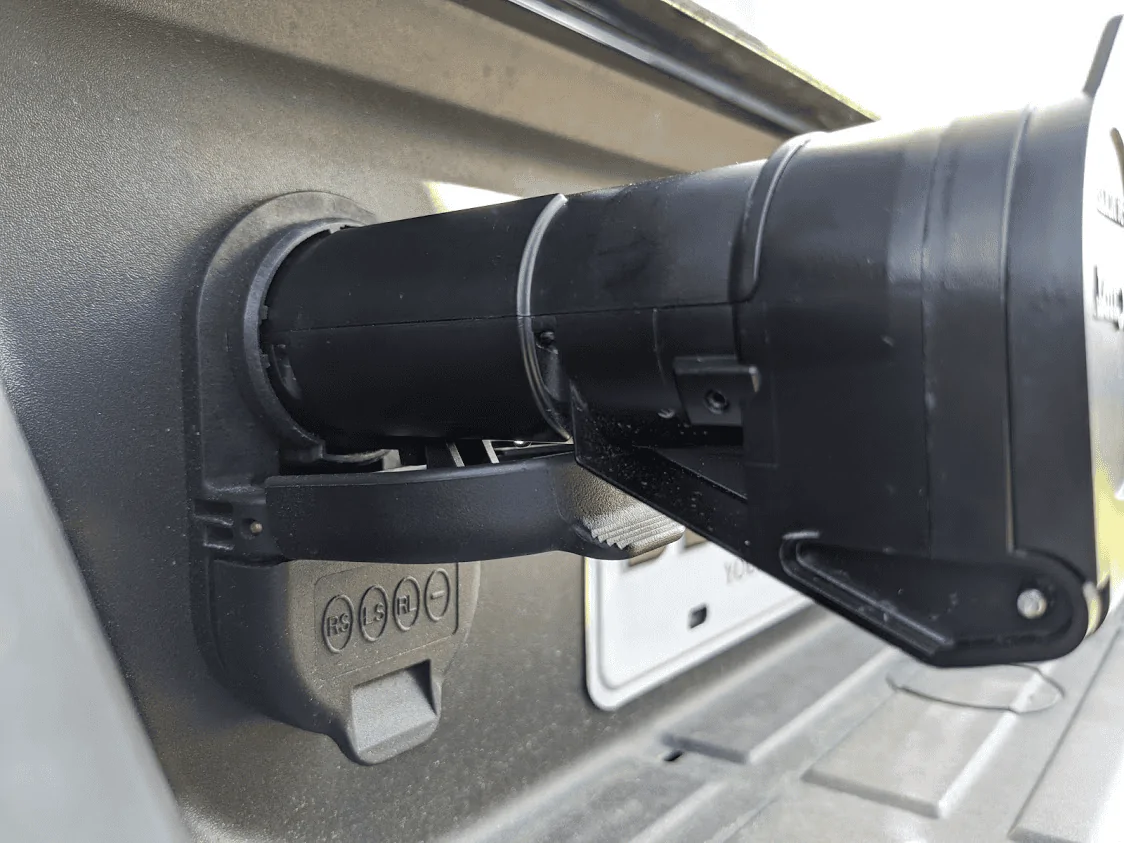

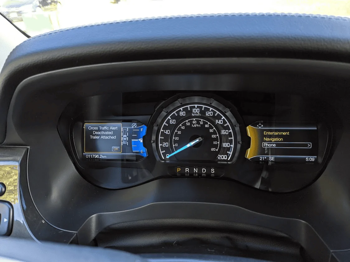

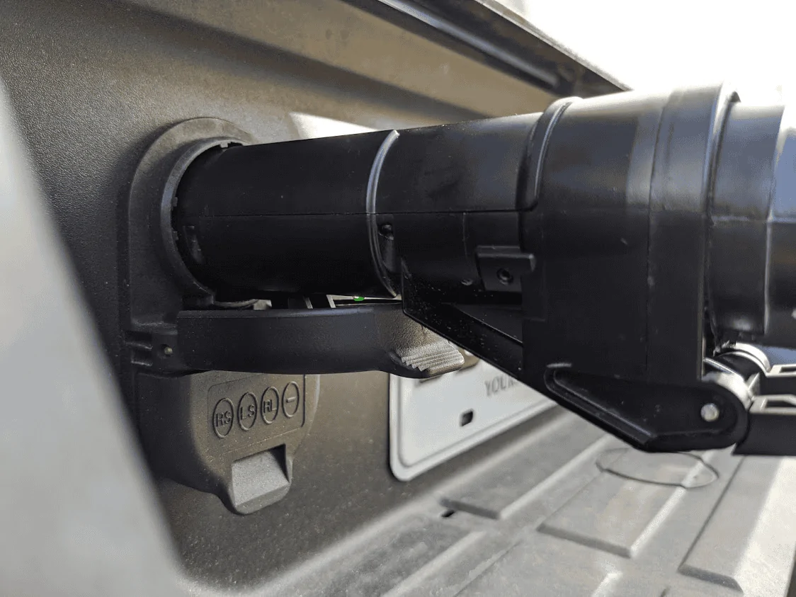

Just to confirm some things about the Echo in regards to some of the pairing/bluetooth issues that some people seem to have.. you absolutely do need a trailer plugged into the Echo in order for the truck to power the Echo.
I went out to my truck just now and plugged in the Echo by itself. Tow mode or not, there was no life on the Echo. As soon as I plugged my trailer into the Echo, everything comes to life and the LED on the echo lights up and the truck shows that a trailer has been connected.
Echo plugged in by itself (LED unlit - LED is on the bottom of the Echo to the right of the latch on the truck's 7-way lid):
Echo plugged in, and then trailed plugged in (LED lit):
Truck dash recognizing the trailer:
FYI my trailer is a 2021 Jayco 174BH travel trailer with LED lights.
