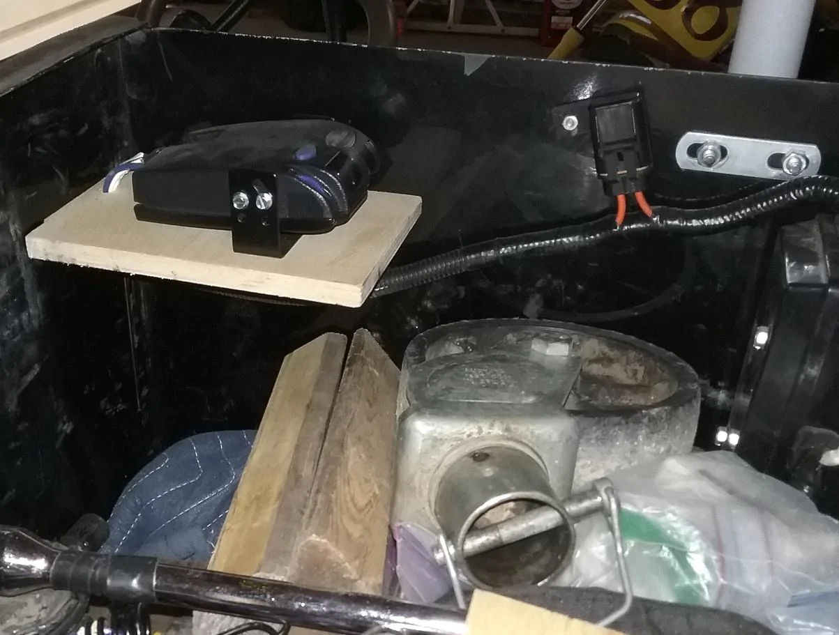

I put the brake controller (Tekonsha 90160 Primus) in the tongue box of the trailer. It's hard-wired into the trailer & uses the trailer's 12v power supply (group 27 AGM battery) for braking. Works very well, but hadn't thought about the trailer brakes & 4-way flashers, hmmm.

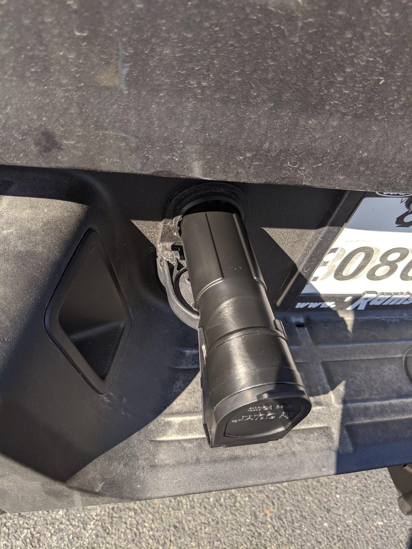

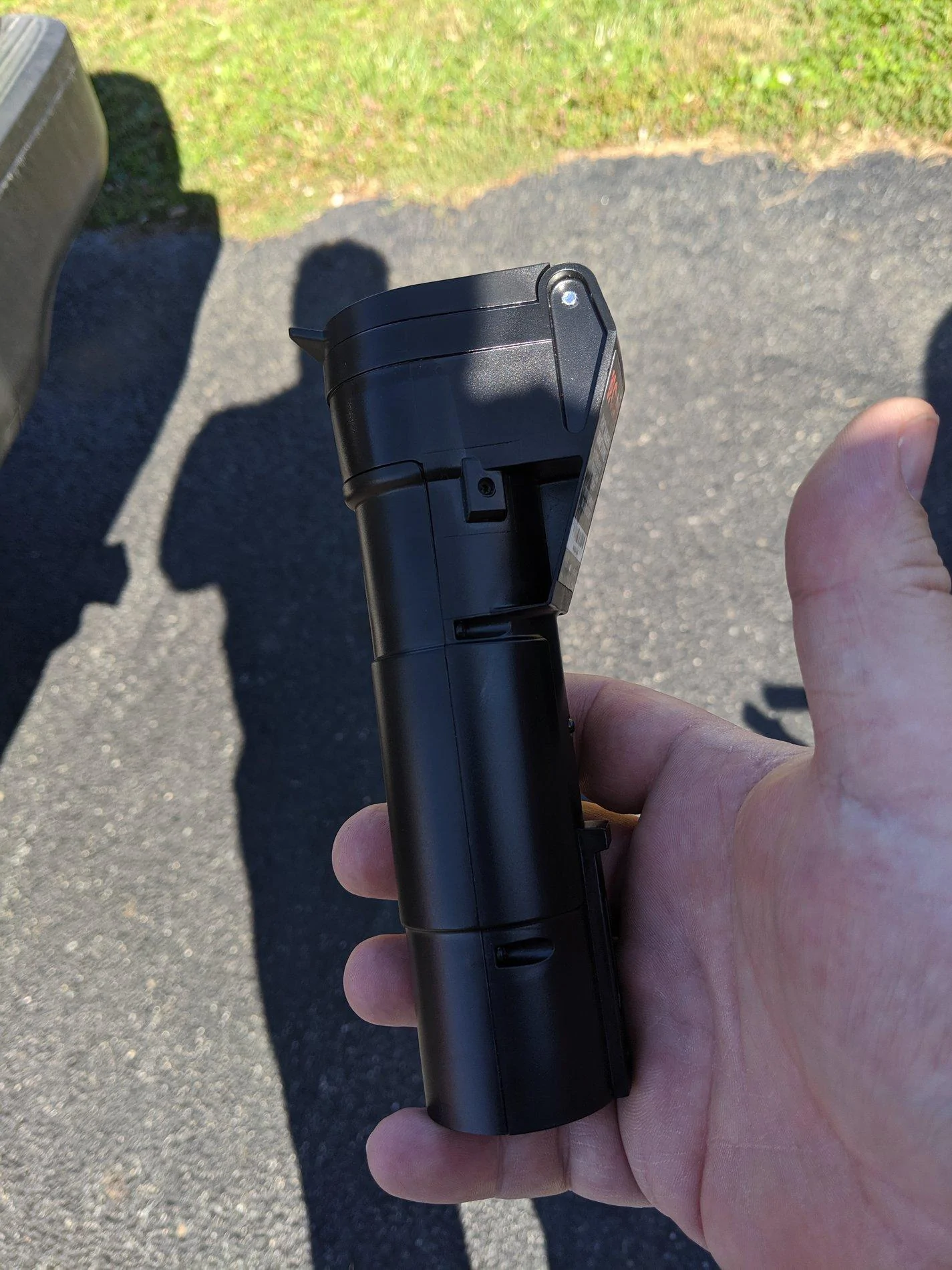

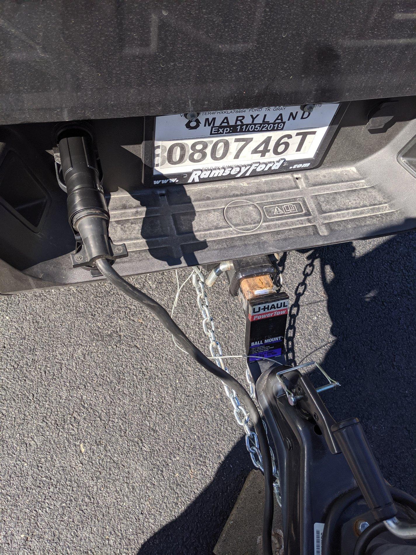

Sorry it has taken a few days to follow up on this post. I received the Curt Brake controller and followed the install instructions to install the app and configure it for use. I tested that it worked with the electric brakes on my trailer. The braking control works as I would expect it to. As a good test I got the rig up to about 30 MPH and then took my foot off the gas of the truck. I hit the button on the app for the manual brake apply and my trailer brakes did just about bring my truck to a stop. During my testing I did come across a problem. The left turn signal and left brake light do not work. When I put the left turn signal on the indicator light in the dash blinks fast just like when a turn signal bulb is dead. I called Curt tech support and they have sent me another one out. I just got to test it this evening and the same thing is occurring. I called and am waiting on a call back in the morning from the tech that first fielded the call. The folks at Curt have been nice on the phone and do seem to want to work to make sure their device works. Someone up the chain had said that when you put the hazards on it triggered the brake controller. That may have been the case previously but the app now has a toggle to remedy that if it happens on your vehicle.
I needed this brake controller to go on a camping trip to a site about 50 miles from my house. There really are only a couple of turns to get to the site but lots of hills and stops so I used the controller for the trip. Brakes or a turn signal??? I chose brakes because I could put my arm out for a turn signal if need be. As far as brakes go the controller worked fine with my trailer. If Curt can figure out the turn signal issue I will keep the controller instead of messing with wires and such. It is very convenient to just plug it in and go.
My Falcon trailer is just about 4000LBS when fully loaded and the Ranger did not have any issues towing it what so ever. I was able to accelerate and stop without issues. I averaged 14 MPG towing over the 103 miles of my trip.
