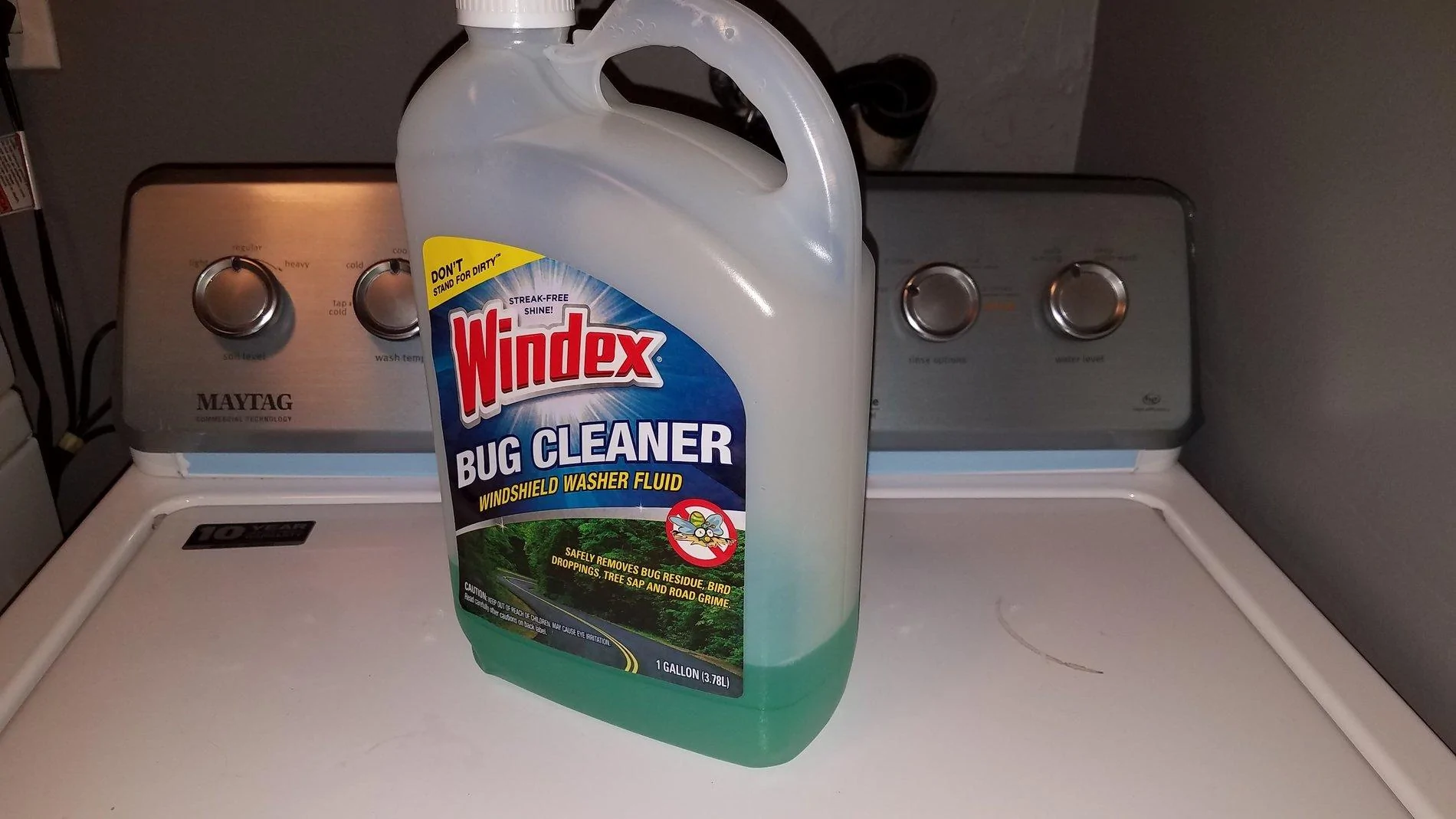

350 miles on the new truck. To my surprise the fluid light came on. Picked up a bottle thinking I'd top it off. I started pouring it in. And pouring it in. And pouring it in. What the heck there's a hole in my reservoir! Nope. Apparently she was just really thirsty after the long drive from Michigan.
