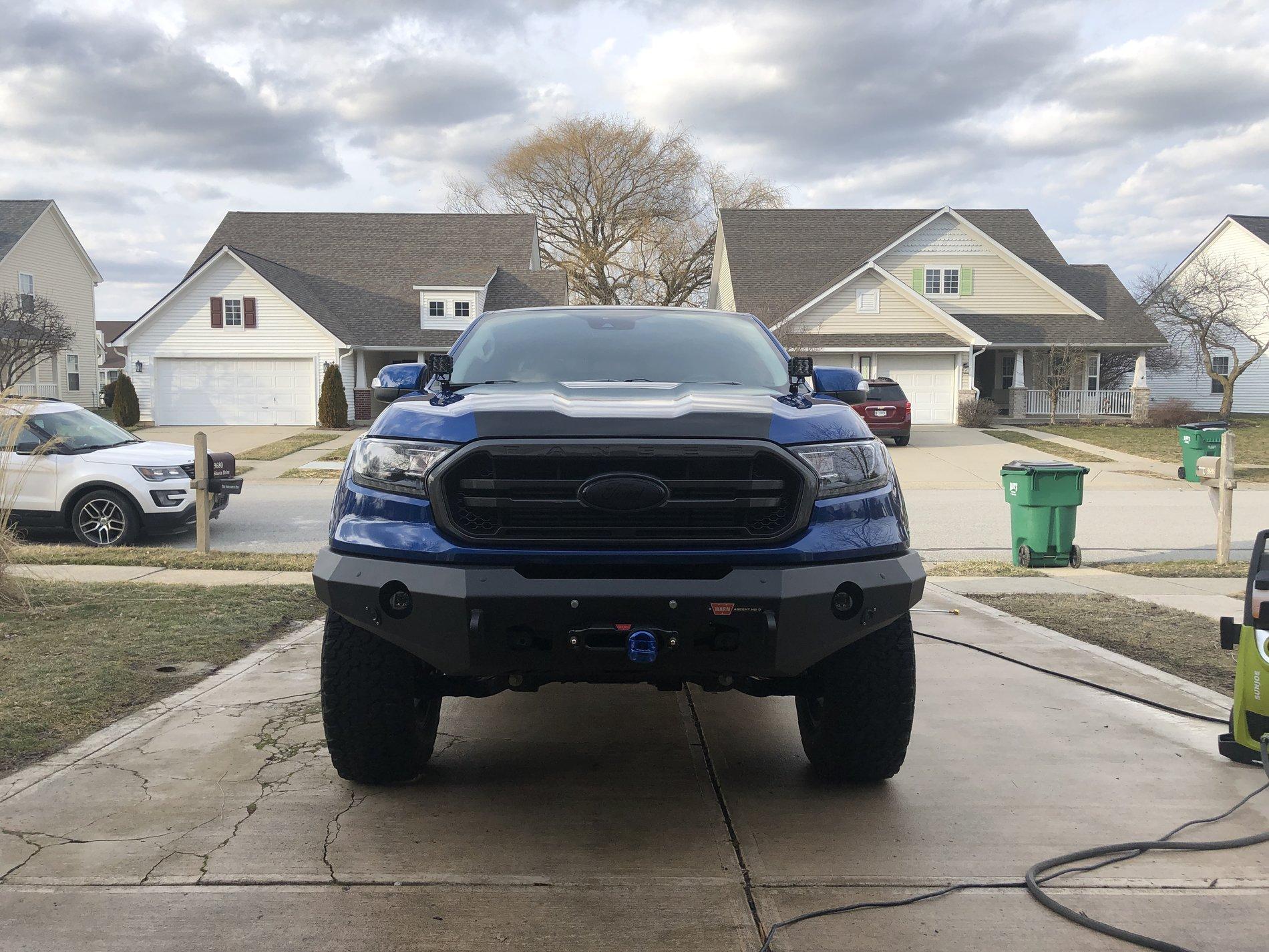

Warn ascent with Warn VR evo 12k. Let me point out that I also like the tucked look of ADD and the like, but that leaves you with little to no access to the clutch knob and also forces you to relocate the winch’s control box for the remote.

There's no bracket that will work to relocate that. Where would you put it where it will still work without re-engineering the whole thing and calibrate it?
I’m have zero problems with my Fab Fours relocation bracket...
